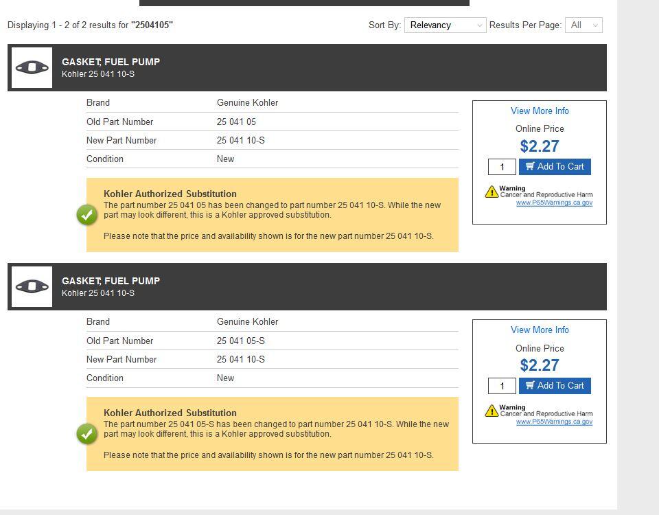

Maxwell-8 4,371 #5 Posted November 20, 2021 Mine is leaking, I would prefer rebuilding it. I need just a new gasket What is the part number for it? Can't find it on the m12 partstlist Share this post Link to post Share on other sites
Maxwell-8 4,371 #7 Posted November 20, 2021 11 minutes ago, pfrederi said: Thanks but that is the gasket were the pump mounts to the engine. I explained it wrong, I am sorry. I meant the membrane. Share this post Link to post Share on other sites
pfrederi 20,196 #8 Posted November 21, 2021 Then and now sells membranes and other parts. https://www.then-now-auto.com/fuel-pumps/ However for about the same money i just go Electric Facet Posiflo 2 1 Share this post Link to post Share on other sites
953 nut 65,048 #9 Posted November 21, 2021 Your Kohler "M" probably has a plastic body and "Then and Now" kits say the valves don't fit well on them. You can buy the diaphragm alone but in the long run you are best off going with a good quality electric fuel pump. 1 1 Share this post Link to post Share on other sites
