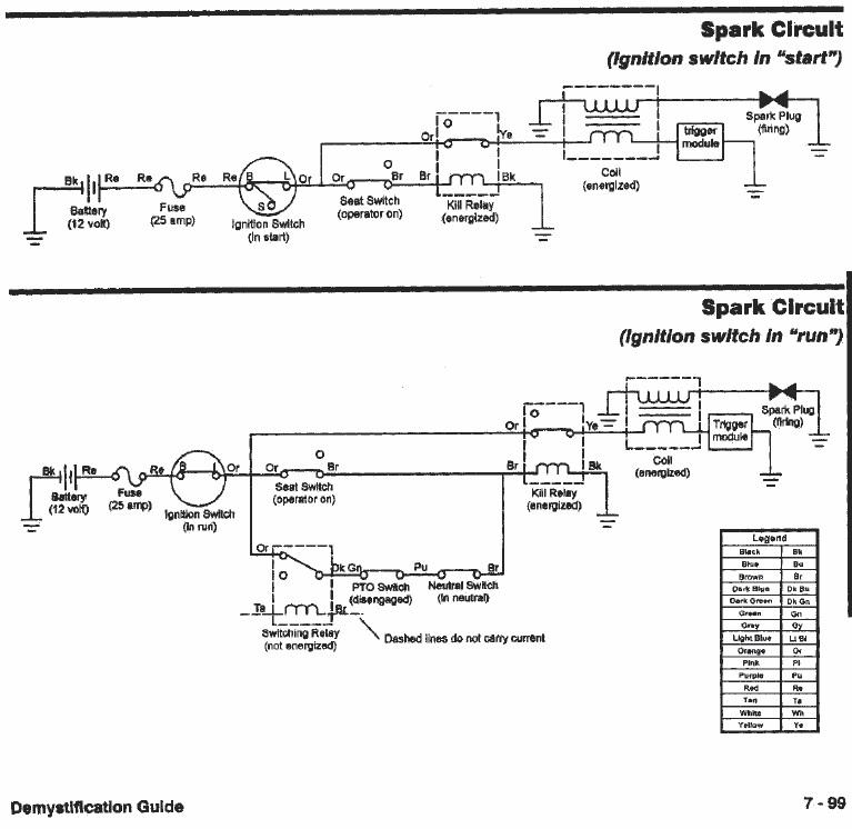

cleat 9,405 #8 Posted June 4, 2018 Here is the wire diagram. Later model 520 wire diagram.pdf If you trace the coil wire back, you will likely find your fault. Cleat Share this post Link to post Share on other sites
bo dawg 643 #9 Posted June 4, 2018 Thanks Cleat for the chart, that's my main question, could it be one of the relays. Cause its hot everywhere else except the coil. Share this post Link to post Share on other sites

lynnmor 9,073 #11 Posted June 4, 2018 24 minutes ago, bo dawg said: Thanks Cleat for the chart, that's my main question, could it be one of the relays. Cause its hot everywhere else except the coil. Look at the kill relay, it might be bad. They can be found at many auto parts stores and don't cost much. You should have a spare anyway. Your system has no points, so that theory mentioned above doesn't apply. To get that backfire, if that is what you are hearing, would take an ignition source. 1 Share this post Link to post Share on other sites
cleat 9,405 #12 Posted June 4, 2018 (edited) Also, don't forget the simple things, Like is the PTO fully disengaged, motion lever firmly in neutral, your butt on the seat. I would also check to be sure you did not inadvertently bump a connector to the PTO safety switches or bump a fuse causing it to lose connection. Wiggle the relays to be sure they are fully seated, you can also swap them around I believe. Cleat Edited June 4, 2018 by cleat 1 Share this post Link to post Share on other sites
