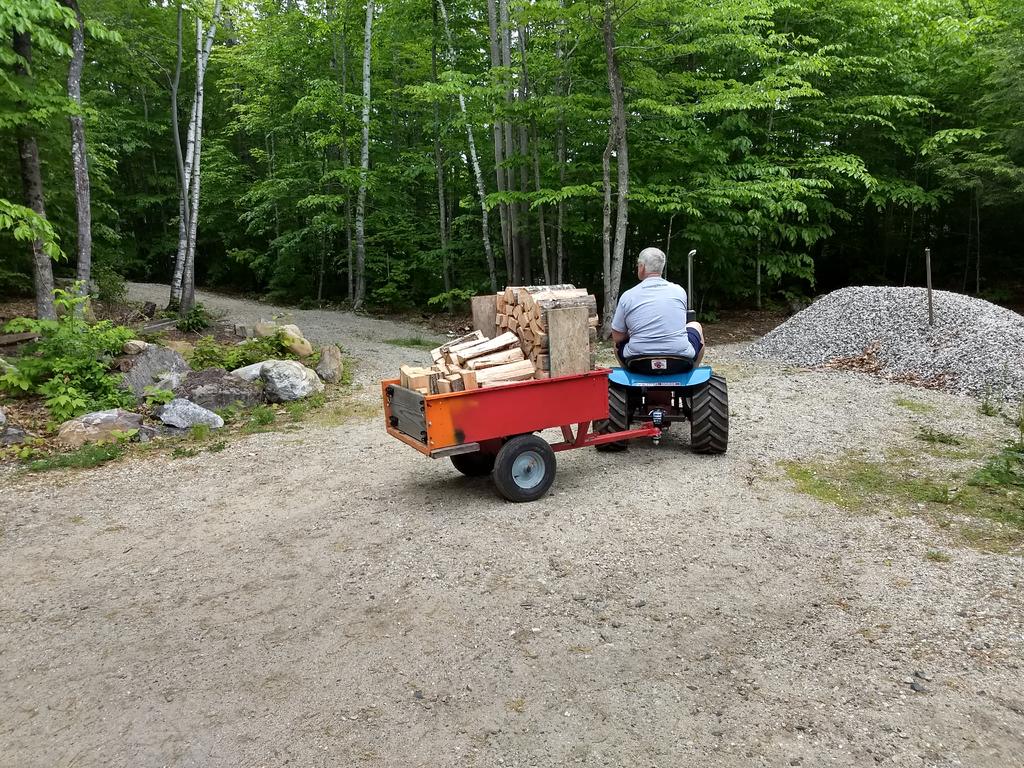

ebinmaine 80,475 #5 Posted June 3, 2018 Just now, dclarke said: That should make it more stable for what you are using it for, nice work Eric! Thanks Den! We moved a couple loads each of wood and stone yesterday. HUGE difference. 2 Share this post Link to post Share on other sites

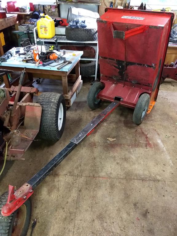

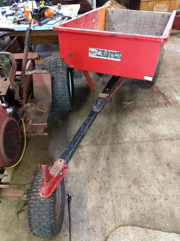

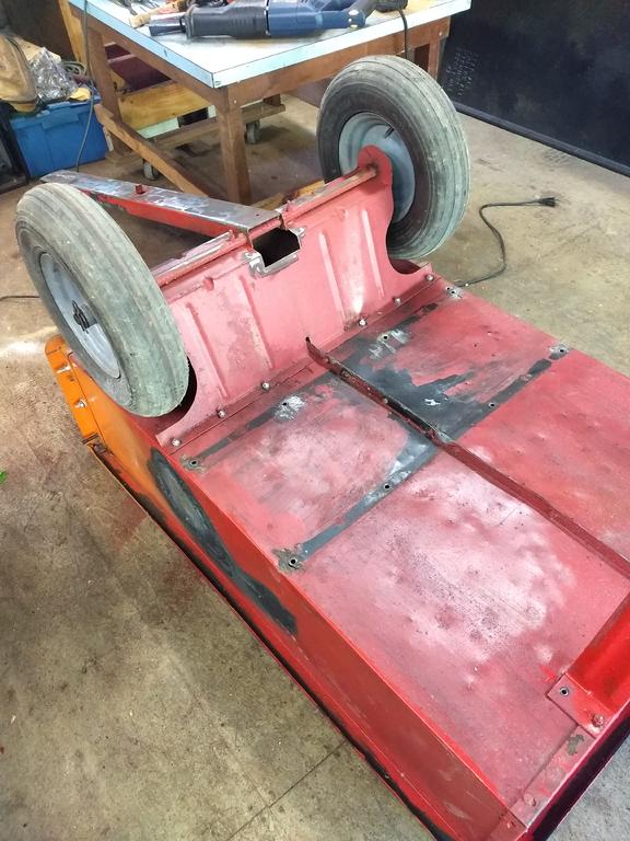

ebinmaine 80,475 #9 Posted June 6, 2018 On 6/3/2018 at 8:34 AM, O2B__ said: I hadn't thought of moving the wheels back. That might be the fix for my Chinese cart that dumps automatically with a heavy load on uneven ground. Good idea. Definitely glad I did this! Here's the next phase of the project, completed. Some point in the next few weeks I will pick up a winch and make it so that it dumps by cable lift power instead of me lift power. I extended the tongue by bolting a piece of thin wall 2in Square stock tubing that is about 25 or 30 inches longer than the existing tongue. I chose that length for three reasons. One is to put a little bit more weight on the trailer where it should be. Another is... based on experience with the log trailer that I built last year, I just happen to like this wheelbase for some reason. It's easier for me to comprehend backing it up. And also, the extra couple feet of square stock tubing between the existing trailer and the coupler will give me plenty of space to work out where I need to mount the winch and vertical support. I guess we're about due for some scraping and painting now. 6 1 Share this post Link to post Share on other sites

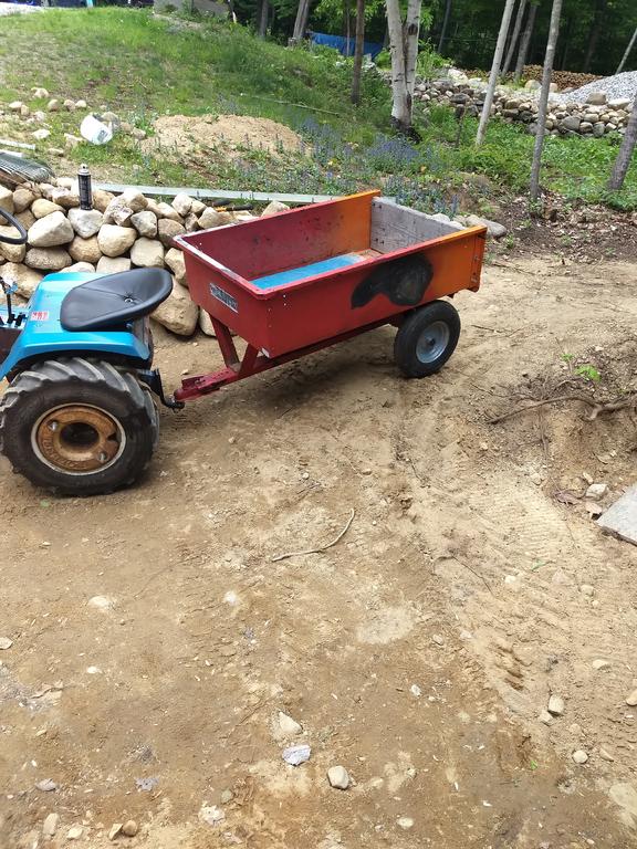

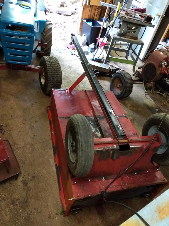

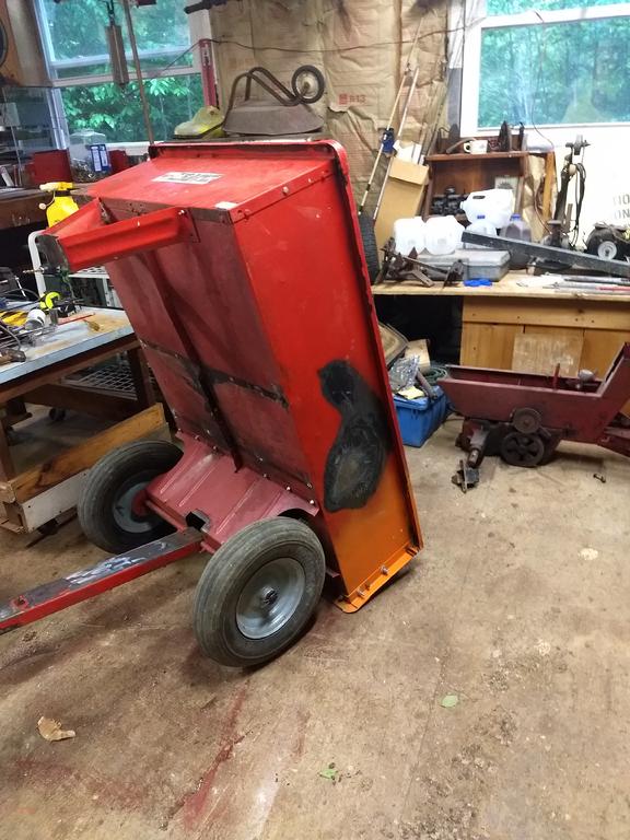

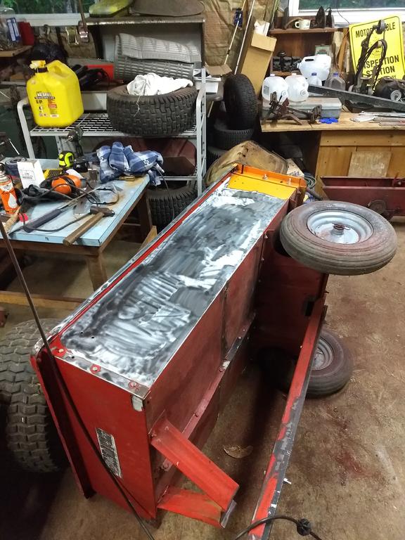

ebinmaine 80,475 #11 Posted June 7, 2018 Couple more pics of the festivities for tonight. The first pic shows the dump height with the new axle location. Stripped the "paint/garbage" off one side. 6 Share this post Link to post Share on other sites
ebinmaine 80,475 #12 Posted June 8, 2018 Finished stripping the other 2 sides and top rails tonight. Pics to follow. Hoping to paint this weekend. Share this post Link to post Share on other sites

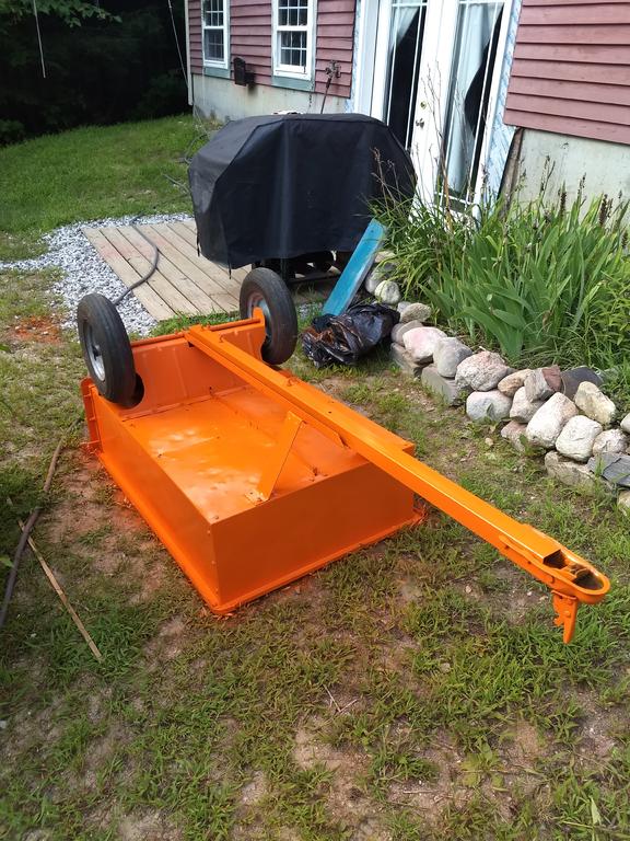

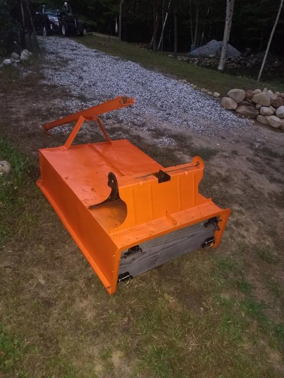

ebinmaine 80,475 #18 Posted July 30, 2018 Well, we finally got back to working on this trailer today. Haven't touched it for nearly two months because of many other things going on. My honey washed it off and put primer and a coat of paint on some parts of it. 3 2 Share this post Link to post Share on other sites

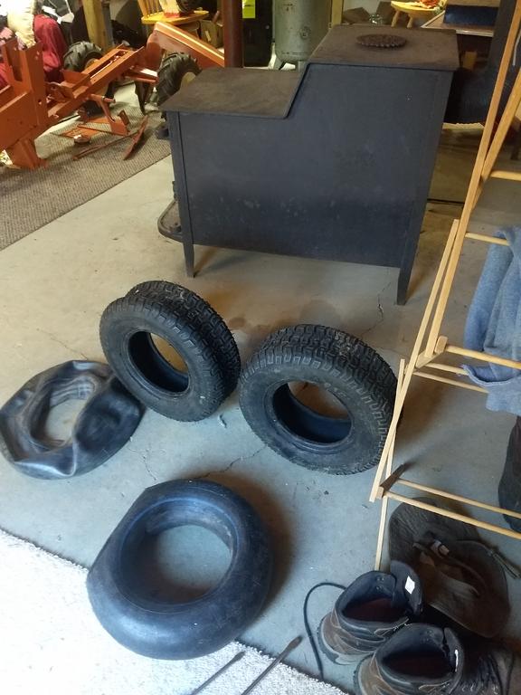

ebinmaine 80,475 #23 Posted October 14, 2018 On 9/16/2018 at 8:35 PM, ebinmaine said: decided to change the wheels and tires... to an 8" wheel set from an old crapsman that were laying around I started to clean those up and scrape the rust off a few days ago and discovered that they were in terrible condition. Those went in the scrap metal pile. So we switched gears a bit and cleaned up a set from a 1974 c160. Here's the tires warming up by the wood stove waiting for installation today. 1 Share this post Link to post Share on other sites

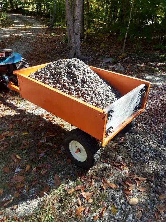

ebinmaine 80,475 #24 Posted October 14, 2018 Loaded up. Next part is to get the vertical stand fabbed up. And winch installed. 1 Share this post Link to post Share on other sites
