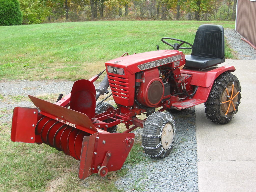

pfrederi 19,792 #2 Posted June 1, 2018 (edited) I put a a 16hp K341 into an electro12. I switched it to a manual PTO only because I do not like electric PTOs running snowblowers. I like to feather the PTO to start it up the electric is a bit violent for my liking. But the electric will fit. My Electro 16 will throw some snow!!! Edited June 1, 2018 by pfrederi 2 1 Share this post Link to post Share on other sites
