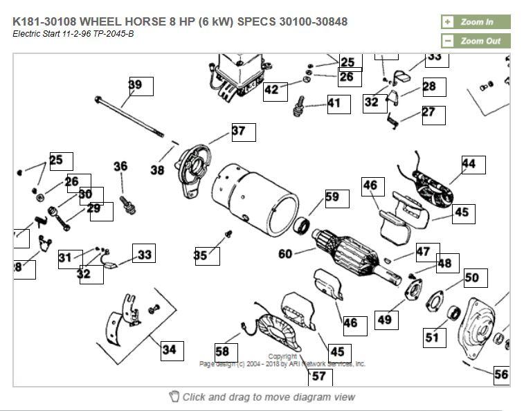

pfrederi 20,997 #3 Posted June 1, 2018 Kohler doesn't support these any more. Both are discontinued. I looked up a K181 from an 856 you should look up your engine spec to make sure. #51 is Part 270311 #59 is 230813 http://www.kohlerenginesparts.com/PartStream/Index#/Kohler_Engine/K181-30108_WHEEL_HORSE_8_HP_(6_kW)_SPECS_30100-30848/Electric_Start_11-2-96_TP-2045-B/4936/CATALOGS|~17405 Share this post Link to post Share on other sites

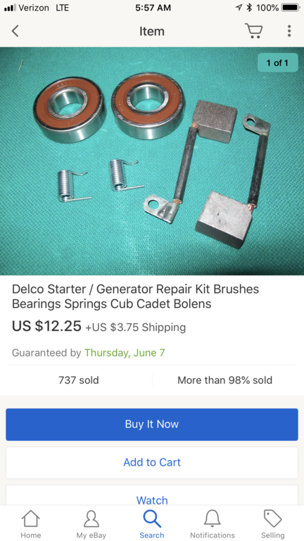

953 nut 68,176 #4 Posted June 1, 2018 I Save Tractors has kits that you may want to look into. While you have it apart you will want to put in brushes and springs anyway. 2 1 Share this post Link to post Share on other sites

Buzz 503 #8 Posted June 9, 2018 Excuse my manners but I forgot to thank everyone for their help. I bought the bearings at NAPA. They were pricier than the kit on ebay but not too bad. I had new brushes from when an electrician from work had rebuilt the one on my 856. Now the bad news. While carrying the generator from the bench to the tractor, I stumbled over the dog and dropped it. Busted the cast iron mounting bracket. I not only exhausted my extensive vocabulary of swear words, I think I invented a few new ones. Checking into getting a copyright on them. Anyhow...... I had one with a bad armature so by swapping some pieces parts around I have a generator on the tractor that seems to work. Thank you. 3 Share this post Link to post Share on other sites
