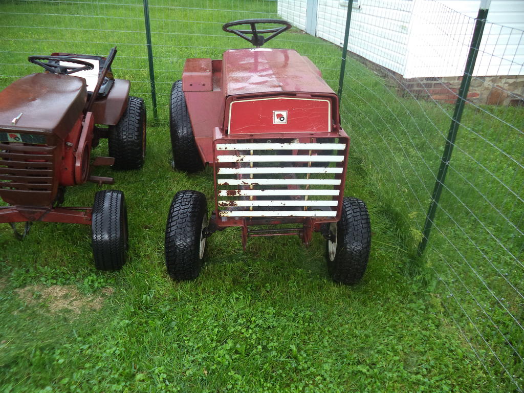

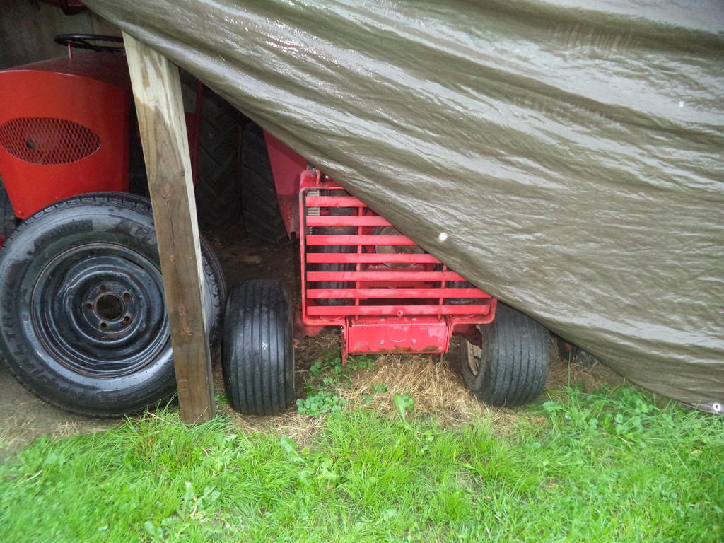

ricksrj58 279 #4 Posted May 31, 2018 i just do not like the big fat golf cart tires on it.my D160 parts tractor has 18x6.50x8 tires on it and i like the way it looks.i am just looking for a easy and inexpensive way to get what i want[easy rim swap]. Share this post Link to post Share on other sites
ricksrj58 279 #5 Posted May 31, 2018 my D200 with fat tires and the parts tractor with skinny tires Share this post Link to post Share on other sites

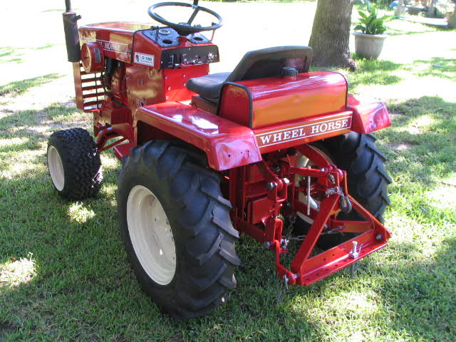

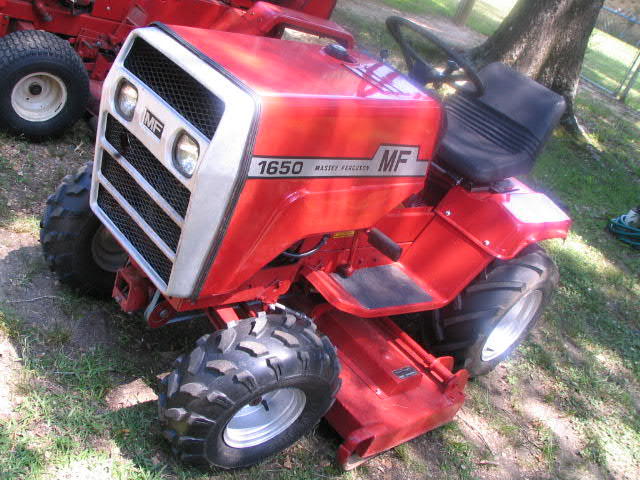

pacer 3,181 #7 Posted May 31, 2018 Sounds like you and I think alike regarding tires/rims, I dont particularly like the wide turfs on the 200 but they are in really good condition and like you are finding, rim choice is slim. As I mentioned, some time ago I shop made spindles for my 180 and used trailer tires, then more recently I went a bit different route on my 160 and chose a 10" ATV type tire on Kubota rims on a spindle I made up in my shop. Lastly, I just finished a refurb on a Massey Ferguson and used the original rims - with 3/4" spindle - and again mounted ATV tires. I like the way both of them turned out , some day I may try to come up with something on the 200.... This is my D-160 with the 10" on the front and the ag tires on back Then this is the MF with the ATV on front and ags again.... Share this post Link to post Share on other sites
ricksrj58 279 #8 Posted May 31, 2018 nice looking D,someday when i have room and time i plan to strip and repaint mine. Share this post Link to post Share on other sites
