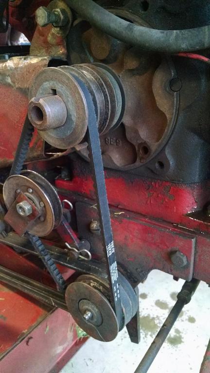

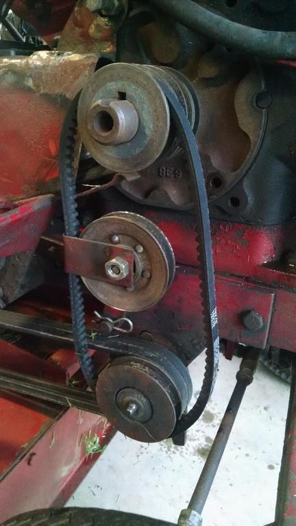

SIUC3 9 #10 Posted June 13, 2018 Sorry for the delay guys, but I did end up with a good fix! Went to O'Reilly's and they had a slotted 7-5/8" belt and works great! I'm two cuts in and hasn't slipped once yet! Here's some pics.... 2 Share this post Link to post Share on other sites
