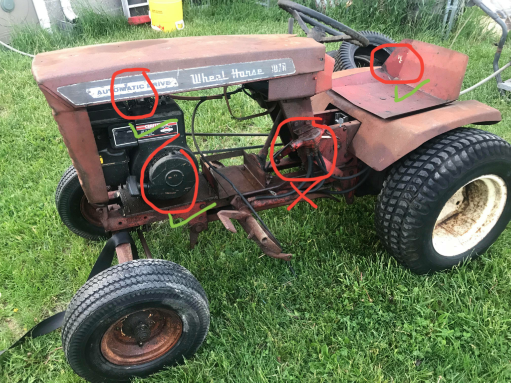

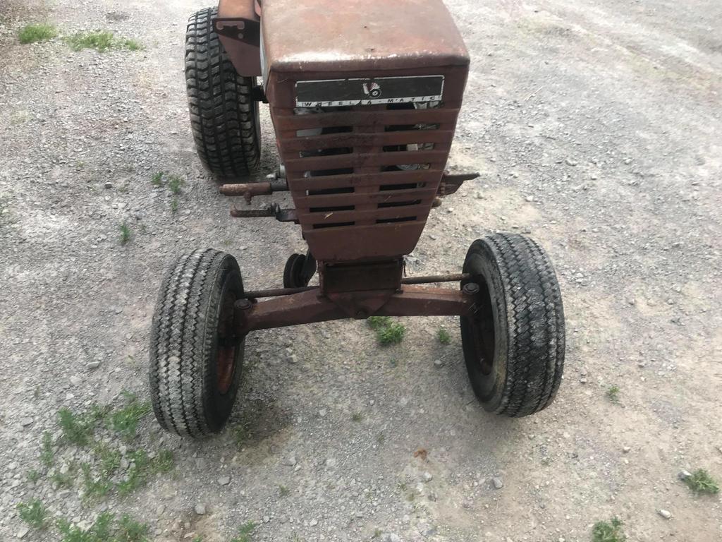

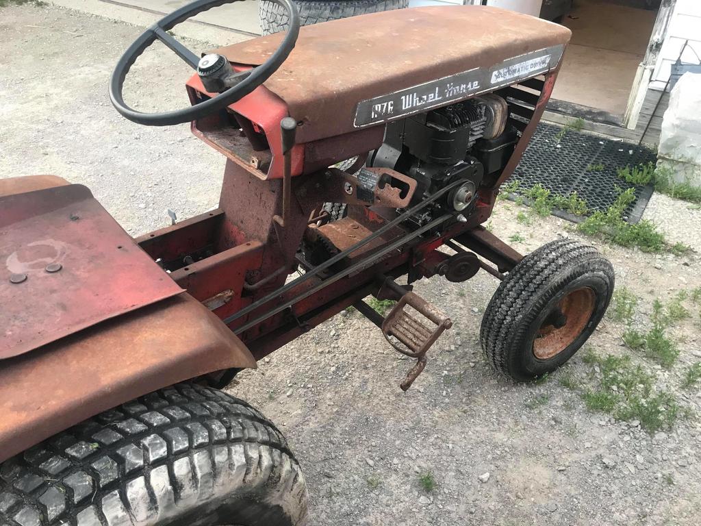

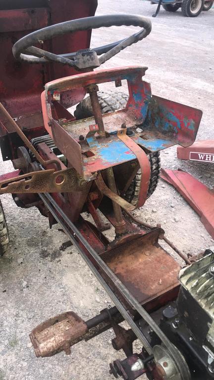

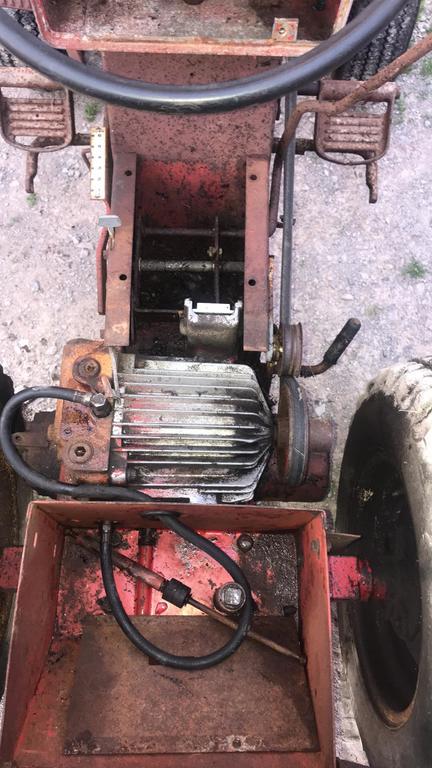

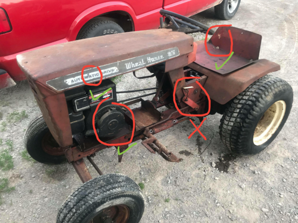

Joshua cartwright 9 #1 Posted May 30, 2018 I will be getting a 1966 wheel horse model 1076 soon maybe? The guy tells me lots of stuff about it but I need some advice from knowledgeable people. I noticed in one photo it had a pump on it and in another it was gone. He says it was the hydro lift pump for the deck. I will be using this tractor just for a ride around and to restore it for shows. Will this affect the hydro drive at all. I will try and put as many photos as I can up and you tell me......for $180.00 is it worth it? I circled main areas showing it is the same even the frame has the same wear. Share this post Link to post Share on other sites
pfrederi 21,308 #2 Posted May 30, 2018 The removal of the hydraulic lift will not affect just driving around. You will not be able to use any implements with out replacing the hydro lift control or replacing it with a manual lift. I can't see the engine clearly but it looks like about a 3.5 hp Briggs maybe a 5. That is woefully inadequate for a hydro. Too much money for me... 1 1 Share this post Link to post Share on other sites

pfrederi 21,308 #4 Posted May 30, 2018 There is more involved in removing the hydro lift than just running the hose back to the return, If you buy ask if he rearranged the implement relief valve in the hydro unit. 2 Share this post Link to post Share on other sites

Racinbob 13,286 #7 Posted May 30, 2018 I hate to say it Joshua, but that's nowhere near worth $180. It's been cannibalized and by the time you get it back in decent usable condition you'll have more into it than if you would have found a better machine. 3 2 1 Share this post Link to post Share on other sites

WHX?? 58,347 #15 Posted May 30, 2018 Looks like a parts tractor to me and most of what's desirable in parts is already gone. 3 Share this post Link to post Share on other sites
