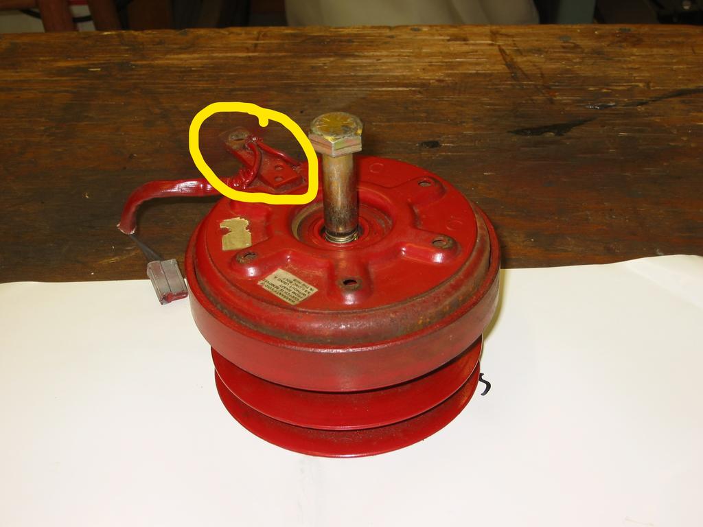

pfrederi 21,308 #4 Posted May 28, 2018 Not familiar with the PTOs on your tractors but have several on horizontal shaft engines. What anchors the PTO to keep it from spinning? Horizontal units have a small tab welded on the coil section that is fastened to a simple bracket to the engine block. all you would have to do is rig up a mounting bracket to connect to your field coil. and hold it still. 2 Share this post Link to post Share on other sites

WHX?? 58,347 #7 Posted May 29, 2018 The vertical clutches have a v shaped plate that is trapped by a bracket down off the frame. Also verts have the pullies on the outboard side so that may be a challenge. Share this post Link to post Share on other sites
