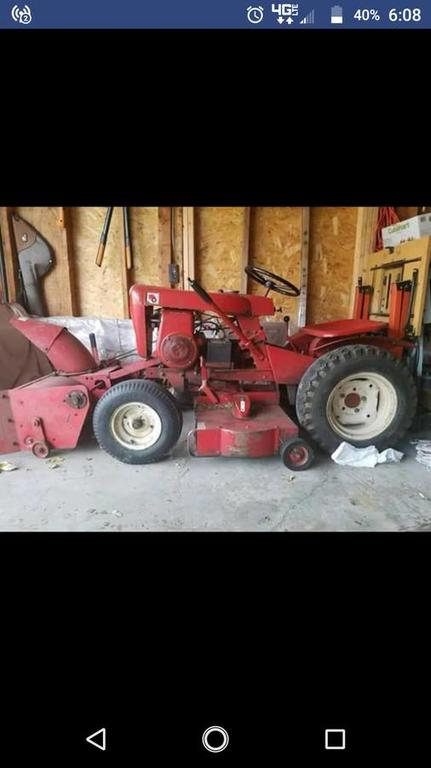

Stealth126 54 #1 Posted May 27, 2018 Would a 702 have come stock with a Kohler or Tecumseh? Share this post Link to post Share on other sites
Bach-Ed 170 #3 Posted May 28, 2018 K161 if my memory correct. 3 Share this post Link to post Share on other sites
953 nut 63,956 #4 Posted May 28, 2018 702 1962 Lawn & Garden Tractor 702 4-Speed Kohler K161S-28622E 7 HP 2 Share this post Link to post Share on other sites
ACman 7,686 #5 Posted May 28, 2018 If I’m looking at the same tractor on CL that’s definitely not the correct engine. Should have a starter/generator. if it’s a Kohler 8hp you should be able to make it work . Looking at the hood something is not right. Either the hood is just sitting on there or that engine is to tall (maybe needs a shorter air cleaner) . Like @953 nut said a K161 is the correct engine but a K181 with a small air cleaner like on a K91 should work. What ever you do.... ! 1 Share this post Link to post Share on other sites
