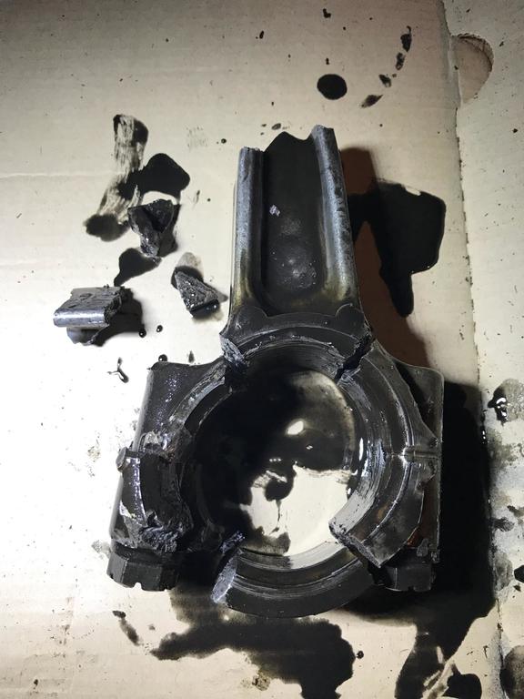

a.dumont 10 #1 Posted May 27, 2018 While mowing yesterday, my K482 on my 1973 D-180 started to smoke (oil). Then it stalled. I got it back to the garage, and found the oil level only 0.5 qt low on a 3.5 qt system. I added oil and started it back up. It ran smooth for 10 seconds, then a loud bang with a lot of vibration. I immediately shut it off. No compression on #1, and only 80 psi on #2. Pulling the head on #1 I found the piston free-floating (assuming connecting rod snapped?). There is a deep groove in the cylinder wall. Fellas, I was given this tractor to use by my father-in-law. He paid $1,000 as-is, after which I've spent another $1,100 on it. I was hoping to use it for 2 years to cut my 4 acres of grass and plow my 200' driveway, until I was able to get a subcompact. I only got 1 winter out of it. Aftermarket, oversized, rebuild kits are around $300, but now I need to involve a machine shop. I have no clue what local shops will charge for this, but I'm guessing around $200. In the end, I will still have a 45 year old tractor that doesn't have a loader or a backhoe... Should I repair it? Should I sell it as is? Should I part it out? Thoughts guys? 1 Share this post Link to post Share on other sites

pacer 3,179 #5 Posted May 27, 2018 Note fellas: Hes got a "D" model with the big 18hp 482 twin, and that is a whole different ball game from the KT17s - though they are fun too! You are looking at a mess there, parts for the 482 and its big brother the 532 are scarce. If your rod disintegrated - which it must have - rods are almost impossible to find, tho as 953 mentioned about Brian Miller, he does rods up to accept inserts, and your crank is also probably bad and he has some crankshafts. You would just have to contact him to see just what he could do. Probably gonna hit your wallet pretty hard whatever route you take. Then if your cyl wall is scored, can it be bored enough to clean it up....heres a link to - a looong page - covering what I mentioned http://gardentractorpullingtips.com/balance.htm Ive got both the K482 and the K532 and in trying to head off something like youve got, I elected to go into them and do an inspection, replacing/repairing/cleaning them and went ahead and added fresh pistons/rings/gaskets, etc. They both were very clean with nominal wear - thank goodness! 3 Share this post Link to post Share on other sites

a.dumont 10 #7 Posted May 27, 2018 0.030" over is the largest piston and ring set I can find. I think that would clean up the scoring. A good point was made that the crank may have some damage, and locating a new one would be tough. I found a source for a new rod, assuming that is what went. For all I know, the wrist pin came out of the bottom of the piston. In the end, I am heavily leaning towards getting a subcompact tractor, and letting the WH turn into a fun, slow, rebuild project instead of a necessity. Share this post Link to post Share on other sites

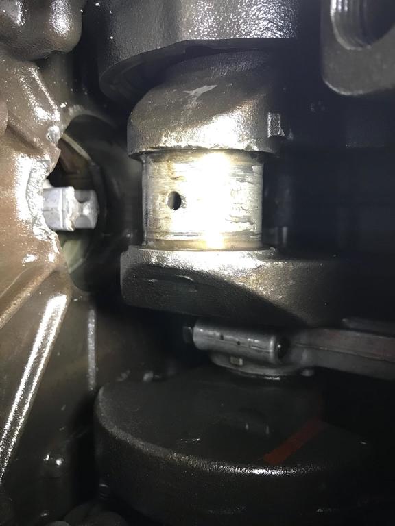

a.dumont 10 #12 Posted June 5, 2018 www.isavetractors.com sells the connecting rods, but after taking the bottom off... looks like a crank would be in the works too. Price just jumped on this rebuild. Found another engine for $200 without the core required. Going to swap it out for now. Will be selling the parts off this one soon. Share this post Link to post Share on other sites
