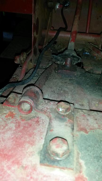

1940willys 138 #1 Posted May 24, 2018 Ok, so I've got this C101 Machine I'm making work worthy for my Daughter. Under the seat bracket, fenders, and gas tank, mounted to the top of the transmission is this mysterious tube like arrangement. It's mounted to the top of the tranny, maybe 10" long and flaired on one end. It goes nowhere! I thought perhaps it needed a rubber hose attached to one end and went to a nipple for venting the tranny. I see no nipple on the tranny for a vent hose. Can someone please tell me what this is and what it does? Sorry, I have no picture of it at this point. It would be GREAT if maybe someone has a exploded diagraham of this assembly! Share this post Link to post Share on other sites
benji756 342 #2 Posted May 24, 2018 sounds like the guide tube for the cable that lifts the rear attachments or sleeve hitch 6 Share this post Link to post Share on other sites
1940willys 138 #3 Posted May 24, 2018 Sounds feesable, I've never used any rear mounted attachments or seen any mounted in person. I know that old cubs raise and lower rear mount implements using heavy rods and leavers. Perhaps someone has a exploded diagram, as the link above does not work. Share this post Link to post Share on other sites
midpack 1,117 #4 Posted May 24, 2018 8 hours ago, benji756 said: sounds like the guide tube for the cable that lifts the rear attachments or sleeve hitch My 417-8 has a slot hitch with the tube and it has a cable running through it. the only problem it has it the cables too short... It wasn't hooked up when I got the tractor and when I connected it I found out why. Not having any rear implements, I disconnected it again and left it... for now Share this post Link to post Share on other sites
Chris G 3,371 #5 Posted May 24, 2018 (edited) If its the part in the photo. Then yes it is a cable guide for the lift on a rear slot hitch. Edited May 24, 2018 by Chris G 1 Share this post Link to post Share on other sites

1940willys 138 #9 Posted May 25, 2018 Chris G, yep there it is, that's it, the mysterious part. Now I know what it is and what it's used for! Thanx to everyone who replied! Share this post Link to post Share on other sites
