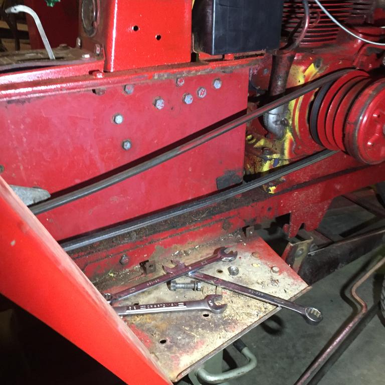

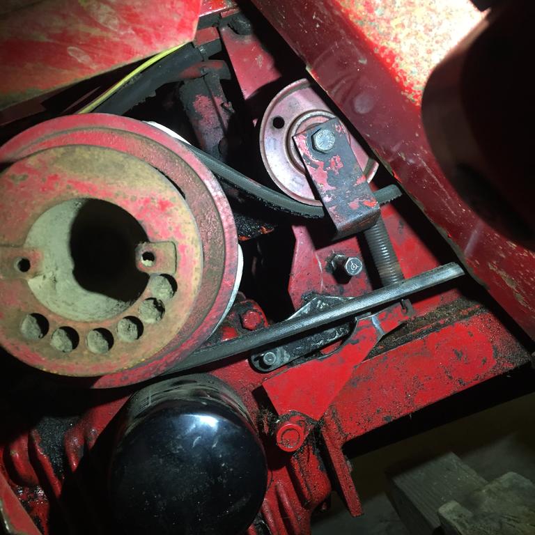

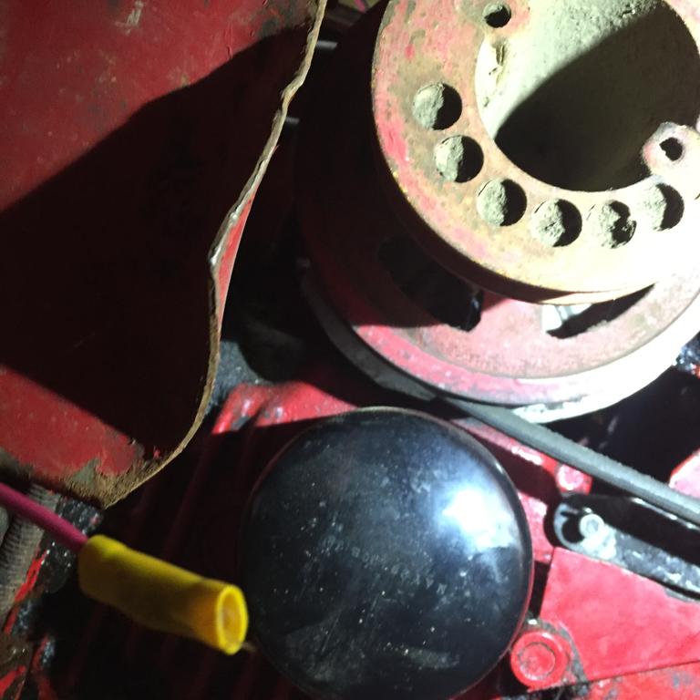

Shawn wheel horse 0 #1 Posted May 24, 2018 Looking for help I have a wheel horse gt 14 it runs great but when I go to drive it moves about a inch and makes a really loud screeching noise and a little bit of smoke came from the rear end and its hydro driven and it has a new belt on it for the hydro pump any help would be appreciated Thanks Share this post Link to post Share on other sites
Aldon 4,834 #2 Posted May 24, 2018 (edited) How long has it had the new belt? And by the way, welcome to the forum. Im in Corinth and if you can manage to get the tractor onto a trailer you could swing it buy and I can help you diagnose the issue. Perhaps assist with repair. Edited May 24, 2018 by Aldon 2 Share this post Link to post Share on other sites
Aldon 4,834 #3 Posted May 24, 2018 My guess is that an idler pulley has seized 1 Share this post Link to post Share on other sites
953 nut 69,956 #4 Posted May 24, 2018 How did the tractor perform prior to replacing the belt? Did you pay close attention to the routing of the old belt and install the new belt the same way. There is a runner at the bottom end of the belt travel that the slack belt will rest on, if your belt is under it that would explain it. Take a look. 2 Share this post Link to post Share on other sites
Shawn wheel horse 0 #5 Posted May 25, 2018 I looked the belt the guy before me put on was lose but it still spins the transmission fine but still dosent move and still makes the noise not Shure it the guy put the belt on right Share this post Link to post Share on other sites
