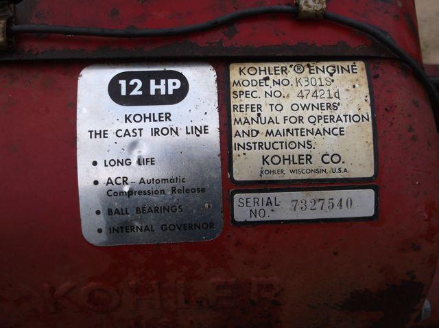

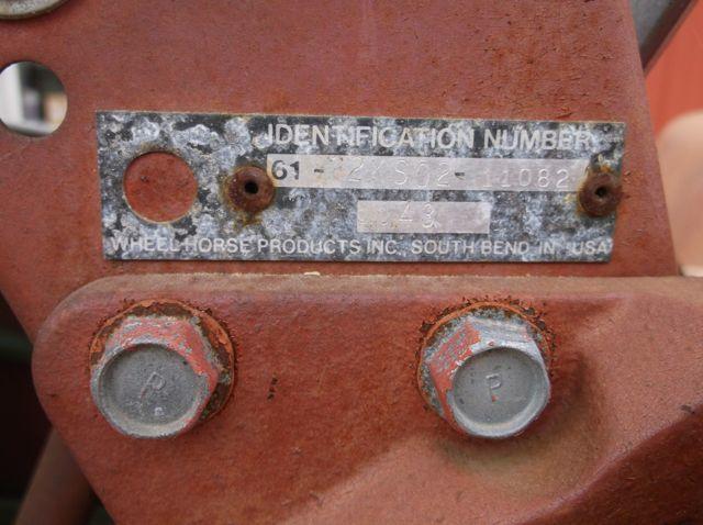

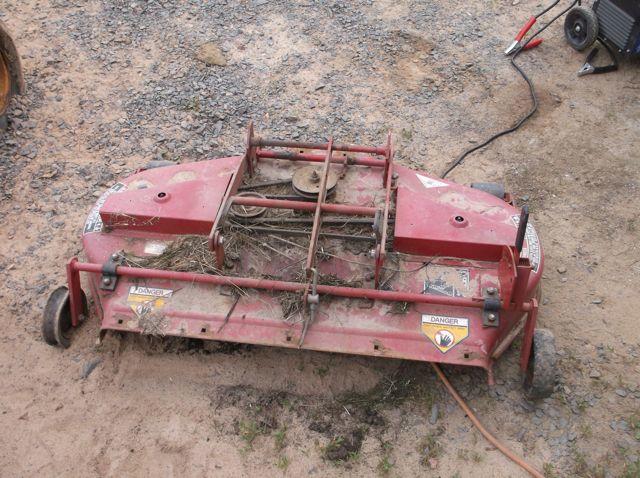

rmaynard 17,573 #2 Posted May 21, 2018 What year is the C-120, and what is the model number of the deck? If you can't find the model number, what size is it? Is it side or rear discharge? Share this post Link to post Share on other sites
rmaynard 17,573 #4 Posted May 21, 2018 You have a 1976 C-120. The deck appears to be a 42" rear discharge. The Toro part number listed for a 1976 65-42MR01, 42" Rear Discharge Mower Deck is #108834. 1/2" x 98" 1 Share this post Link to post Share on other sites
