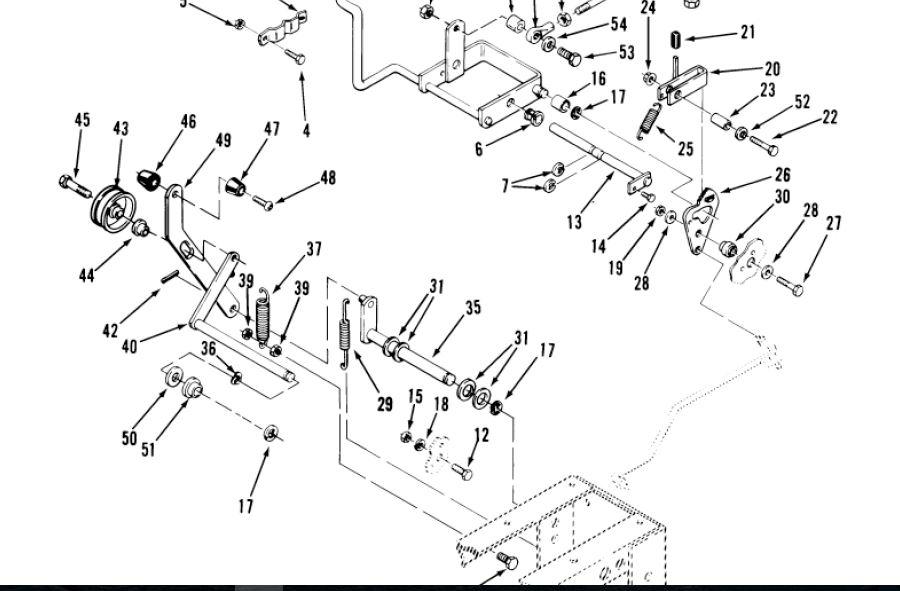

johnnymag3 2,646 #1 Posted May 20, 2018 (edited) where can I find a new or used Hydro release arm? mine is ready to break in half as the idler pulley wore a groove out in it . Can I fix it? does anyone know where I can get a picture of how it is supposed to look before its all worn out? Thanks John..... new here, as you can tell, unsure as to where to post things By the way I forgot to mention the tractor type....oh boy 1987 418 A Edited May 20, 2018 by johnnymag3 all confused Share this post Link to post Share on other sites
pfrederi 21,095 #2 Posted May 20, 2018 Parts manual is here part is 110780 still available from Toro or Check with one of our vendors A to Z tractors www.a-ztractor.com for a used replacement 1 1 Share this post Link to post Share on other sites

johnnymag3 2,646 #7 Posted May 26, 2018 Thanks for the help guys. A welder at my day job laughed at me, and said give me that arm! He welded a nice smooth area where the idler had worn out a big oval in the arm, then he used a dremel to make it look and work like brand new.... I buffed it out, and the thing works great, no more rattles ! Nothing like OEM he said, metal is better than what you can get today THANK YOU RED SQUARE !!!!! John 1 1 Share this post Link to post Share on other sites

squonk 47,986 #9 Posted May 26, 2018 1 hour ago, johnnymag3 said: Thanks for the help guys. A welder at my day job laughed at me, and said give me that arm! He welded a nice smooth area where the idler had worn out a big oval in the arm, then he used a dremel to make it look and work like brand new.... I buffed it out, and the thing works great, no more rattles ! Nothing like OEM he said, metal is better than what you can get today THANK YOU RED SQUARE !!!!! John I've had 2 fixed where the hinge pin wears out. Guy cuts off the old pin and welds on a new one. Weld the oblong pin hole shut and drills a new hole to fit the pin. Share this post Link to post Share on other sites
