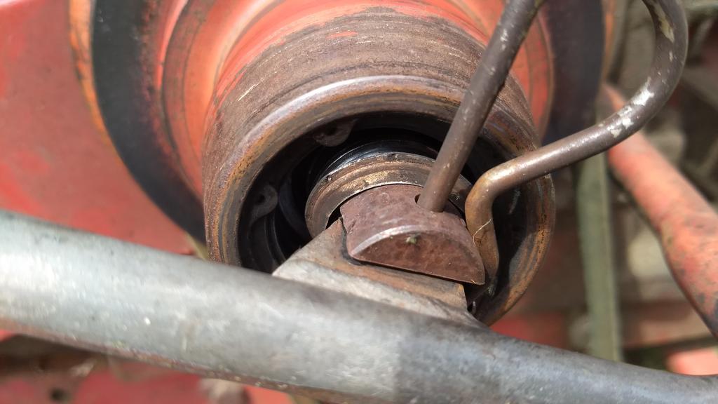

sdhdcouple 133 #3 Posted May 17, 2018 well after looking at the down load you provided, i have to go look. I was mowing and just lost all belt power and the pto was engaged but just not spinning the belt. It should be cooled off i am going out to take it apart . stand by for pictures 1 Share this post Link to post Share on other sites

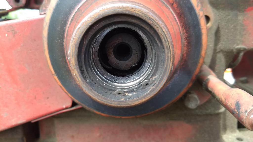

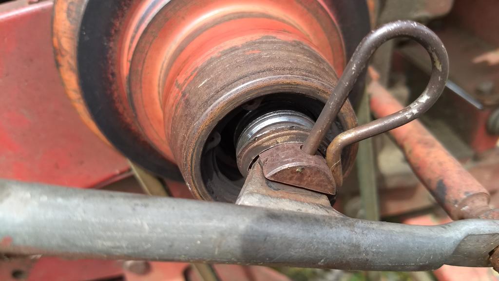

sdhdcouple 133 #5 Posted May 17, 2018 OK here is a few pics. Guessing I lost a bearing. Share this post Link to post Share on other sites
WHX?? 54,527 #6 Posted May 17, 2018 Well that's not too serious. Funny you couldn't hear or feel that one going out. Note the alternative part numbers in this thread. I would clean and regrease the needle bearing while I had it apart ... replace the seal as well. Seal is at NAPA also, have them cross a Victor 53104. 1 Share this post Link to post Share on other sites
sdhdcouple 133 #7 Posted May 17, 2018 funny you mention hearing it, last week and today kept hearing a noise. But I kept hearing it on the left side while on it. I was riding a round and kept hearing something but could not put an ear directly on it. guessing (hoping) this is all it is. don't happen to have a good napa part number for that bearing do you? Share this post Link to post Share on other sites
