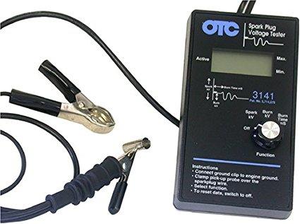

rmaynard 17,436 #11 Posted May 16, 2018 (edited) How are you checking it? Most meters won't read spark plug voltage without a high voltage adaptor like this. Edited May 16, 2018 by rmaynard Share this post Link to post Share on other sites

rmaynard 17,436 #14 Posted May 16, 2018 13 minutes ago, Brent Fabian said: I'm just using a basic multimeter set to 20V. Trying to read 20,000 volts set at 20 volts is a good way to fry your meter. Share this post Link to post Share on other sites
953 nut 67,505 #15 Posted May 17, 2018 (edited) The spark is a rapid collapse of a magnetic field, multi meters are built to read continuous voltage, not instantaneous. Like john said, check it with a plug or get a spark tester. Edited May 17, 2018 by 953 nut fat finger Share this post Link to post Share on other sites
