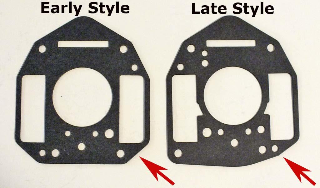

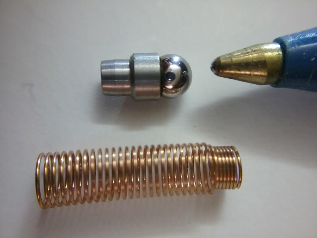

onanparts.com 185 #13 Posted May 19, 2018 Here is a side by side of the early and late style "Nikki" Onan carb bowl gaskets. One corner makes all the difference! Also is a pic of that itty bittty teeny tiny ball and spring that can and will disappear if you are not VERY careful when cleaning the later style carbs with accelerator pumps. Tip of a ball point pen for reference. Ball is attached to the small end of spring and ball end goes in first. The long brass piece on the bowl cover has to go "inside" the spring when assembling. 1 Share this post Link to post Share on other sites
bo dawg 640 #14 Posted May 19, 2018 16 minutes ago, onanparts.com said: Here is a side by side of the early and late style "Nikki" Onan carb bowl gaskets. One corner makes all the difference! Also is a pic of that itty bittty teeny tiny ball and spring that can and will disappear if you are not VERY careful when cleaning the later style carbs with accelerator pumps. Tip of a ball point pen for reference. Ball is attached to the small end of spring and ball end goes in first. The long brass piece on the bowl cover has to go "inside" the spring when assembling. Thank you Mr. Onan, I appreciate that. Yes I did find the little ball attached to the spring at the bottom of the hole so were good there. And the gasket I need is the one on the right. Share this post Link to post Share on other sites
