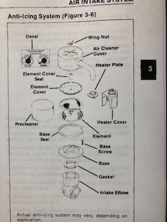

Bill Sherman 11 #1 Posted May 15, 2018 My 1986 417-8 is equipped with the anti-icing system air cleaner and I am having trouble finding the correct element for it. I have yet to even find out what is the correct part number. It is 6 inches OD and 1 7/8 high. Any help would be greatly appreciated. Share this post Link to post Share on other sites

953 nut 70,649 #4 Posted May 15, 2018 3 hours ago, Bill Sherman said: 417-8 is equipped with the anti-icing system air cleaner The anti-icing system is just a mater of relocating the air intake to have hot air from the engine going to the air intake, nothing special about the filter. I see you are in South Carolina. If you have an Agri Supply store near by they can fix you up. https://www.agrisupply.com/searchcenter.aspx?keyword=235116+kohler&prv=&adv=&hawkb= 1 Share this post Link to post Share on other sites
