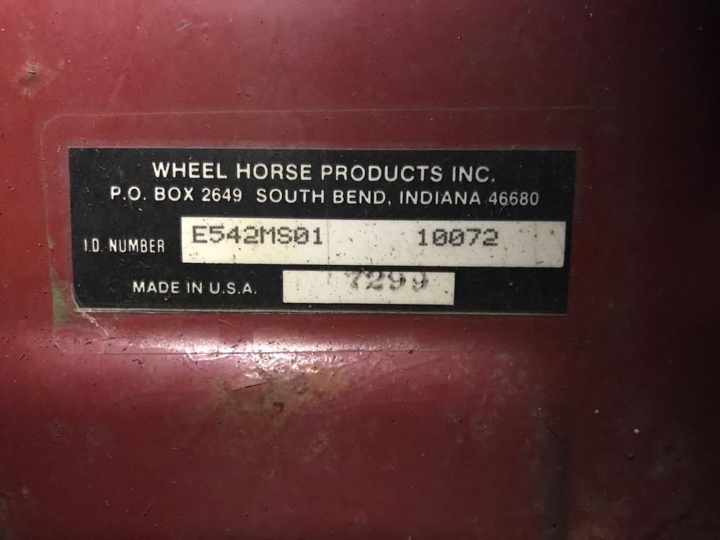

gwest_ca-(File Mod) 12,341 #2 Posted May 13, 2018 Tractor drive belt has been added to this page. Click on the pictures The E5-42MS01 is the mower deck model. Mower drive belts are on this page. Garry Share this post Link to post Share on other sites
Kasweld 7 #3 Posted May 13, 2018 Thanks Garry this tells me the part numbers but I’m struggling to find any wheelhorse spares departments in uk, so was looking for the belt lengths so I could order from that thanks Share this post Link to post Share on other sites
gwest_ca-(File Mod) 12,341 #4 Posted May 13, 2018 If you click on the pictures the page that comes up has had the belt dimensions added to it in inches. 5/8" x 81.9" = 15.88mm x 2080mm for the tractor. Our aftermarket belts come in even inches so 82" = 2083mm long. 1/2" x 103" = 12.7mm x 2616mm for the mower drive belt 1/2" x 86" = 12.7mm x 2184mm for the spindle belt Garry 1 1 Share this post Link to post Share on other sites
