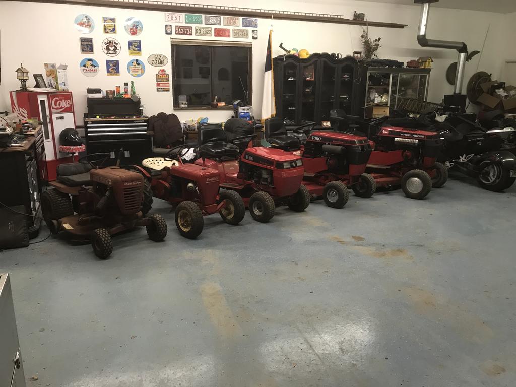

Tbonz 2 #1 Posted May 12, 2018 Hi im looking for some advice on newer(plastic hood) wheel horses. I have a few 300 series and a 520h also a suburban and lawn raider. But I’m looking into getting a plastic hood wheel horse for a cleaner mulch/bag option and tighter turning radius for a little under 2 broken up heavily landscaped acres at my work. I’m looking at 3 models: 22-38 hydro. 16-44 hydro. And 267 or 268 hydro. Or posibly a used residential toro zero. Any opinions or assistance out there. Thanks in advance. Share this post Link to post Share on other sites
