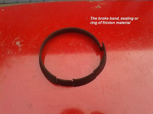

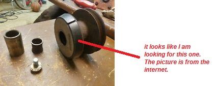

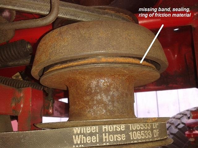

Mark1983 9 #1 Posted May 12, 2018 (edited) Hello people, Hi there, I am new here. I must say I am impressed on how active this forum is. It looks great! Since a few weeks I own a 211-5 Wheel Horse tractor. The Wheel Horse had been stationary for two years. Today I used it for the first time when some kind of ring or seal on top of the cluth pully broke. Now there is no good transmission anymore so the mower deck doesn't work properly. I attached some pictures for clarification. I can't seem to find this part anywhere, perhaps because I use the wrong term for it. Can anyone help me to find it or at least can tell me what the name of this part is? Thank you very much! Bonus question What is the difference between a (original) Wheel Horse and a Toro Wheel Horse? Did "Toro" bought "Wheel horse" at some time? Edited May 13, 2018 by Mark1983 Share this post Link to post Share on other sites

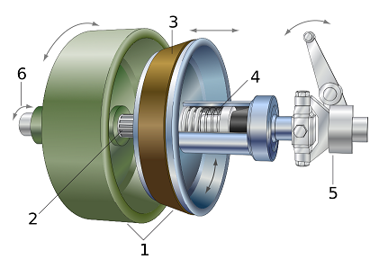

Mark1983 9 #4 Posted May 12, 2018 (edited) Well, I did some further research. I post my result here so perhaps I help someone else with it. Apparently the clutch in the 211-5 (and other types also) is a 'friction cone clutch'. See image below. The part I am looking for is the friction material (nr. 3) that I can wrap around the male part of the cone clutch... The search continues..... EDIT: Apparantly in the past friction materials (for clutches for example) where manufactured with asbestos.. Don't panic... I am still alive... Edited May 12, 2018 by Mark1983 2 Share this post Link to post Share on other sites

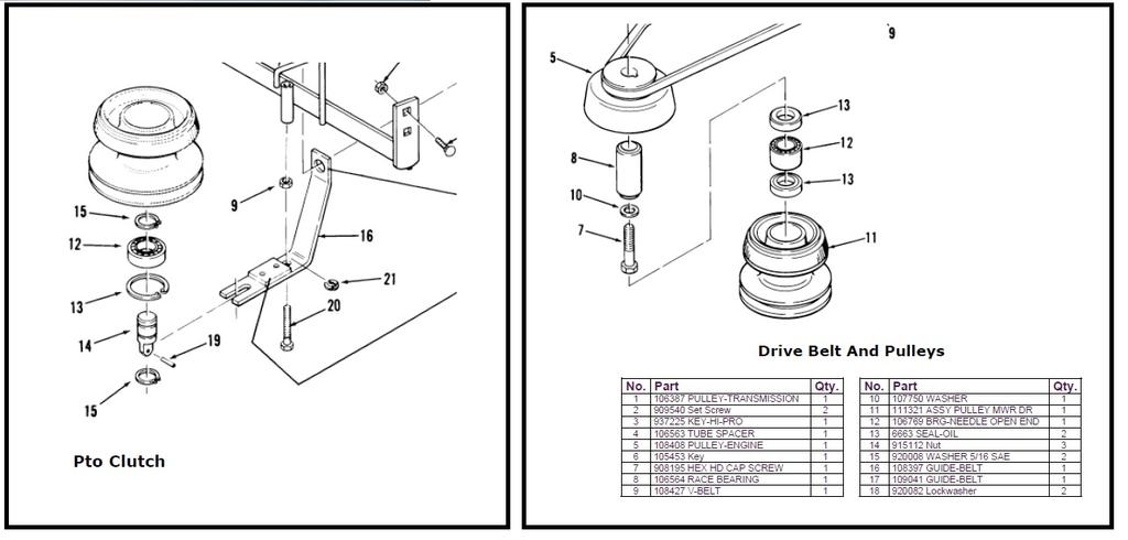

gwest_ca-(File Mod) 12,519 #6 Posted May 12, 2018 https://www.partstree.com/parts/toro/mowers-lawn-garden-tractor/22-11b502-211-5-toro-211-5-tractor-1986/drive-belt-and-pulleys/ Toro does not supply the friction material separately. Garry 1 Share this post Link to post Share on other sites

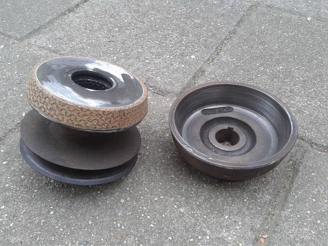

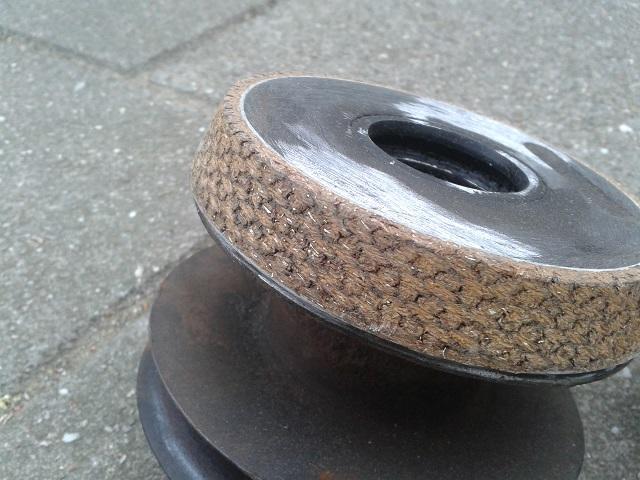

Mark1983 9 #7 Posted June 7, 2018 It is correct that the friction ring or friction material for the clutch isn't sold separately. ...unfortunately. At the end I sent the clutch to a specialist to vulcanize a new friction ring on to the clutch. The result is good. I paid 80 euros (that's at this moment $94). Not cheap but cheaper then a new clutch. Here below are two pictures. My Wheel Horse is working again! 2 1 Share this post Link to post Share on other sites
stevasaurus 23,861 #8 Posted June 7, 2018 I think you did very well Mark. That kind of thing for a vertical shaft horse has got to be hard to find. Glad to hear you got the horse running again...very lucky and a good success story. Thank You for letting us know you got it worked out and with excellent pictures. Share this post Link to post Share on other sites
