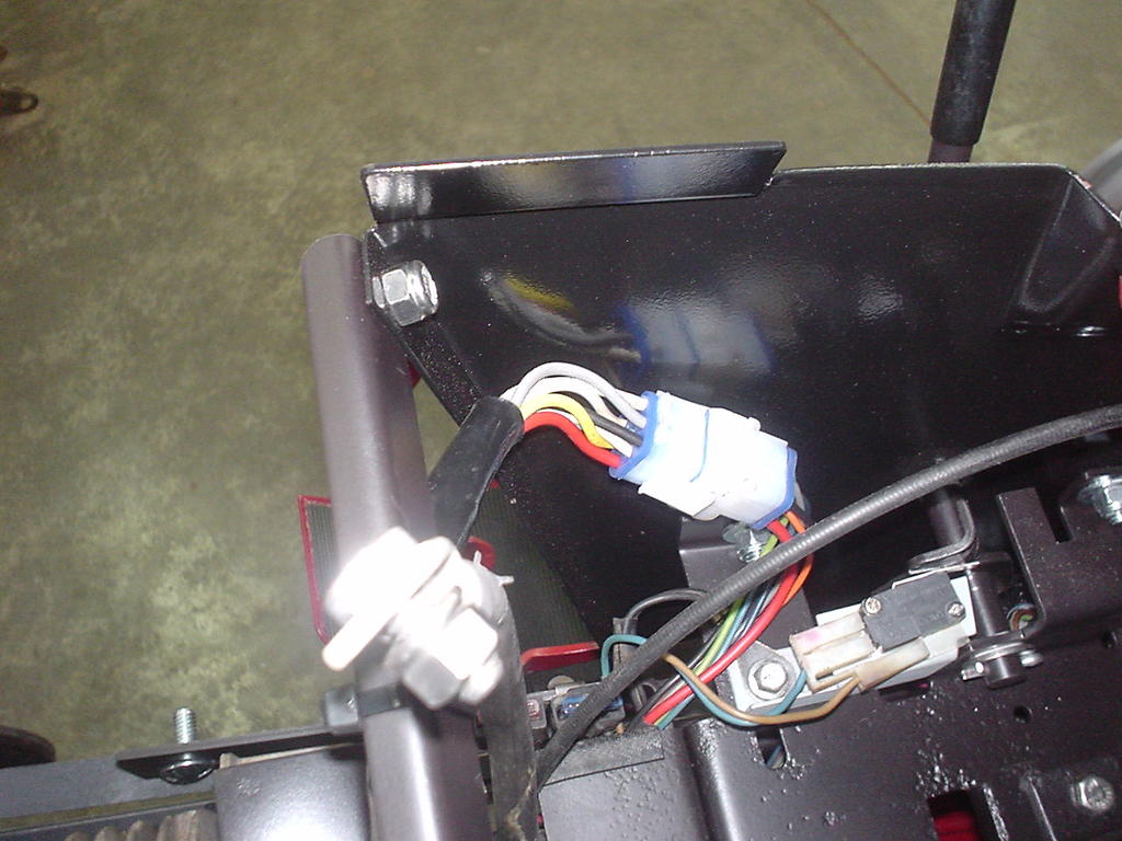

cleat 9,208 #3 Posted May 11, 2018 Search for " 9 Way Sealed Splash Proof Mate N Lok Electrical Wiring Multi Connector " on ebay. That is the one I bought to replace bad connectors. Here it is installed. Cleat 5 Share this post Link to post Share on other sites

Wayne0 1,624 #8 Posted January 26, 2025 (edited) You really don't need the 9 pin connector unless you plan on swapping the motor in the future. You can use H2O proof in line fuses and H2O proof crimp connectors to eliminate it. Many here have done it. It's a very common trouble spot. Edited January 26, 2025 by Wayne0 Share this post Link to post Share on other sites
Rick Smith 1 #9 Posted January 26, 2025 Good point. I had forgotten about those. Thanks very much. Share this post Link to post Share on other sites
cleat 9,208 #10 Posted January 27, 2025 (edited) 6 hours ago, Rick Smith said: Cleat, where did you find the 9 pin waterproof connectors? I'm interested in buying those. Thank you. I used these. https://www.ebay.com/itm/130984528895?_skw=9+Way+Sealed+Splash+Proof+Mate+N+Lok+Electrical+Wiring+Multi+Connector&itmmeta=01JJJW91RACGPFES39NTZ2HRKV&hash=item1e7f494bff:g:obkAAOSwHUhZ9zsO&itmprp=enc%3AAQAJAAABIHoV3kP08IDx%2BKZ9MfhVJKkeEakmavtbUb8Hnf9kWuw%2FaqtA61Ahl%2F46NamZTYdlLs3FyAOmAncHDmGva8Q9buRyhCNrlZZOcW2XoDnbZwC9hB35go141ENIRaE9KEbaJ7Np%2BxgWaXZu073jP6RgP6DBSapL8%2BYtOoRHc9ydk%2FCErDk6wym6wmgnJvr31Oz0lAapAAQnRGb85C5RzB1NudfQMSr6nis4jY%2B7OalSe%2BtNBoVfrTv8dISWvCnY%2BpdeBDFuSmEjjPApAWU8FnvK8OZOACqTlkXuOS8qWbmeFSlxub6IhNBJS2BIMALnCdt3sm5nezI6ON1aBZxJXCA7WFW%2FWEkKr4E91iFIxzpOLeU%2BItbeimyyRFoBubDeWhomHw%3D%3D|tkp%3ABk9SR6KcpNyUZQ After installing this connector and removing the charge wire from it by running the charge current directly from the regulator to the battery cable at the starter motor through a 30A inline fuse I have never had another issue. I keep the 9 pin because I have several machines with Onan engines and if need be I can easily swap engines if ever needed. Edited January 27, 2025 by cleat 1 Share this post Link to post Share on other sites
