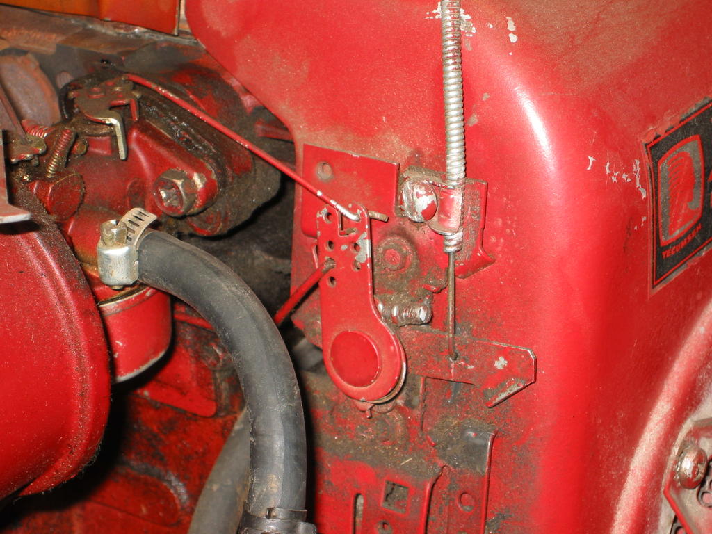

RadRacer203 0 #1 Posted May 7, 2018 Just picked up my first tractor (or maybe riding mower?), a '68 or so Lawn Ranger. I stole it for $50 but it didn't have the original motor and the throttle assembly is pretty hacked up. I got it running last week and the motor bent a valve really badly so I got a cheap late 70's replacement out of a snowblower. It's almost back together and good to go, but I can't seem to find the correct governor spring to get the throttle working. I know I need a short spring, probably about 2" or so but I can't find the correct one because I don't have the original model number to look up. Here's a couple pics of the tractor and one of the throttle assembly, hopefully they attache properly. Overall in really good shape, good transaxle and just a little rust in the front of the mower deck. Share this post Link to post Share on other sites

gwest_ca-(File Mod) 12,373 #4 Posted May 8, 2018 Picture of the spring http://www.partstree.com/parts/tecumseh/parts/31386/ If you click on one of the lines it takes you to the parts list Garry Share this post Link to post Share on other sites
RadRacer203 0 #5 Posted May 8, 2018 Great, thanks! I picked up that spring and it's definitely the one I needed. The engine runs pretty good now that I adjusted the governor. Some more tuning on the carb and figuring out why the mower deck won't spin is next on the agenda. Share this post Link to post Share on other sites

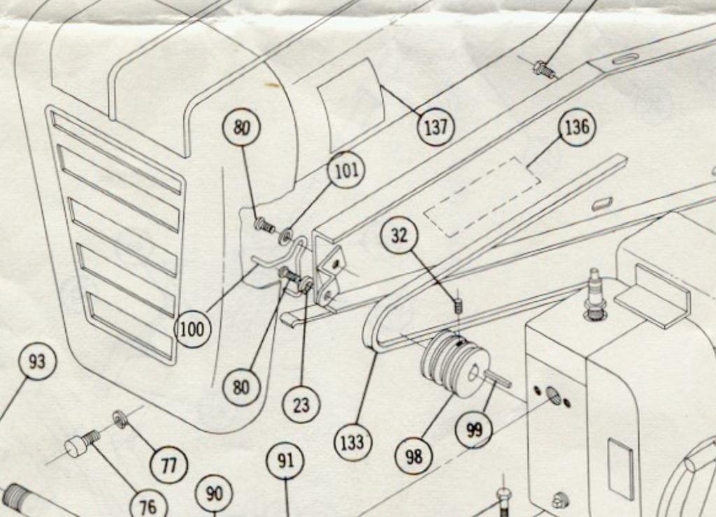

pfrederi 20,899 #6 Posted May 8, 2018 Great machines. From picture i think you are missing the little wire guide (#100) that keeps the deck belt in line and allows it to slip when not engaged. When you release the foot lever the springs will pull teh idler assembly up tighten the belt and it should work, You can see where the idler pulley has scuffed eh belt guard...Happens all the time. Share this post Link to post Share on other sites
RadRacer203 0 #7 Posted May 8, 2018 I didn't even realize there was such a piece, does anyone make a reproduction? And I see what it does now. My deck still spins even when it's not engaged. I think that's the last piece I need, the engine runs good now, the governor is adjusted right this time, and the mower deck unstuck itself. Share this post Link to post Share on other sites

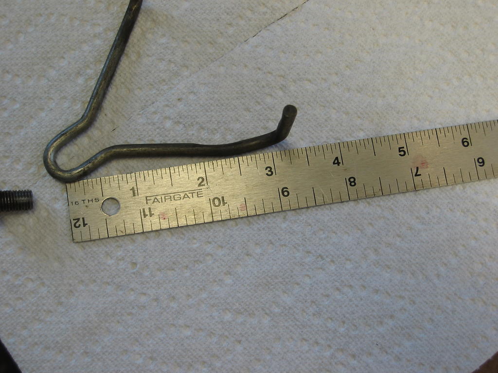

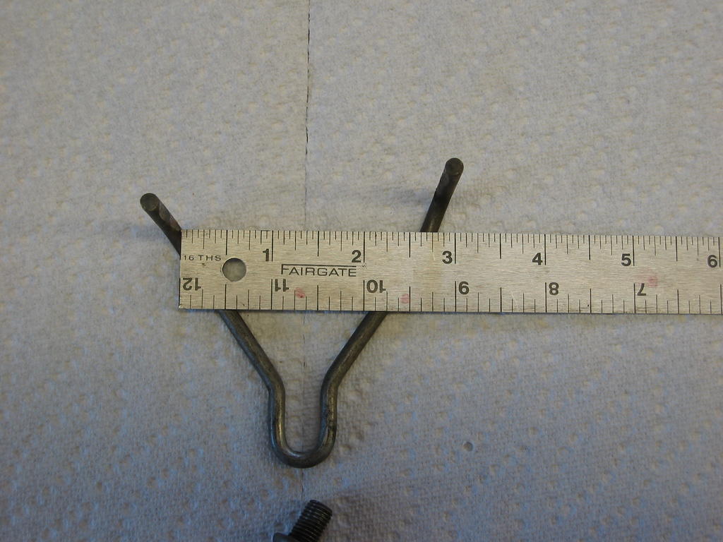

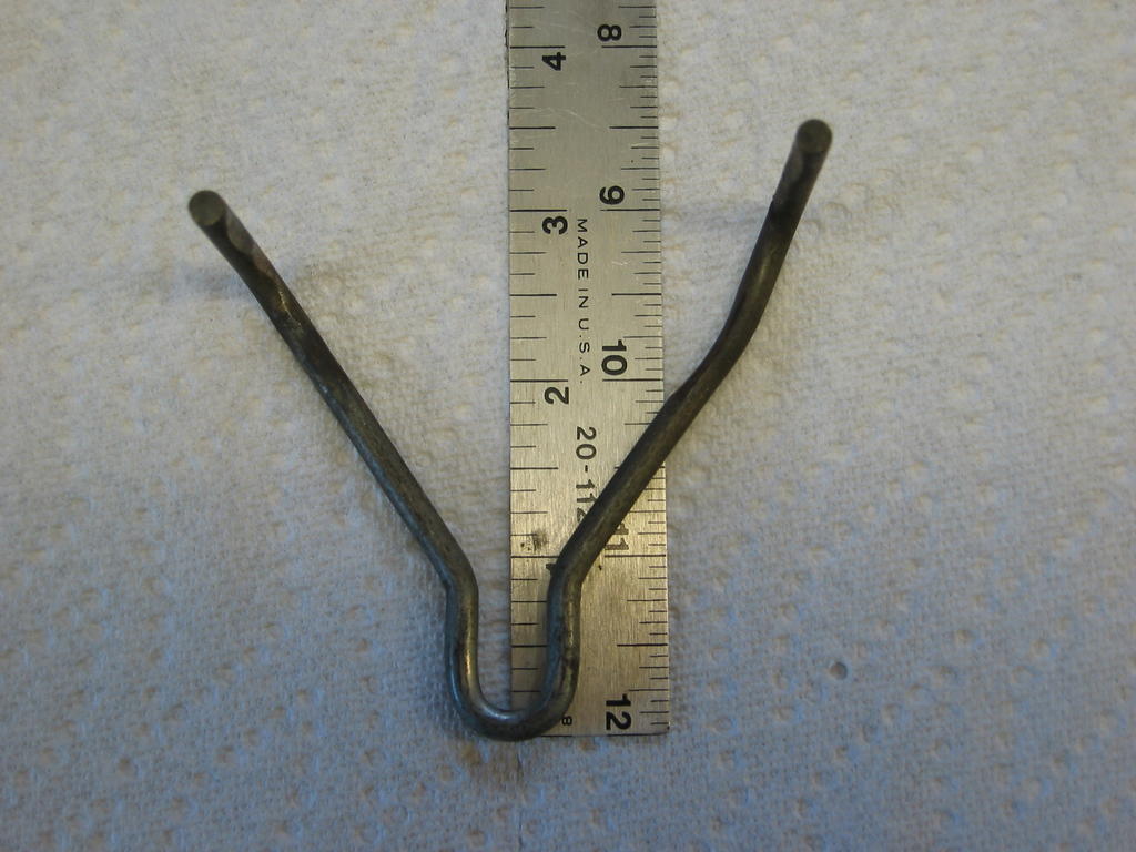

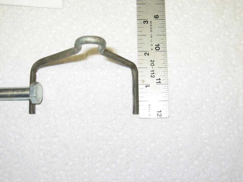

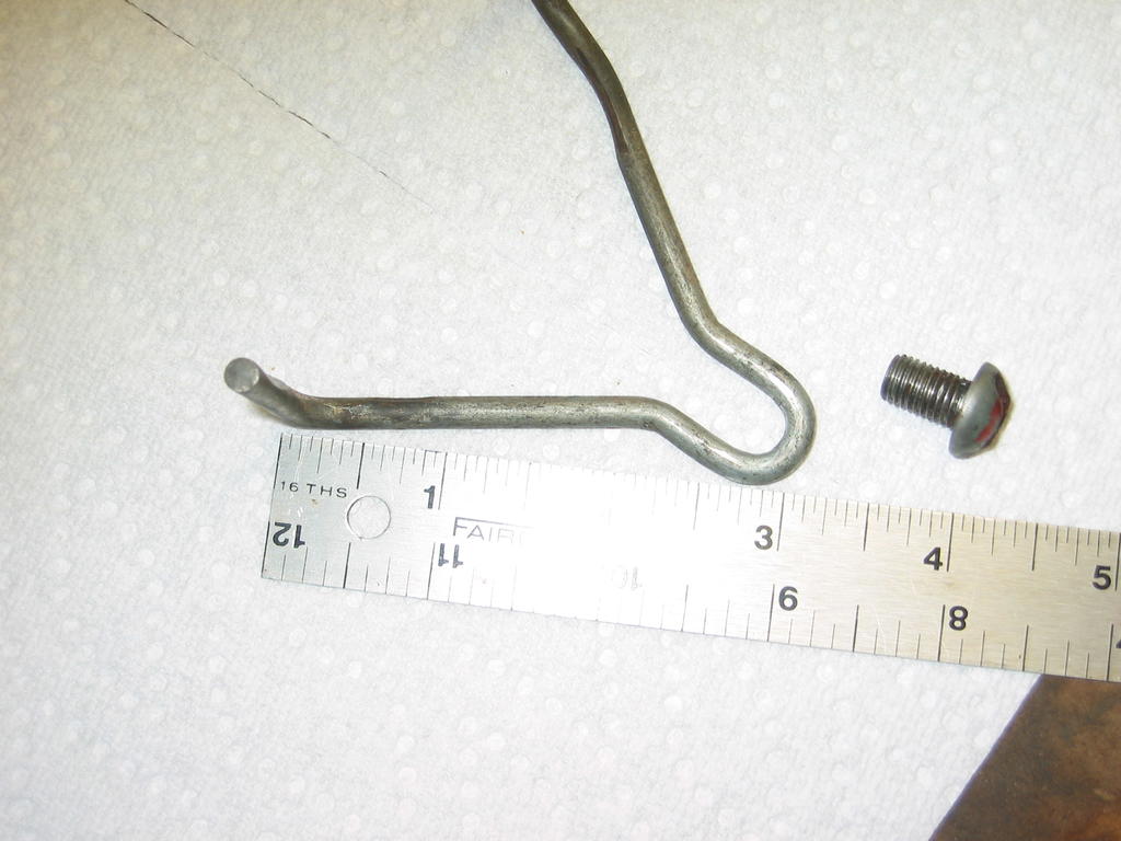

pfrederi 20,899 #8 Posted May 8, 2018 I will take some close ups of mine and a couple measurements. You can make one pretty easily bending some stock Share this post Link to post Share on other sites
RadRacer203 0 #9 Posted May 8, 2018 That would be great, thanks. Looks like I'll be needing another engine now too... My $30 replacement just threw a rod out the side of the block Share this post Link to post Share on other sites
pfrederi 20,899 #10 Posted May 8, 2018 (edited) Ouch!!! it is 3/16" rod the Slot head bolt is 5/16 NF Edited May 8, 2018 by pfrederi Share this post Link to post Share on other sites

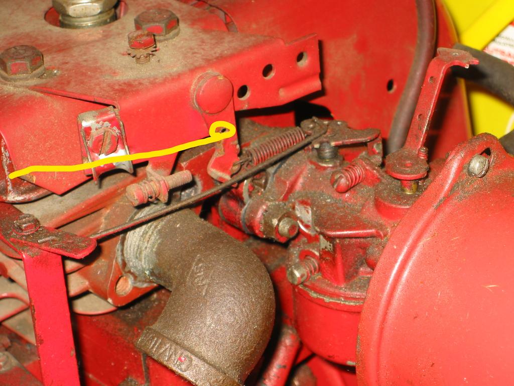

pfrederi 20,899 #18 Posted May 13, 2018 What model number is the engine you are working on now? Techumseh used differing carb linkages does your set up look like either of these. Techies work best if they are left alone. Mine all run really well. But i have come across some that people tried to "work on" usually they made things worse then sold it. The manuals are really pretty good if you are using the right one for your engine. The yellow line is where the throttle cable would come in if she was mounted at the moment. Share this post Link to post Share on other sites
RadRacer203 0 #19 Posted May 13, 2018 I'm using the same throttle linkage as I posted the picture of before, and in the second of your pictures. I swapped the linkage over from the old engine(s) Share this post Link to post Share on other sites
