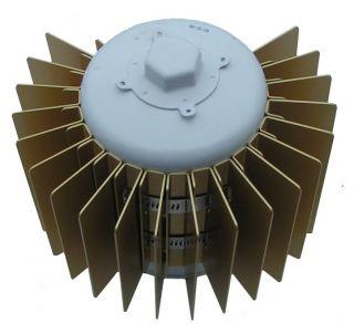

wallfish 20,724 #16 Posted May 9, 2018 10 hours ago, WHX17 said: This is an pressure fed oiler Pressure lube is even better. They do sell remote oil filter kits which something could be adapted to for cooling but they're kind of expensive IMO. How about aluminum cooling fins that clamp right onto the filter? Couple of hose clamps, some thin aluminum angle pieces with little slots for the hose clamp bands. Backyard Hammer mechanic style oil cooler! 2 Share this post Link to post Share on other sites

CountryRock 199 #19 Posted May 10, 2018 On 5/9/2018 at 8:38 AM, WHX17 said: Now that's kinda neat. I have the lower profile Briggs oil filter on there now, would have to get a little bit longer filter. Looking at the Frame XG3614, which I think is what I saw on yours in one of the pictures. Share this post Link to post Share on other sites
