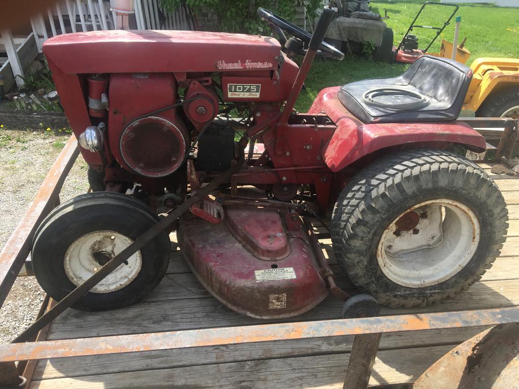

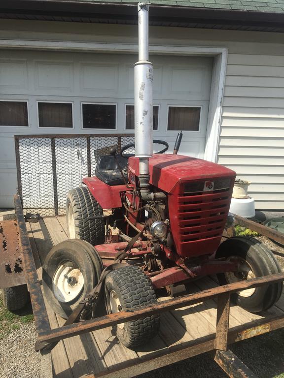

wheel horse man 56 #1 Posted May 7, 2018 I need to know what other tractors use the same belt guard as the 1075 i have a charger 14 hydro belt guard some where will it work 1 Share this post Link to post Share on other sites

wheel horse man 56 #3 Posted May 7, 2018 Thanks i think the 875,876,877 will also work not for sure completely i know the all had 8hp engines and the 1075 has a 10 ther different block heights Share this post Link to post Share on other sites
