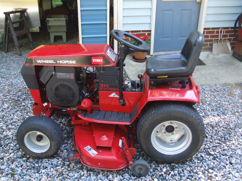

armstrrw 15 #8 Posted May 10, 2018 Guys, thanks for your guidance and advice. Did exactly what was recommended and tractor runs/drives as new. Fortunate that I happened upon this completely original 2000-01 314-8 with only 334.2 hours on meter. What a jewel! I replaced brake assembly, belts, plug, filters (air/fuel), lubed all zerk fittings, changed oil + filter, sharpened blades, replaced some absent seat mounting hardware, low-pressure washed, and went-a-mowing. What a pleasure and to think that this jewel of an American made garden tractor is no longer manufactured! She was always stored inside, under a cover when not in use. Here is a photo of the tractor with 48 in. deck. 2 3 Share this post Link to post Share on other sites
WHX?? 58,347 #9 Posted May 10, 2018 Nice Bob... Very clean! 1 Share this post Link to post Share on other sites
Warning:Unsupervised 83 #10 Posted July 21, 2019 Extremely hard to locate in this shape in my area. Great job hope you enjoy it many yrs. Share this post Link to post Share on other sites
