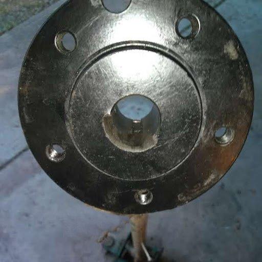

Bob Nakon 55 #52 Posted May 25, 2018 Ron, I ordered a new hub. The hub loosened and moved toward the gearbox, the woodruff key tipped and locked it there and then tore up the hub. I posted pictures of it. Bob Share this post Link to post Share on other sites

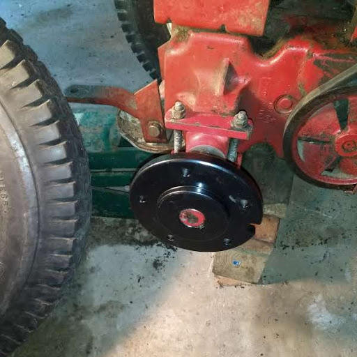

Bob Nakon 55 #55 Posted June 5, 2018 I thought I would show you guys my $103.38 hub. She's a beauty ain't she? Thanks again for the help boys. Bob 1 Share this post Link to post Share on other sites
wallfish 20,125 #56 Posted June 5, 2018 9 hours ago, Bob Nakon said: I thought I would show you guys my $103.38 hub. She's a beauty ain't she? Did that solve the sudden engagement issue too? Share this post Link to post Share on other sites
Bob Nakon 55 #57 Posted June 5, 2018 It absolutely did solve it. If you look at the worn hub it would turn freely until the key hit the worn shoulder with a bang. Glad it's fixed. Bob 1 Share this post Link to post Share on other sites
