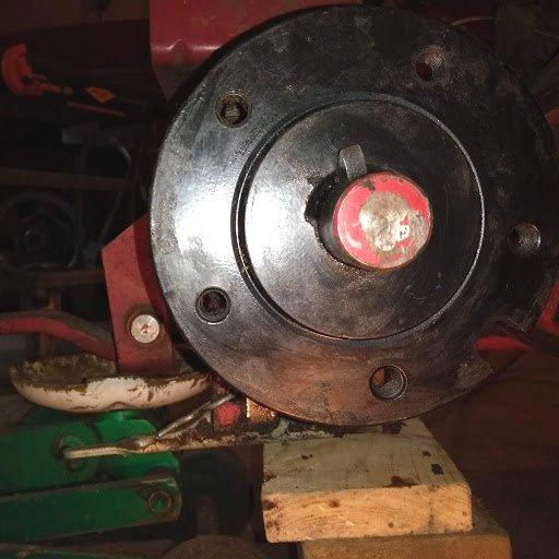

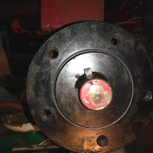

Bob Nakon 55 #26 Posted May 22, 2018 Hi Guys, Finally got the TracVac fixed and put back together. It had me on the ropes for a round but I won by KO. Quite a few of you boys were right on the nose in your diagnosis. The starboard hub apparently moved back on the axle and the woodruff key tipped up and locked it there. I guess the lock screws backed off and allowed this to happen, how I don't know. The lock nuts were tight on the screws. Tomorrow I'll have to cut off the key as close as I can, then try to get the hub off. I don't know what I'll find when I do. Obviously I need a hub and key for sure. I don't have a manual for the driveline on this tractor, does anyone have a parts list with part numbers? I would appreciate any help with this. Thanks, Bob Share this post Link to post Share on other sites

Sarge 3,471 #29 Posted May 23, 2018 If the key is still in the slot - just loosen the locking screws all the way out and feed it some oil. Knock the key back down flat into the axle keyway with a small punch and remove the hub. Hopefully, it didn't tear up the axle or hub too much. Sarge Share this post Link to post Share on other sites
WHX?? 57,172 #30 Posted May 23, 2018 Whatever you do don't pound out on the hub to try and get things off. There is only a clip on the back side of the axle and you really really don't want to knock it off. 1 Share this post Link to post Share on other sites

wallfish 20,125 #37 Posted May 23, 2018 Fix the hub first. Measure the axle size. it's either 1" or 1 1/8" and search for a wheel horse hub of the axle size you need. That axle slipping from the worn hub groove from back to front will suddenly engage traction. Any rust or paint in the pulley grooves can cause the sudden engagement issue too. 1 1 Share this post Link to post Share on other sites
gwest_ca-(File Mod) 12,305 #38 Posted May 23, 2018 3 hours ago, Bob Nakon said: I don't know what's on the other side of the axle seal. WHX19 (Jim) said to be careful hammering on the hub because there is only a clip holding it. Good to know. Bob You don't want to pull the hub off the axle. You want to push the axle out of the hub. And a worn keyway will give you very quick clutch engagement. Garry 1 1 Share this post Link to post Share on other sites
Bob Nakon 55 #39 Posted May 23, 2018 It makes sense that it would spin and then hammer into the hub. That is exactly what is happening. I ordered the hub today. It will be in Tuesday, $103.98. It will be nice to fix it. Bob Share this post Link to post Share on other sites

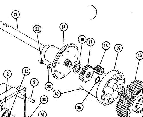

WHX?? 57,172 #40 Posted May 23, 2018 (edited) Ooooh Bob I'm too late... I was going to tell you Toro will be quite proud of theirs. I just got one from a member here for 30 and I know where there are some more for less than 50. Always check with members here first for parts. You might have been a little hasty as sometimes they are savable. If you haven't got the hub off you may want to brush up on some hub pulling threads here first. 6 hours ago, Bob Nakon said: don't know what's inside the transaxle Pretty simple actually, the business end of the axle is splined to a gear which is turned by the pinions. The only thing holding it from sliding out is a circlip which can be easily broke if the hub is pulled in a wrong manner. Heck I have shattered them just taking them on and off with the proper tool. Easy fix when you already have the tranny split for other work. Also should mention you may want to do another set screw for insurance, let us know if you need coaching with that. Simple but requires drill & tapping. Edited May 23, 2018 by WHX19 2 Share this post Link to post Share on other sites
Bob Nakon 55 #41 Posted May 23, 2018 As usual, my timing is impeccable...I could have got a BOGO for what I'm paying. Both hubs on my C120 have 2 lock screws but they must have loosened to cause this. The jam nuts were pretty tight too. Where did you find the drawing Jim? Bob Share this post Link to post Share on other sites
WHX?? 57,172 #42 Posted May 23, 2018 It's a screen snip from a 5XXX or mid 60's transmission repair manual Bob, You will have the 103907 tranny in yours but a 5060 is just an decade early one real close in design. The link Garry posted above has your correct manual & IPL in it. Share this post Link to post Share on other sites
