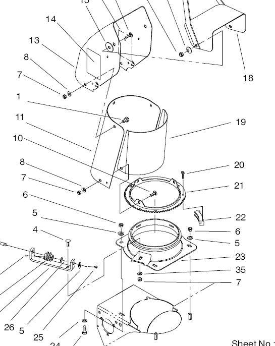

Jerzguy2 23 #1 Posted May 2, 2018 Simple question on a snowblower for a 300 series wheelhorse. I assume you can easily remove the shoot with a couple of bolt so it will fit in a car? Share this post Link to post Share on other sites
roadapples 6,987 #2 Posted May 2, 2018 Short answer, yes. Three 9/16 I think.... Share this post Link to post Share on other sites

WHX?? 58,307 #6 Posted May 2, 2018 (edited) 12 hours ago, roadapples said: Three 9/16 I think.... Four 9/16's ---- Pardon Apples he didn't have his shoes off when he counted! Maybe my pardon Jay ....were you meaning the three nylon blocks (#22) yes that there are 3 of and 3/8"s I think? Don't lose the blocks they are somewhat expensive for a piece of plastic. Edited May 2, 2018 by WHX17 lousy screen snip 1 Share this post Link to post Share on other sites

roadapples 6,987 #9 Posted May 2, 2018 @WHX17 I was referring to #7 nut and 9/16 wrench. Should have realized some of us need more specific instructions Guess now you're gonna' tell me there's three #7's in that diagram. So much for short answer.... 1 Share this post Link to post Share on other sites
WHX?? 58,307 #10 Posted May 2, 2018 I was thinking the #6 nut which there are four of.... five if you count the one going through my neck! 1 Share this post Link to post Share on other sites
