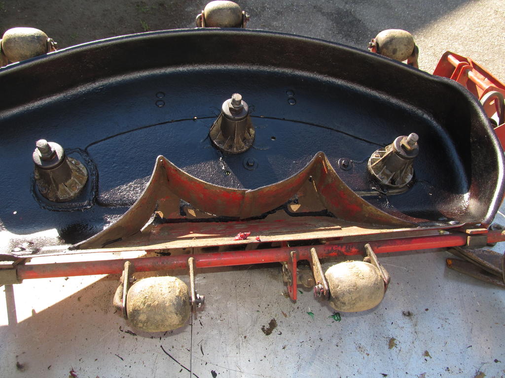

jeff lary 173 #1 Posted April 29, 2018 Just wondering,.. is there a consensus of what to use to protect the underside of your mower deck ? I have a 3-14-8 tractor (new to me last summer) and today just took the deck off today flipped it cleaned it and welded a few cracks up. I cleaned it very well putty knife , wire cup and wheel. Then I painted it with 3 coats of CRC Rust Converter. I have Fluid Film on hand that I can use,.. on my 3-12-8 deck I have used a 3-M Under Coating before that seems to work ok. Is there a better best product out there to try? Thanks for you opinion's,.. Jeff 1 Share this post Link to post Share on other sites

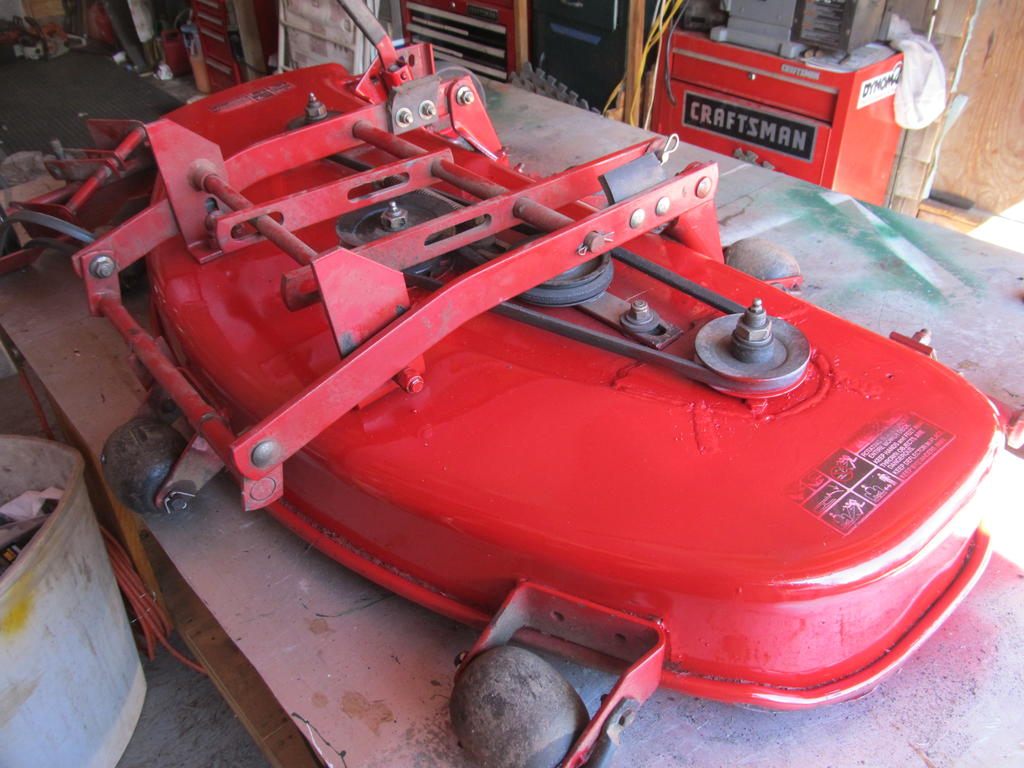

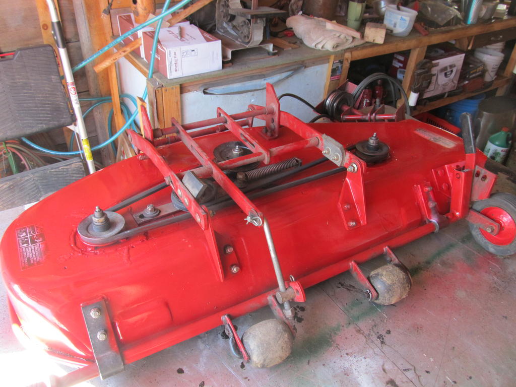

jeff lary 173 #12 Posted May 1, 2018 I agree, clean often and welI, I was really surprised how much heavier it is compared to my 37" deck on the 3/12/8. I had my son help me get it up onto a big rolling table I have. That way it was at least waist height to work on. Now I have to sharpen the blades and fluid film it up. I am thinking of hooking up the tiller and running it through the garden some before I put the deck on anyway. First I have to see if the boys mower is up to snuff to mow lawns while I have the tiller on. He bought an old yard man I think it is last summer. I rigged the 3/12/8 to keep the tiller on and the mower deck at the same time so maybe I will do the same with this 3/14/8. My original 3/12/8 is rigged for snow blowing with a cab so that one will stay that way. Share this post Link to post Share on other sites

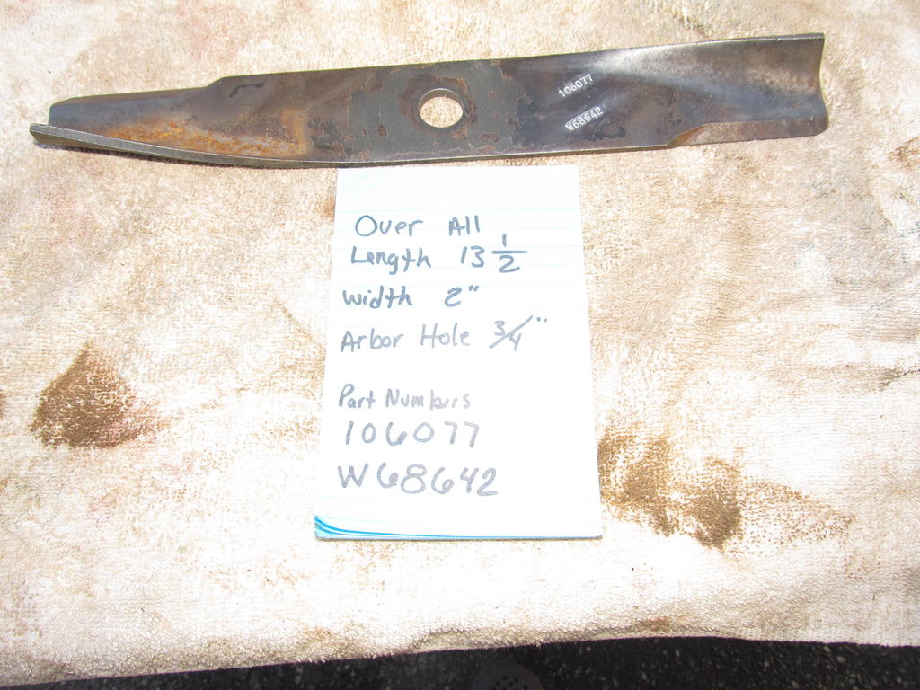

jeff lary 173 #15 Posted May 5, 2018 Well I finished up the deck this morning sharpened the blades primed and painted the welds and the rest of the deck. I coated the underside in Fluid Film then under coated the small area that in the photo still appears to be dirty ( after I took the photo). I took one picture of a blade while it is in good shape I recorded it's measurements for future reference. This deck does not have a Model or Serial decal on it so I figured knowing what the almost new blade looks like and measurements will be a help someday when I need new. After I finished that I went to the garden and pulled last years cornstalks and tomato vines. Then I came home and hooked up the tiller to the 3-14-8 while I had the deck off. I went back to the garden and gave it a tilling. I do however have a question on the low range selector. This tractor is new to me as of last summer and I have not used Low range before today. The tiller works best I think in low range 1st or 2nd gear. The issue is the low range lever keeps popping out into the neutral position between hi and low. The lever is at the absolute far left in the deck shift pattern cut out and cannot move further to the left like I think it should / needs to. What causes this? I generally never use low but tilling it's a must. I will till the garden maybe once or twice more then I will put the mower deck back on for the rest of the summer..I have a Cub Cadet rear tine tiller for the rest of the tilling as it is needed I am just wondering why it wants to pop out of low , not constantly but every pass in the first few feet it pops out then I put it back and most of the time it stays in till the next pass. The garden is maybe 100' long 40' wide. Share this post Link to post Share on other sites
