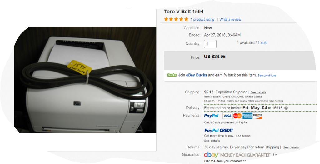

JoeBu 0 #3 Posted April 29, 2018 Maybe I'm confused is there only one belt. I bought this second hand and belt broke late last season. Putting it back together. I bought a 1594 V Belt. Share this post Link to post Share on other sites
1995 520H+96+97 939 #4 Posted April 29, 2018 1594 is the belt for a 48" mower deck. Share this post Link to post Share on other sites

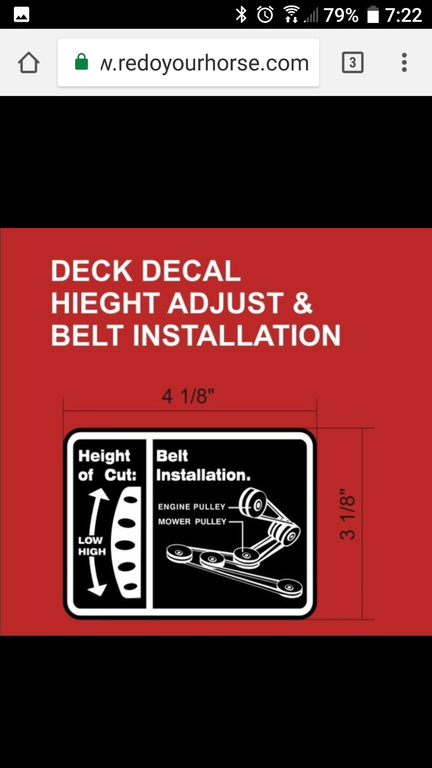

JoeBu 0 #5 Posted April 29, 2018 Is there a manual or diagram showing how the belt goes on correctly? Share this post Link to post Share on other sites

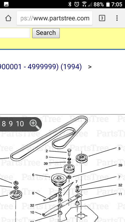

WVHillbilly520H 10,378 #6 Posted April 29, 2018 There "should" have been a decal on the deck with the belt routing, don't have any pics of my decks at the moment but here's the decal and parts breakdown for the spindle/blades, also the model of the deck itself will get you the correct owners manual you can download here for free my '96 48" deck is "78360" . Share this post Link to post Share on other sites
