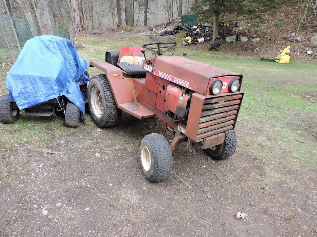

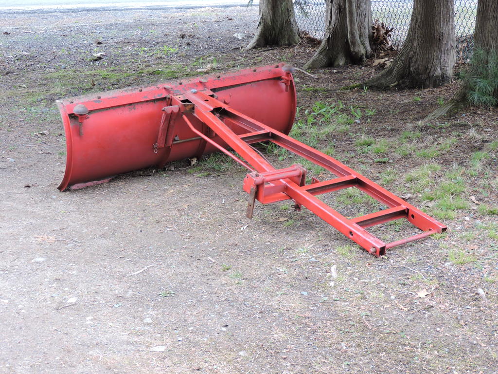

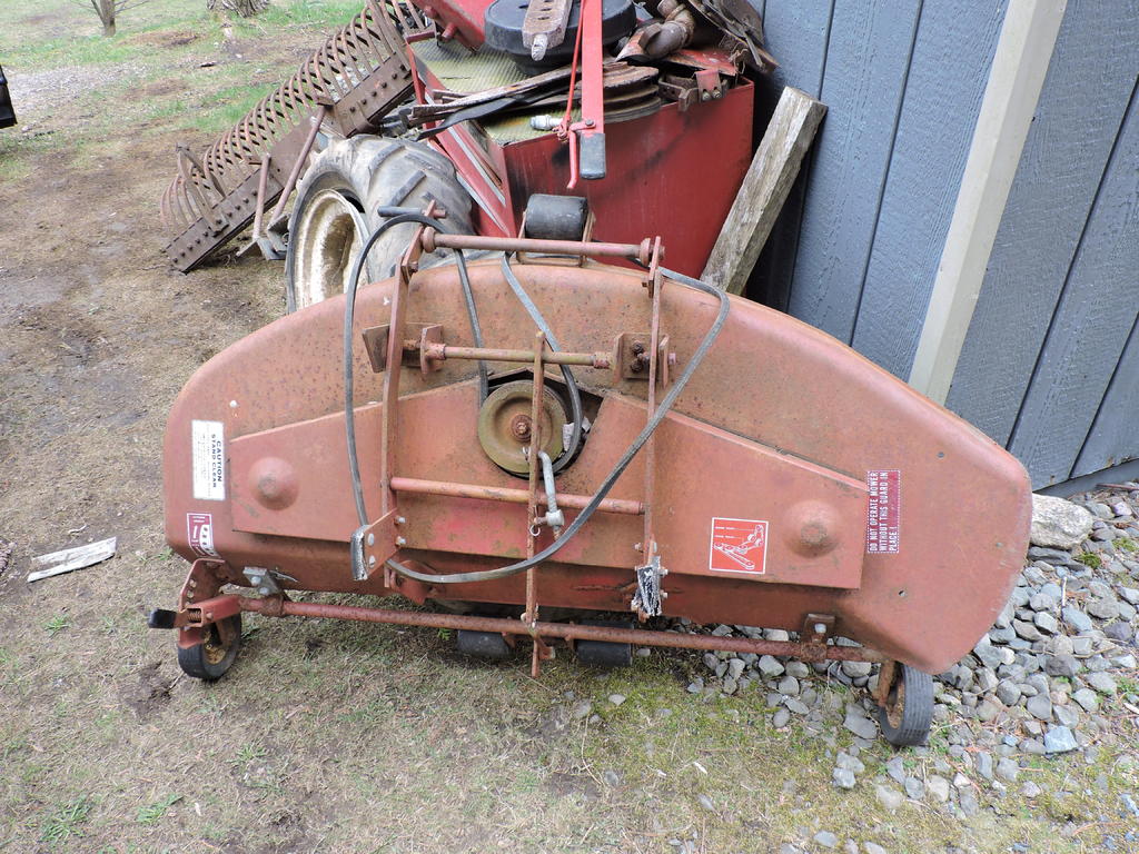

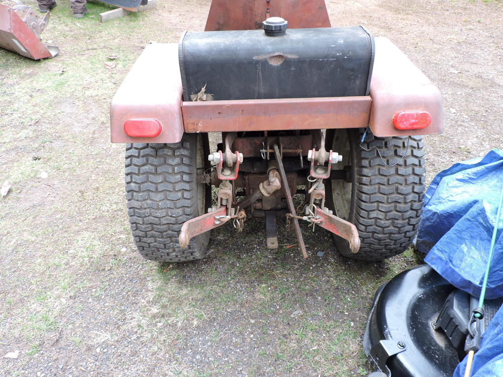

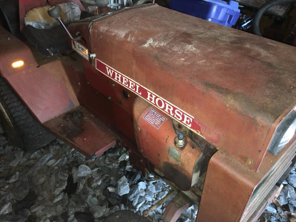

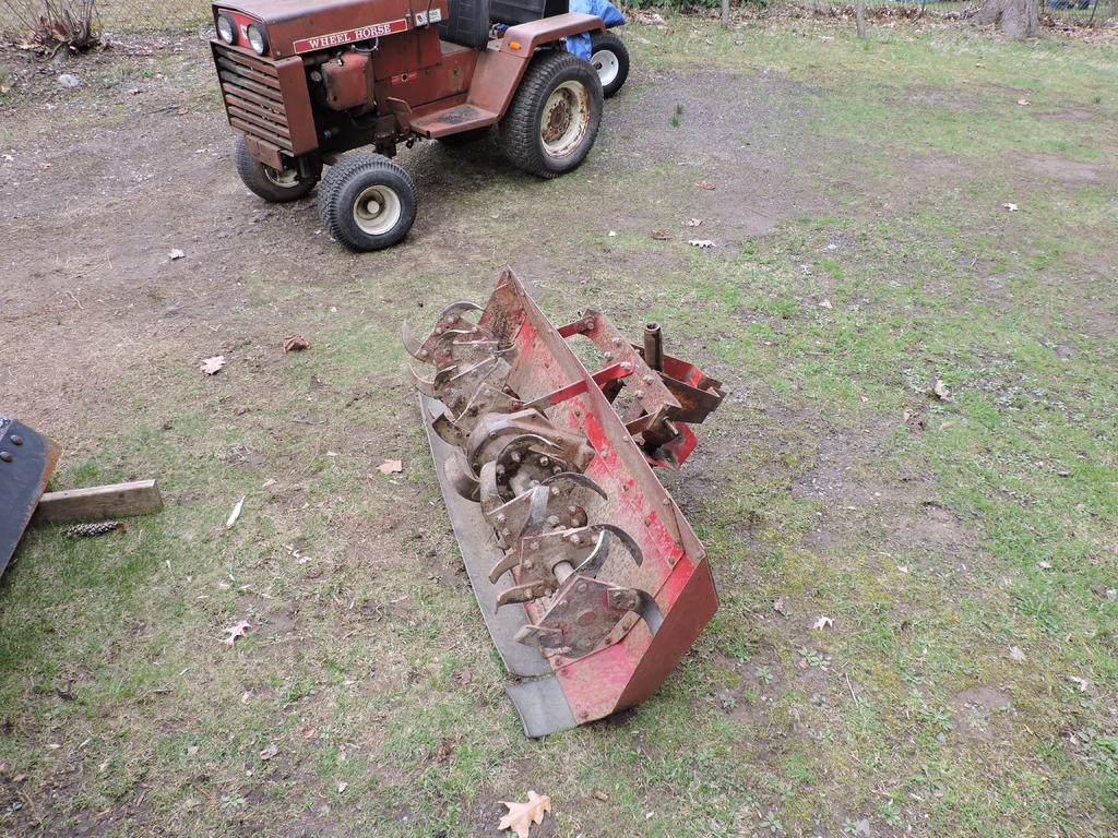

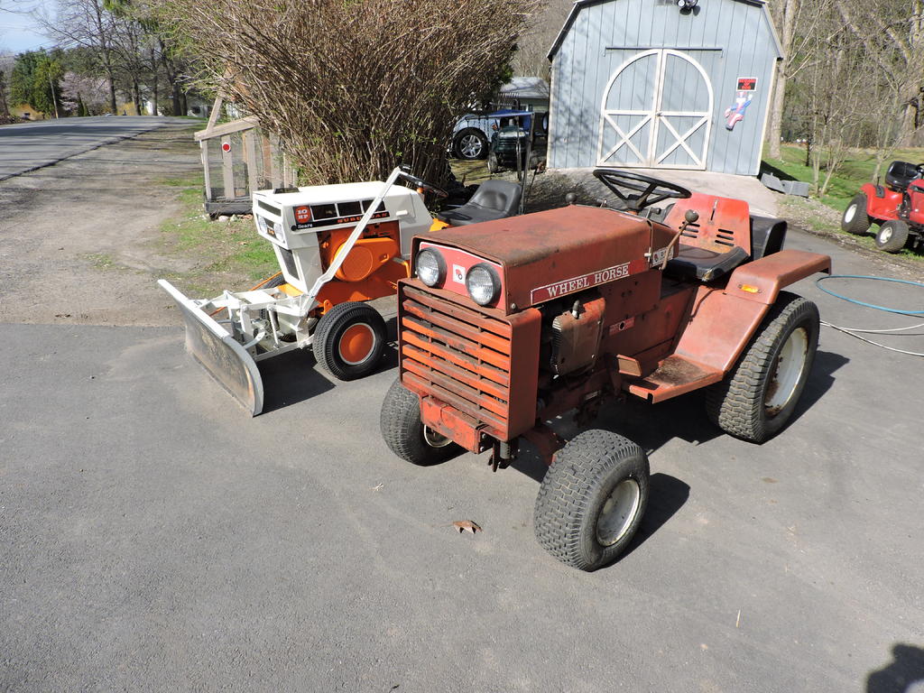

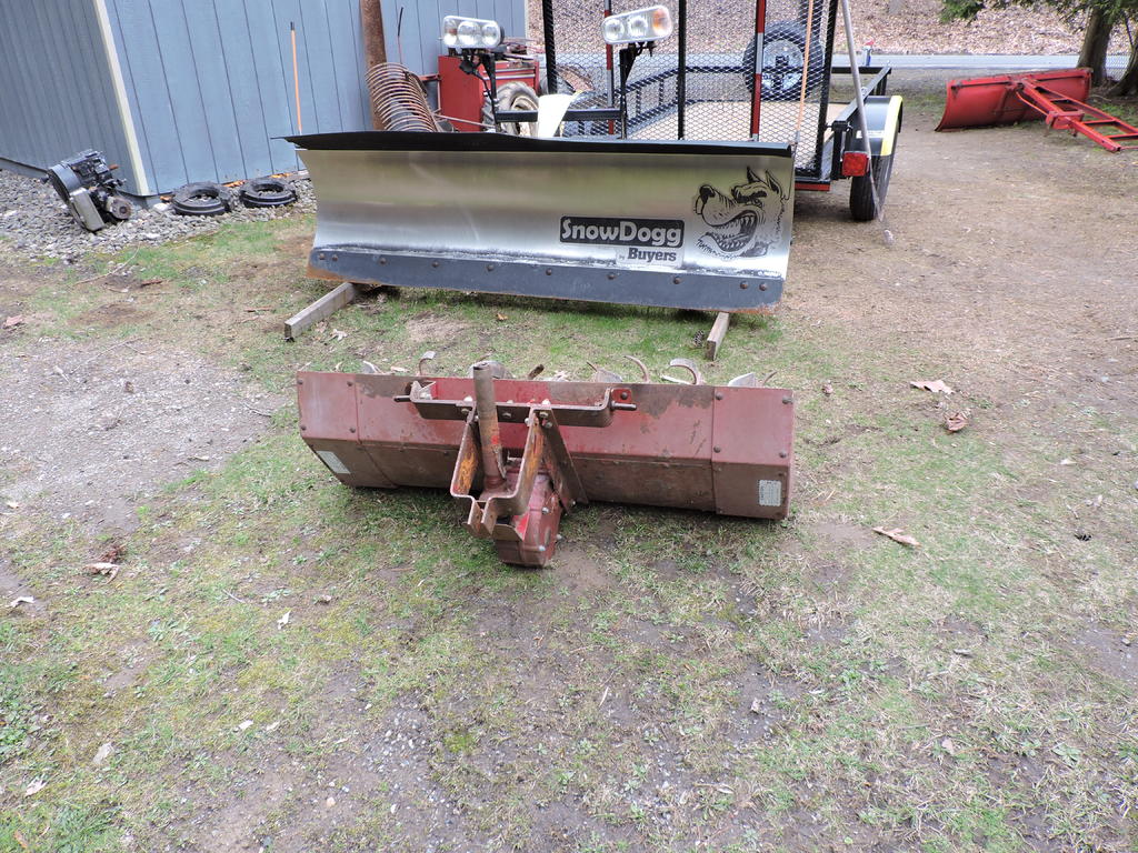

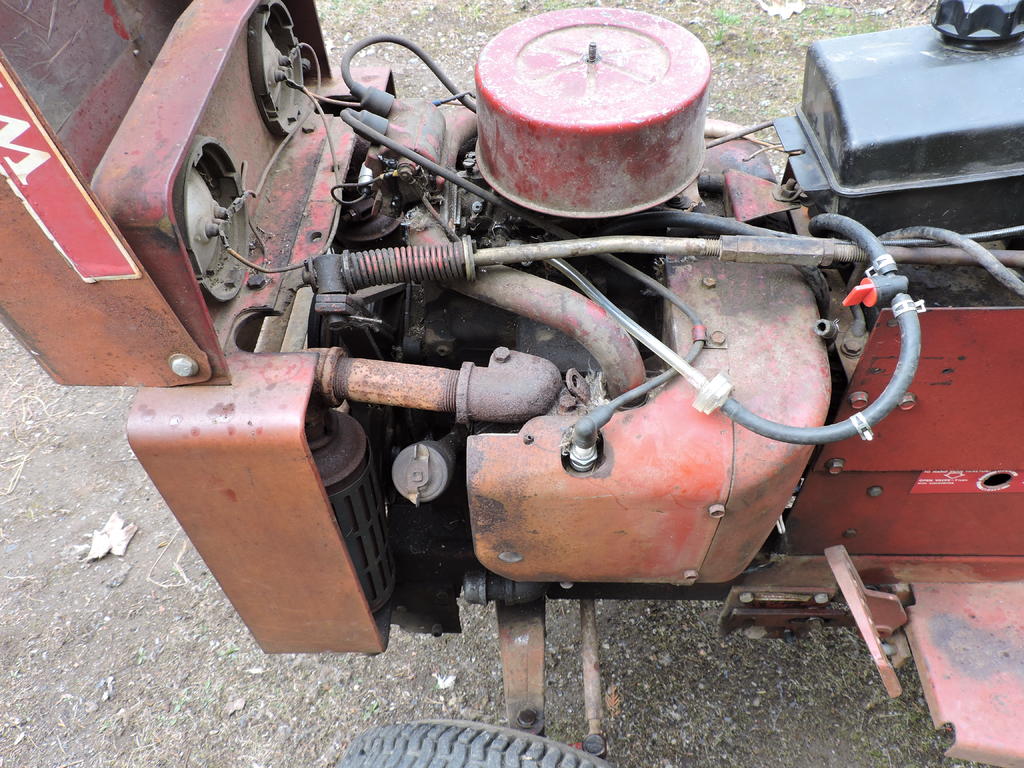

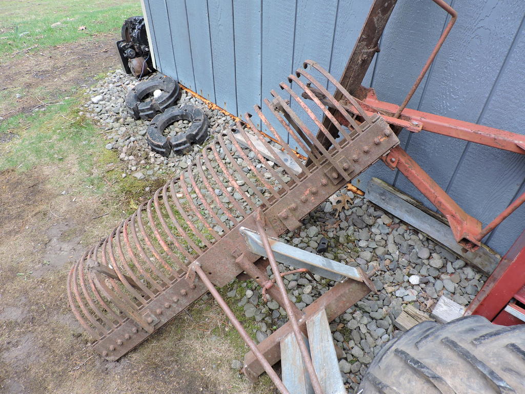

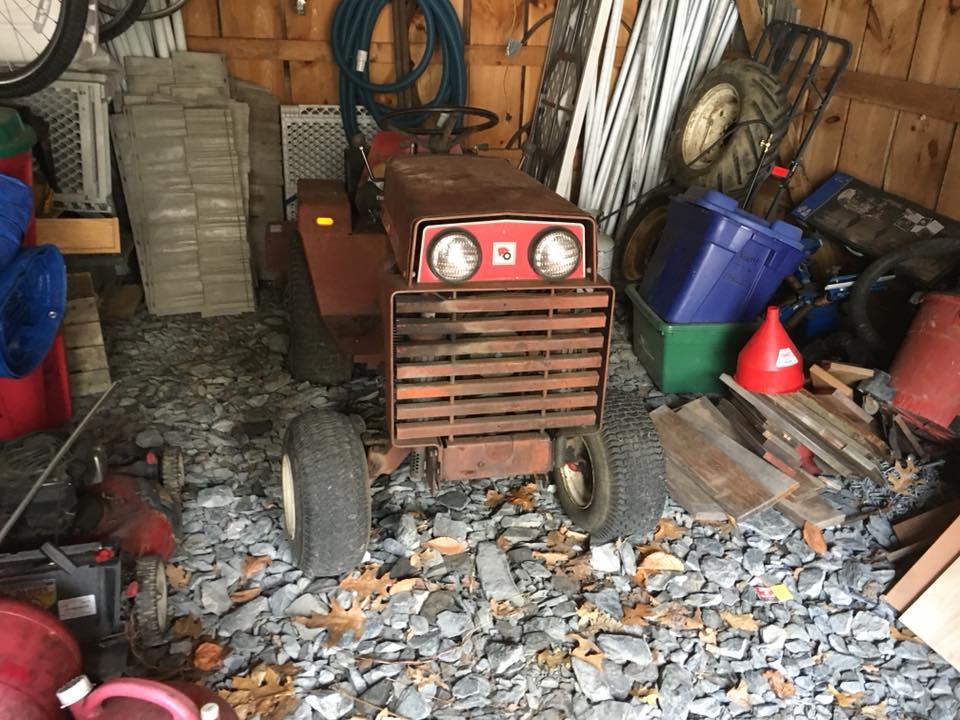

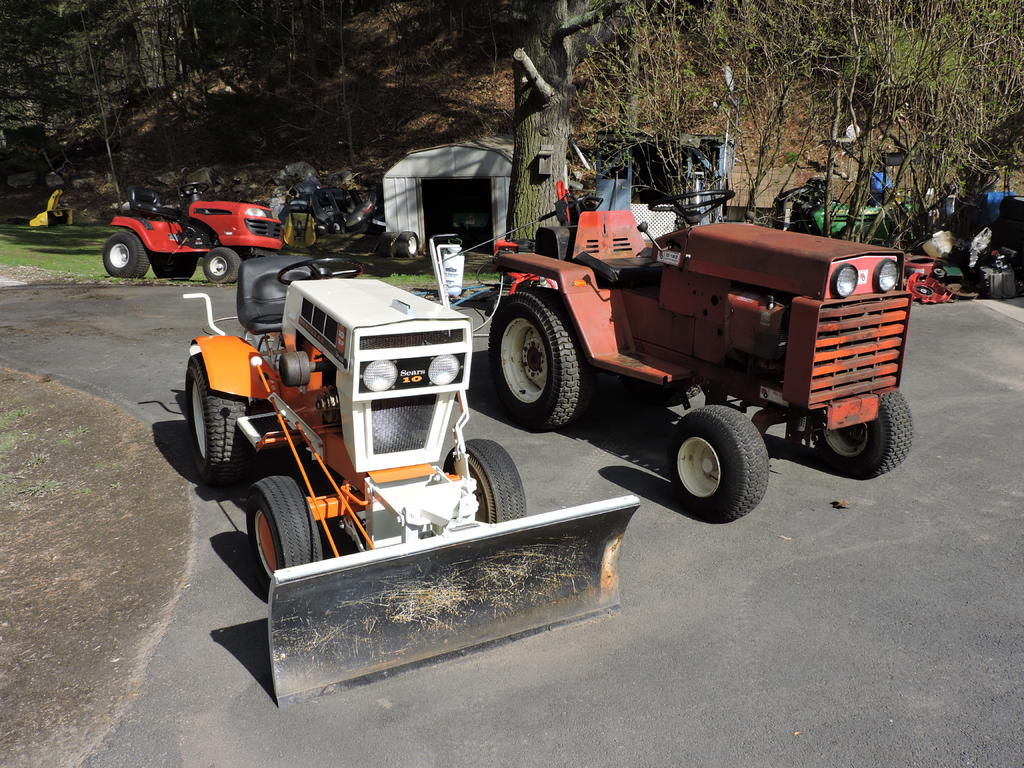

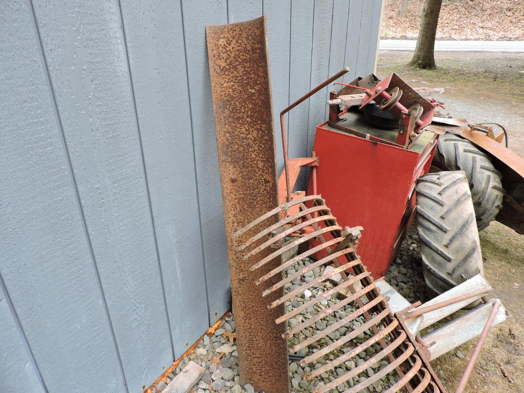

ericjr16 125 #1 Posted April 29, 2018 Hello everyone. I had to sell my C85 a while ago and had not found another Wheelhorse to ad to the fleet till yesterday. I found a fellow giving away a Murray tractor, got it for our flip hobby. While there the guy asked if I'd be interested in a Wheelhorse. Told him lets see it. He moves a tractor to show a D-180! I never saw one in person and it is impressive! He has a ton of attachments for it as well, snowplow, roto tiller a rock rake and guess a rear plow, wheel weights and chains and spare tires! He says make me a offer and I have no idea and don't want to tick him off. I ask him what he would take and he says $500! I told him I can get $450 cash today and he said sure! Going this morning to get it. It doesn't run right now but hoping a fresh battery and fuel will get it to move. Going to be fun loading it as it sure looks heavy. I can't do much anymore with three herniated discs so hoping the fellows skid steer will do it! 14 1 Share this post Link to post Share on other sites
Rock farmer 43 #2 Posted April 29, 2018 Looks to be in good shape for its age! id say that’s a good deal! joe 1 Share this post Link to post Share on other sites
AMC RULES 37,254 #3 Posted April 29, 2018 Sure looks like it's gonna clean up nice. Good luck with it. 1 Share this post Link to post Share on other sites
Tankman 3,528 #4 Posted April 29, 2018 29 minutes ago, AMC RULES said: Sure looks like it's gonna clean up nice. Good luck with it. Looks great! 1 Share this post Link to post Share on other sites
ericjr16 125 #5 Posted April 29, 2018 Thanks guys! I only took these pictures as I wasn't sure what the guy would think. I'll update you all when I settle in tonight. Going to be big morning. Might have to make multiple trips depending on room. 1 Share this post Link to post Share on other sites
WHX?? 54,517 #6 Posted April 29, 2018 The D's are beast and ther would be one in my herd for that price. Good luck with her and keep us posted on your progress with it! 2 Share this post Link to post Share on other sites
RandyLittrell 3,943 #7 Posted April 29, 2018 For what you paid for tractor and equipment, even if you had to put a motor in it, you did good! I like the Horses more and more verses my cubs. I will always have cubs, but before long I will have as many horses as cubs! Randy 2 Share this post Link to post Share on other sites

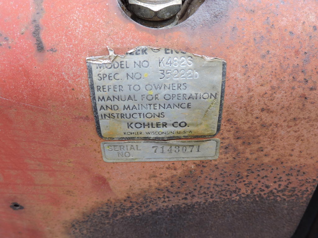

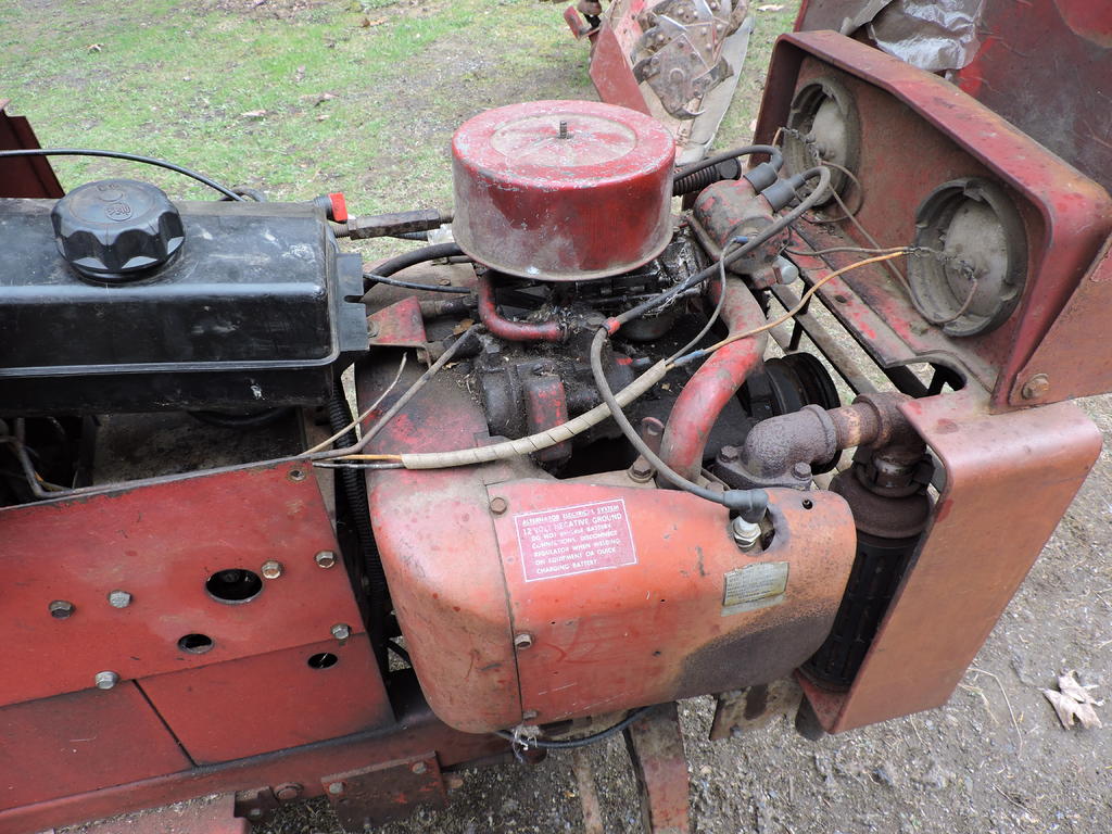

953 nut 63,957 #8 Posted April 29, 2018 That looks like Kohler twin engine, great power plant. Be sure to open the "Tow Valve" before attempting to move it. 1 Share this post Link to post Share on other sites

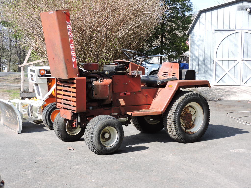

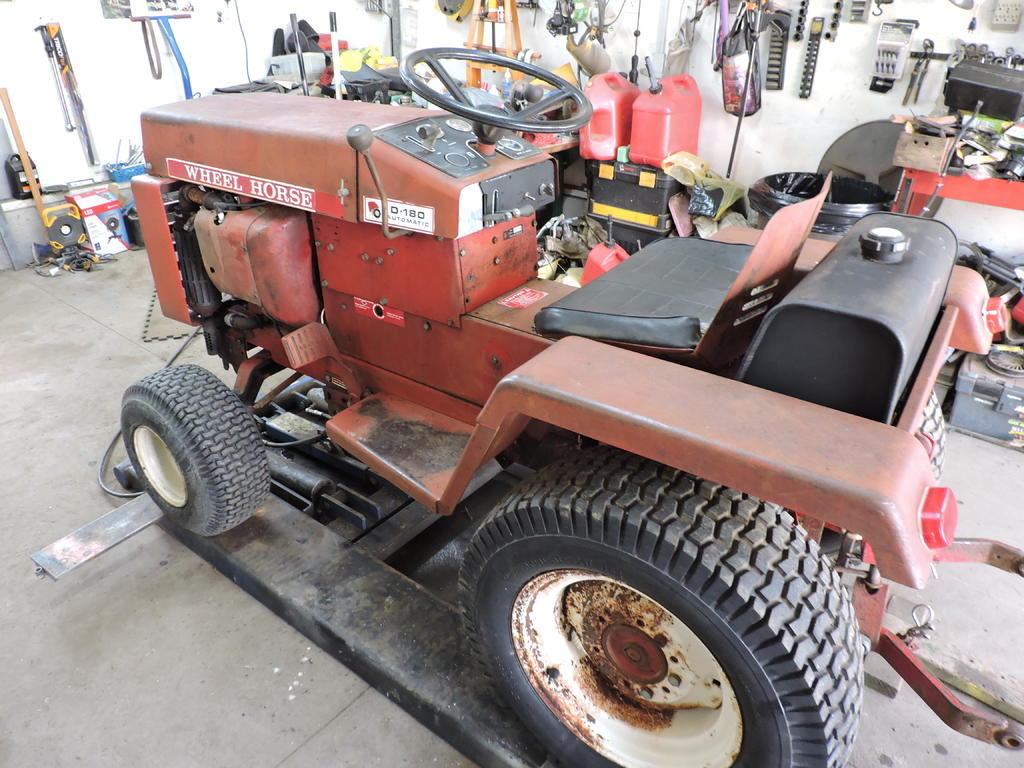

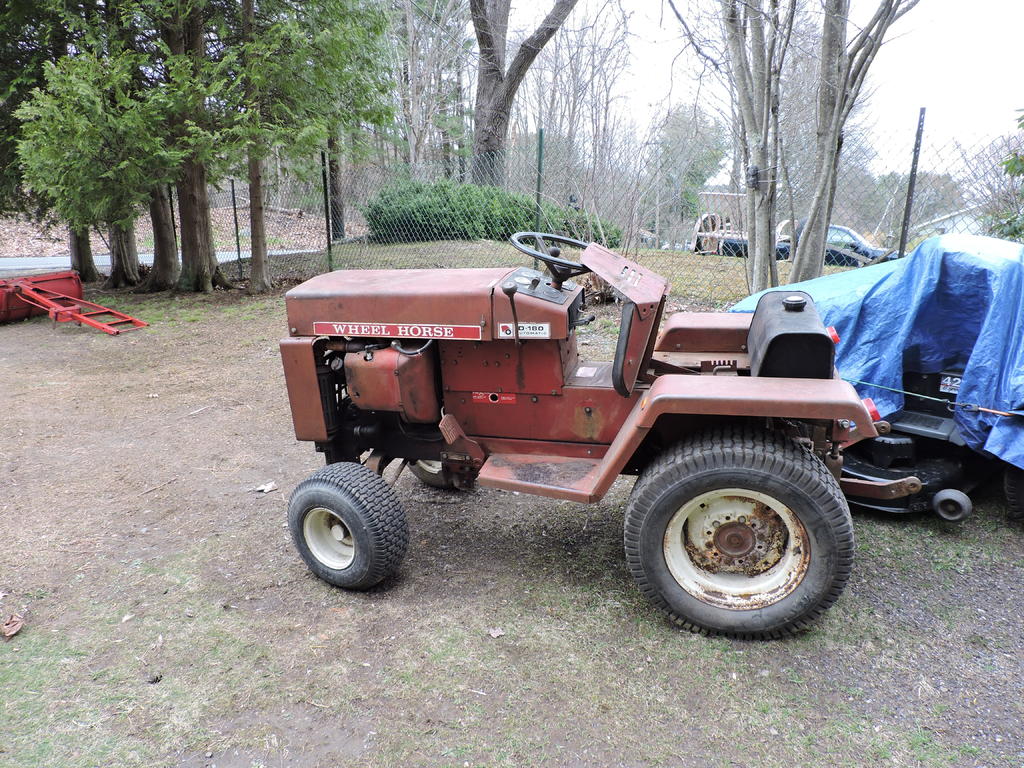

ericjr16 125 #9 Posted April 29, 2018 Thanks guys! I did download owners manual and saw tow valve. We had heck of a time loading as guys skid steer wouldnt start. Had to struggle to load tractor as it wouldnt fire or crank with key there. Turned out we flooded it there and safety switches stuck. Once home we cleaned plugs and it fired and ran great! Huge mouse nest in tins so kept it short. Turned bypass back after it sat and restarted it. The hydraulics work and it moves. The tiller was packed with hay and took a hour to clear. Had to remove it to load the tractor. Plans are to clean it tommorrow and replace fuel line and tank shut off. 3 4 Share this post Link to post Share on other sites

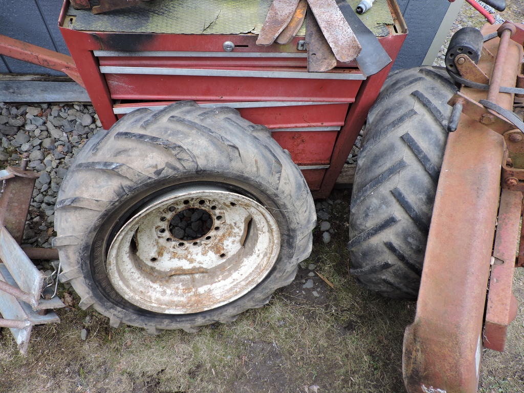

WHX?? 54,517 #12 Posted April 30, 2018 Your name looks better in RED Eric... Speaking of the color that is a fine pile of red for the money...you did real well! Ags look to be serviceable & extra set of rims, ...3 pt hitch! 3 Share this post Link to post Share on other sites

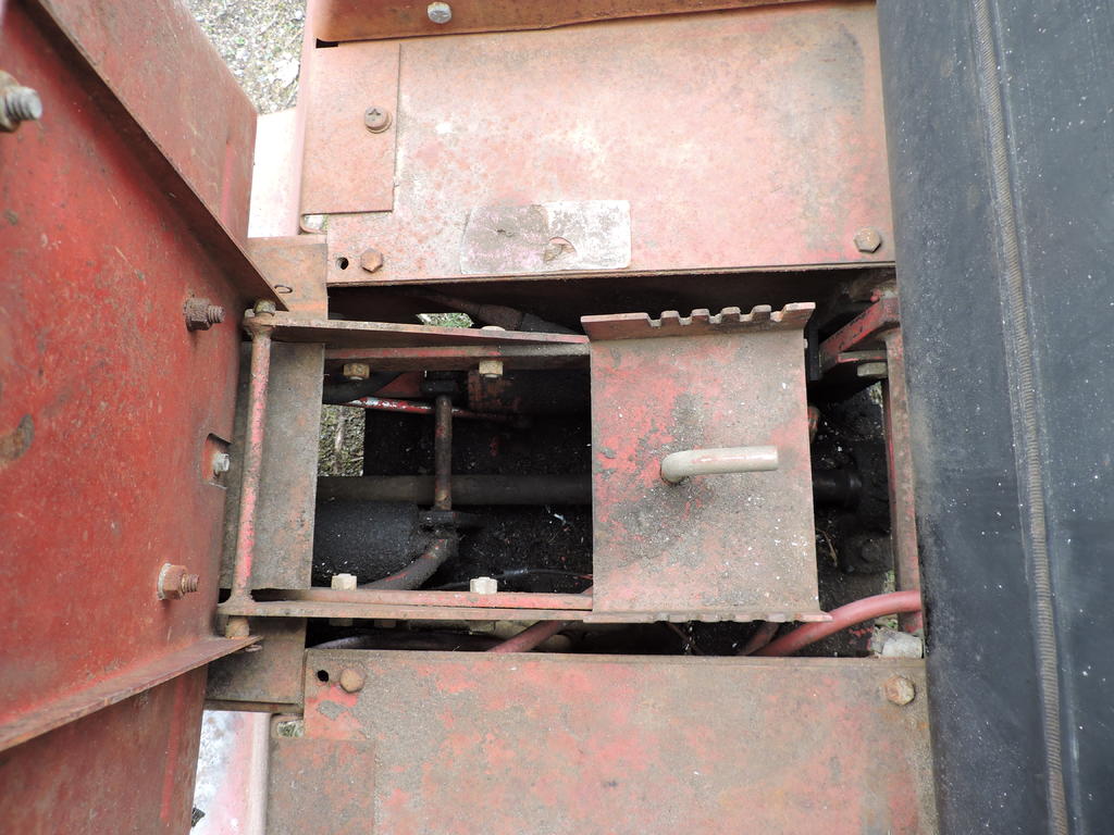

ericjr16 125 #14 Posted May 1, 2018 Well got on it today. Took side panel and console cover off to replace fuel line and clean negative cable. Washed all the grease off and decals broke/blew off hood. Will be ordering new ones. Fixed the positive cable and fired it up. The starter lead is acting up, tried to remove but to the feeling of it possibly breaking stud. Might take it to auto electric shop that rebuilt my Sears Suburban generator. This thing is weird to drive!! So much bigger than my Suburban. The shifter is sloppy, I adjusted friction but but seems like a bushing is bad. Also no brake action really? Where is the adjustment for parking brake? Any help from you guys would be appreciated. I didn’t find info in owners manual I downloaded. 1 Share this post Link to post Share on other sites

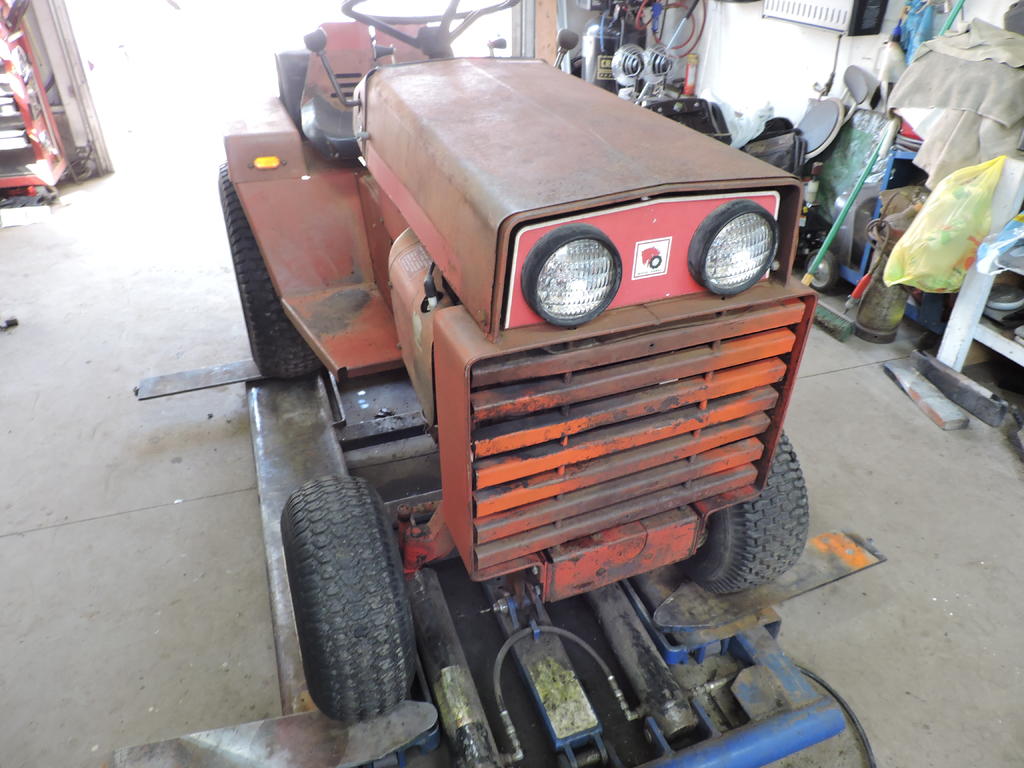

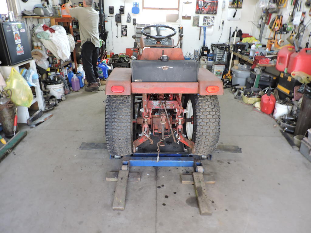

ericjr16 125 #17 Posted May 2, 2018 2 hours ago, classiccat said: Sheesh... that BigD needs its own zip code Eric!! Does it even fit on your lift? Actually BARELY!! Only lifted it a little due to fear of falling off! We got all new fuel line from tank to pump and then to carb, with filter and a shut-off close to carb for my back instead of using the tank mounted one I replaced. Here is a video of its first drive with fuel setup done. All the lights work after some wiring repair and checking the bulb. 2 Share this post Link to post Share on other sites

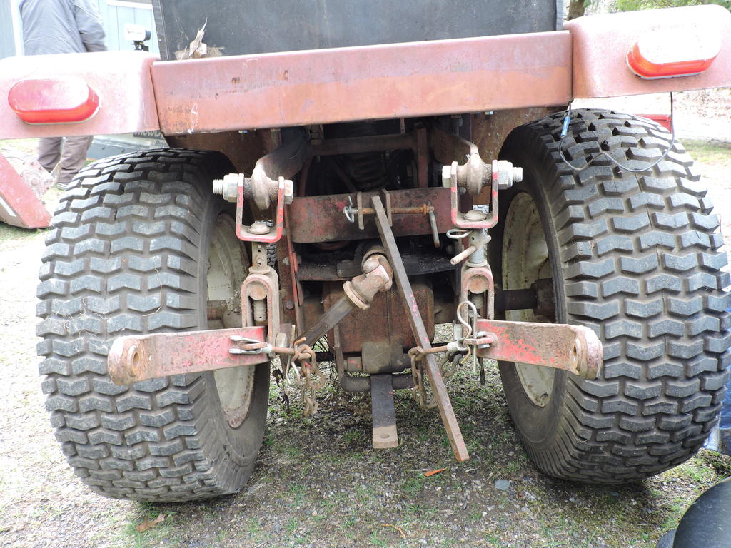

ericjr16 125 #19 Posted May 4, 2018 Hey guys a question on the shifter. Any known wear items common on the shift linkage? It sure is vague. I need to look up the parts manual in the forum library( BTW very helpful to me!!) Share this post Link to post Share on other sites
ACman 7,686 #20 Posted May 4, 2018 (edited) Eric can’t help you with your problem but what a score ! Congrats .... and is that a mid mount grader that came with your D too. Yes having your name in red sure does make things easier and I’m sure someone soon will be by to help you out. Maybe @Sarge has some ideas. Edited May 4, 2018 by ACman 1 Share this post Link to post Share on other sites
ericjr16 125 #21 Posted May 4, 2018 8 minutes ago, ACman said: Eric can’t help you with your problem but what a score ! Congrats .... and is that a mid mount grader that came with your D too. Yes having your name in red sure does make things easier and I’m sure someone soon will be by to help you out. Maybe @Sarge has some ideas. Thanks man! I just printed the hydro manual on adjusting the linkage! Hope this gets me in ball park! 1 Share this post Link to post Share on other sites
Sarge 3,470 #22 Posted May 6, 2018 The biggest wear areas I found on mine are the main handle's pivot point, the fork that allows that handle to move between forward/reverse, and especially the linkage rod ends that go between the direction handle and the pump itself. It took a lot of work to get the slop out of all of that linkage and balance it to work with the parking brake and not fight itself or damage the pump/motor. Make certain when going through the drawings you are looking at the right version - I think there are 4 different variations. I had to take mine completely apart and repair or make a few new parts - took some time but it works well now. The biggest concern is always the pump coupling/pump splines - keep an eye on it. Lack of braking action points to wear in the pump's pistons and plate as well as the hydraulic motor's parts. Sarge 1 Share this post Link to post Share on other sites
