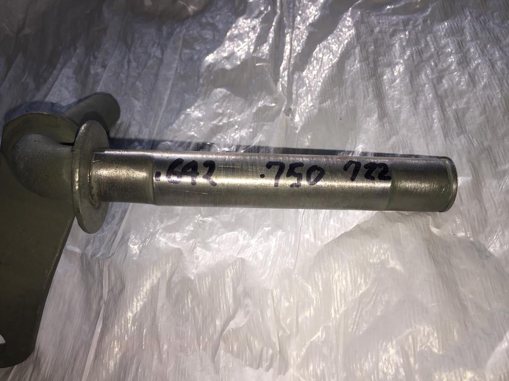

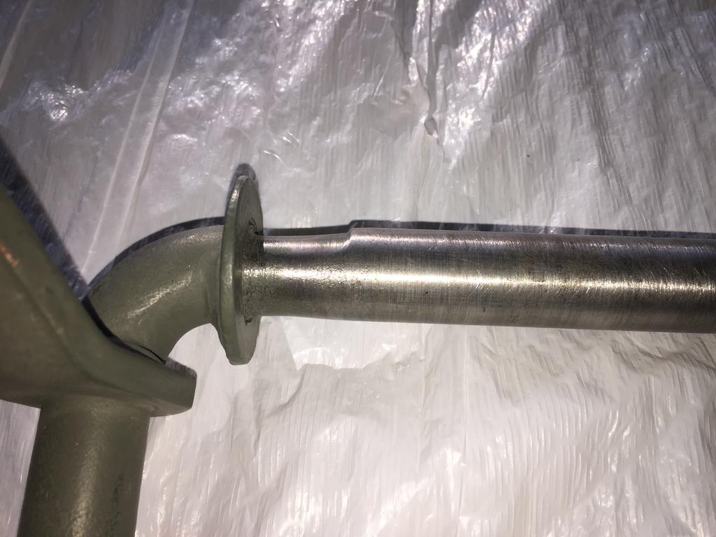

oliver2-44 11,376 #1 Posted April 28, 2018 I have a set of Suburban front spin falls that have excessive wear from the old cast iron split bearings The bottom of the inner bearing are measures about 0.642 and the outer 0.722. So 0.108 and 0.028 wear. Any suggestions how to repair or compensate for this? Some ideas I’m kicking around are: 1. Degrease and blast the worn area to get a profile then build it up with JB weld or Lab metal. Maybe use a piece of 3/4” pvc pipe as a mold them file/sand to size so modern flanged bearings fit 2 I have some scraps of plastic looking lube free round stock. I could have some longer split bearings machined to ride on the unworn areas. 3. Make a stack up of something like a lock collar (in the worn area) a non flanged bearing a tubing spacer, then the outer bearing nonflanged and another lock collar. This would get bearings onto unworn area of spindle, but at a narrower support width. I,m interested in what y’all have done, or comments on the ideas I’ve thrown out Thanks in advance! Share this post Link to post Share on other sites
