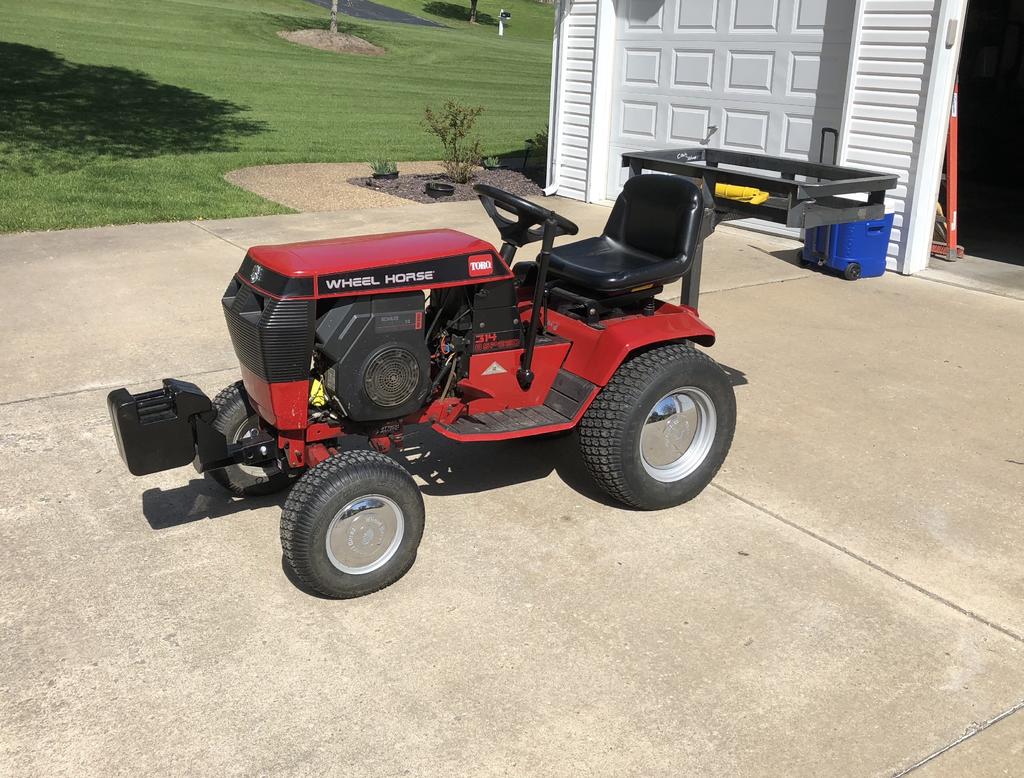

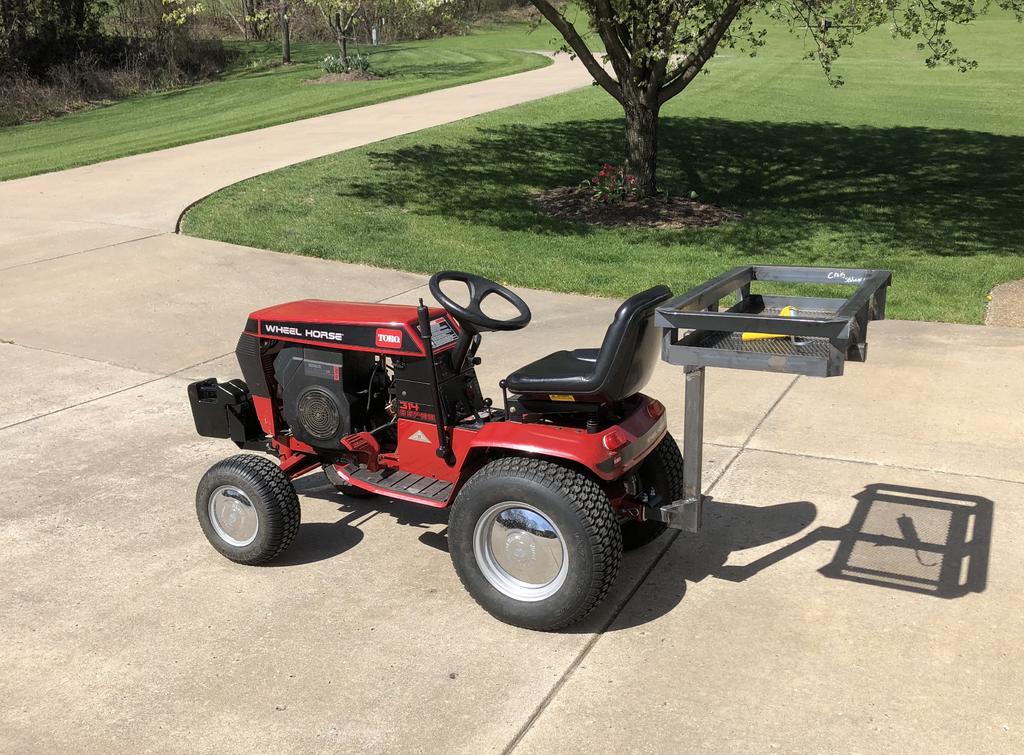

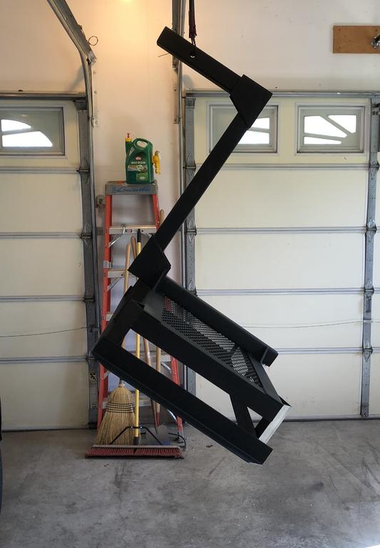

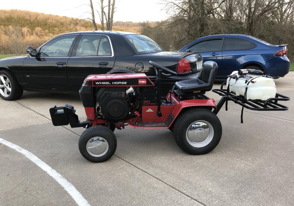

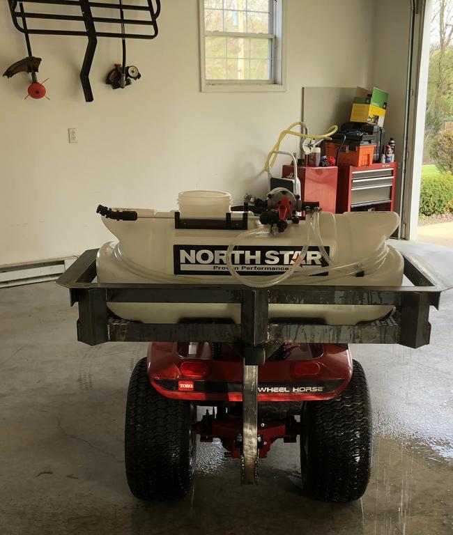

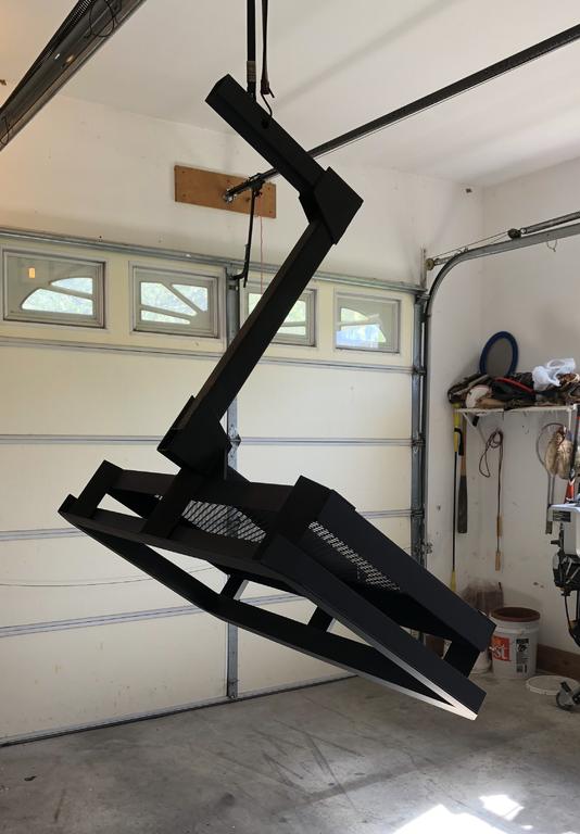

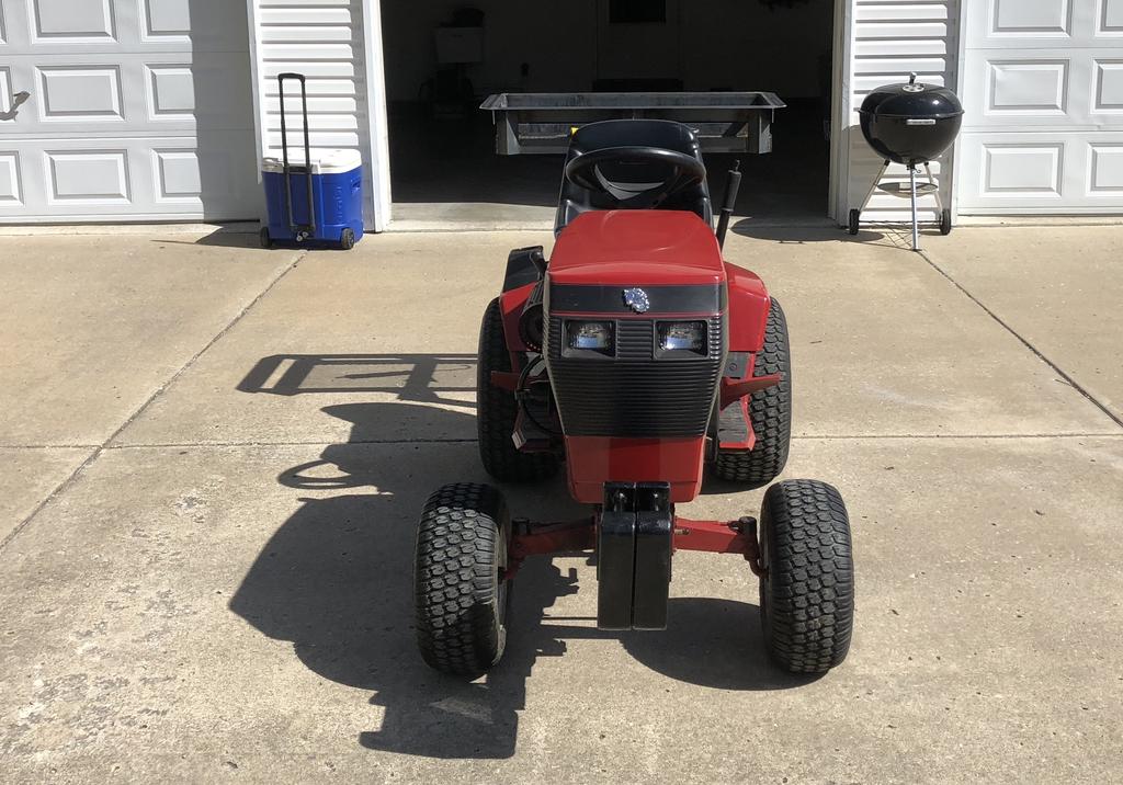

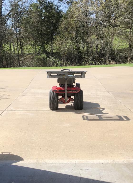

cschannuth 3,821 #1 Posted April 27, 2018 I’ve posted pics of my spray setup before and I’ve never been happy with it. The sprayer is great but my father-in-laws carryall was too low and too big to spray effectively. It was so low that the spray width was only about 7’ wide when it hit the ground. Needless to say, I had to run at top speed to avoid using way too much product. That was hard on the tractor with all the weight and still applied too much product. To to remedy that I built my own carrier. Now it’s higher and tighter to the tractor and the spray width is almost 14’ wide. I used it last night and it worked much better. Plus, I was able to slow down to 2nd gear Hi range and I used about half the weed killer I used to use while getting good coverage. I plan to use this for other chores too. Time for final paint and it’ll be done. 6 5 Share this post Link to post Share on other sites

ohiofarmer 3,516 #6 Posted April 28, 2018 As far as controlling how much product you are using, you could add a pressure regulator to the main spray line. Or just add a t fitting with a ball valvewith a return line back to the tank. A third is to just add water and use less product in the mix. We just use a catch bottle on one spray nozzle and make our calculations from that 1 Share this post Link to post Share on other sites
cschannuth 3,821 #7 Posted April 28, 2018 11 minutes ago, ohiofarmer said: As far as controlling how much product you are using, you could add a pressure regulator to the main spray line. Or just add a t fitting with a ball valvewith a return line back to the tank. A third is to just add water and use less product in the mix. We just use a catch bottle on one spray nozzle and make our calculations from that Those ideas make too much sense and are all way too logical and wouldn't have let me justify a night in the shop to weld this thing up...LOL... 1 Share this post Link to post Share on other sites
