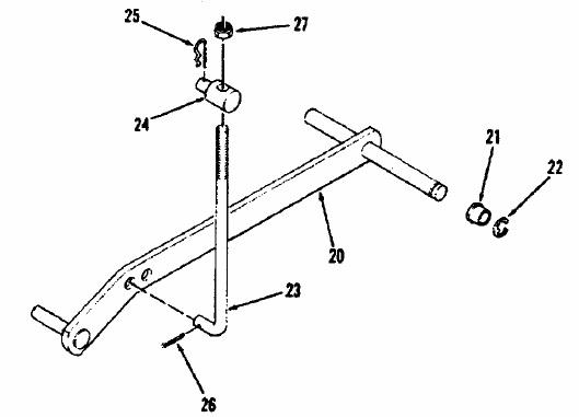

Joshn569 273 #1 Posted April 27, 2018 Will a c series (or some other model) t bar work on a raider? Share this post Link to post Share on other sites
gwest_ca-(File Mod) 12,260 #2 Posted April 27, 2018 This T-bar? Garry Share this post Link to post Share on other sites

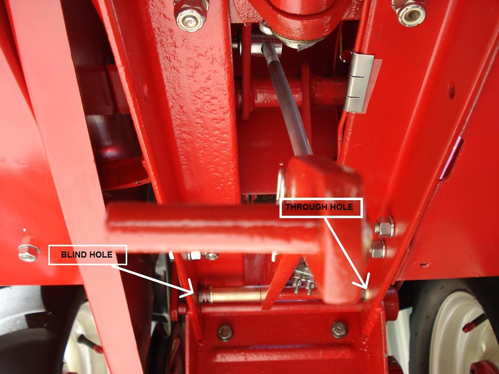

Anglo Traction 761 #4 Posted April 28, 2018 Hi, if this is for your Raider Resto project (great work by the way), then you have a short frame on a '68'. The frame will not be drilled each side near the Tranny Plate. The drive Belt side has a 'Blind hole' and the Deck Lift lever side has a 'Through hole' that carries a bushing. Here's a pic that may help- The blind hole side could be adapted by adding a thick bored plate to the inside of the frame, as there is space (ignore the copper tube/spring etc, it's my Mod to seal grease in the blind hole). Through hole will need drilling out for the bushing. I believe the longer frame length was added at the front, so the distances at the back of the frame should accommodate the Lift Rod etc?. Share this post Link to post Share on other sites
Joshn569 273 #5 Posted April 28, 2018 9 hours ago, Anglo Traction said: Hi, if this is for your Raider Resto project (great work by the way), then you have a short frame on a '68'. The frame will not be drilled each side near the Tranny Plate. The drive Belt side has a 'Blind hole' and the Deck Lift lever side has a 'Through hole' that carries a bushing. Here's a pic that may help- The blind hole side could be adapted by adding a thick bored plate to the inside of the frame, as there is space (ignore the copper tube/spring etc, it's my Mod to seal grease in the blind hole). Through hole will need drilling out for the bushing. I believe the longer frame length was added at the front, so the distances at the back of the frame should accommodate the Lift Rod etc?. Yes it is. And thank you. I figured I was going to have to drill holes. There are a few for sale on ebay pretty cheap for other tractors complete with the bush. Think I will pick one up. Thanks for the pic 👍 Share this post Link to post Share on other sites
