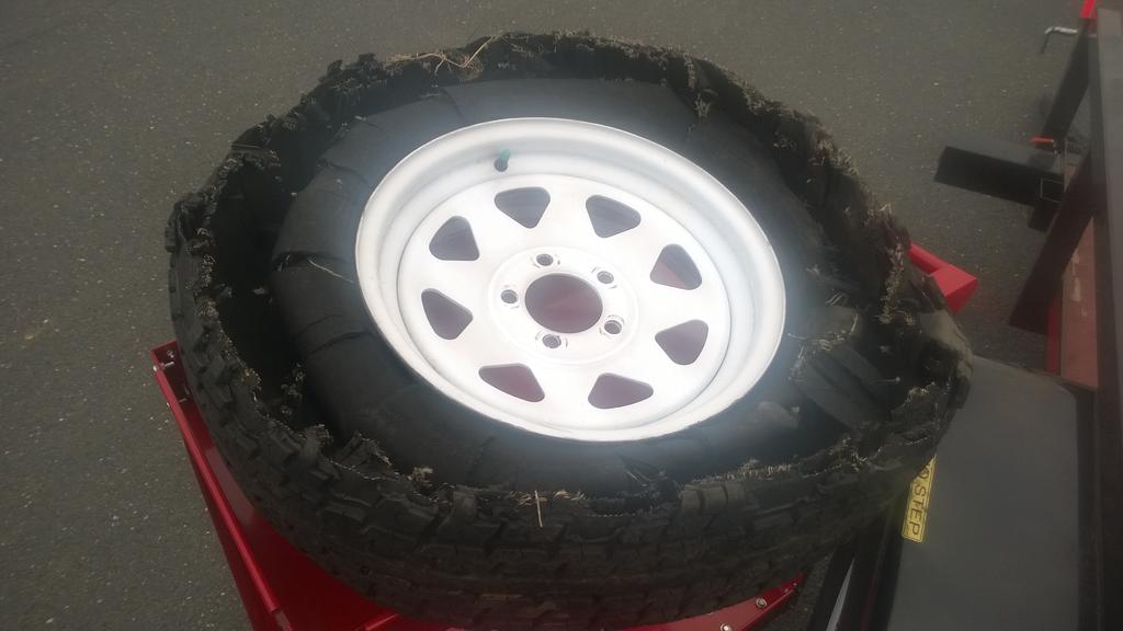

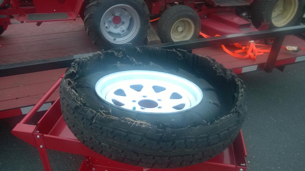

shallowwatersailor 3,220 #1 Posted April 27, 2018 This past Sunday I ran the first of the equipment to the new house. A trip that normally is just under four hours took 6-1/2. A little over half way down, I had a blowout on the trailer, luckily, on the right side. No, I never bought a spare and actually I will be selling this trailer due to the new house's HOA storage rules. I gambled with the fact that I would be selling the trailer than buying a spare. I probably had about 500-600 miles on these tires but they were three years old and stored in the shade. No curbing or rough handling to break a cord. Before we left I checked them out and were at the correct pressure. It was only the weight of two Black Hoods and a 48" SD deck. We had been driving about 1-1/2 hours driving at around 55 mph +/- and then had been on I-81 for about 25 miles. Of course the blowout occurred between an exit and entrance ramp, and was dicey with all the traffic passing at 70-80 mph. Luckily Mrs. Sailor was following in her car so she stayed with the truck while I ran down the road to the local TSC for another tire and wheel. It is a Kenda Loadstar, also Chinese. After that it was off the interstate and then took the back roads the remaining way. The trailer got left at the new house as I traveled back alone with our dog and didn't want to have another incident, even though it would be hauled empty. After getting back to MD, I have been researching trailer tires, I have found that Goodyear has a trailer tire made in the USA called the Endurance. It will cost about a third more for two (I don't even want to consider using the remaining Constancy tire) even though I will be selling the trailer. Anyone have feedback on the Goodyear Endurance tire? 3 Share this post Link to post Share on other sites

clueless 3,347 #11 Posted April 28, 2018 4 hours ago, shallowwatersailor said: The original tires are Load Range C and correct pressure is 50 PSI. I am not sure if the Constancy Brand are speed-rated but I kept it at around 55 mph. Most trailer tires in the 205/75R15 size are rated to 65 mph. The trailer, according to mfr. spec, is 990 pounds with a GVWR of 2,990 pounds. That leaves 2,000 pounds for a load. I figure the two tractors and one deck at no more than 1.400 pounds. Even though it won't increase the carrying capacity and they would be more expensive, I am looking at Load Range D tires with a speed rating higher than 65 mph. That way I can use a tire that would be understressed with my type of load. Sidewall blow out for sure. I have a friend who runs a local U-Haul business, a couple of years ago I asked him about what type of tire they use on their trailers. He said the used Goodyear for years, they were specifically made for them. Then when Goodyear merged they discontinued that line, they now use Carlisle. He said sidewall blow out is the biggest problem with trailer tires, people put truck tires on trailers thinking if their made for a truck they should work just fine on a trailer. Truck tires are designed for a truck that has suspension, shocks, struts, and sway bars. On most smaller trailers used to haul 3000#s or less the tire is the suspension, trailers with a single axle have a lot more up and down (bouncing) and swaying going on at high speeds than a double axle trailer. This creates a lot of heat, to much and something has to give, usually the weakest link, the side wall. He said there are a lot of trailer tires out there some really good, some good and a lot of bad ones. U-Haul does a lot of testing when it comes to their trailers, they wouldn't use Carlisle if they didn't work best for them, think liability. They use Carlisle trailer tires ST, Bias, 4ply, load range D. He also said that a trailer with a lighter load, can cause a blow out more then one with a heavier load, more bouncing at speed. Your tire is your shock absorber on most light weight trailers, at highway speeds while not noticeable, the trailer is constantly bouncing and swaying, a lot of heat builds up, Boom . OOPS, I think I already said that, time to go do something else. 4 Share this post Link to post Share on other sites

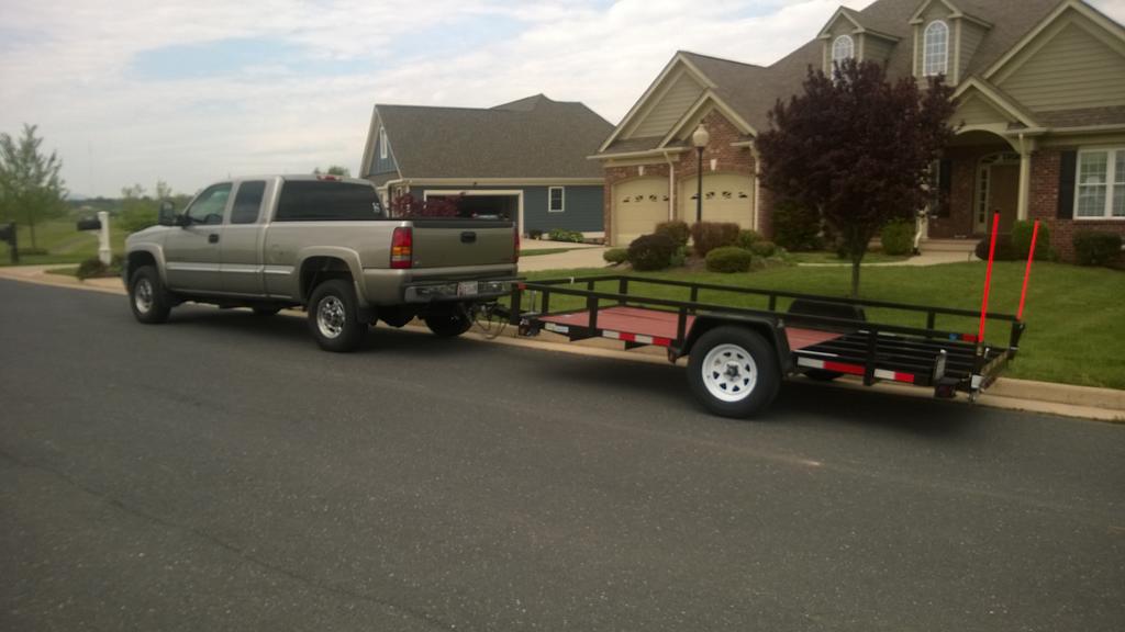

shallowwatersailor 3,220 #13 Posted May 5, 2018 (edited) A followup on replacing my trailer tires. So Iwouldn't waste a trip with hauling equipment, I rented a U-Haul trailer one way to go and retrieve my trailer at the new house. I worked with a local independent tire dealer in our new city who was able to get two Goodyear Endurance tires from his distributor. They are Load Range D and rated as "N" to 87 mph. He installed and balanced them for less than I expected. I was also able to check out my plow guides in the rearview mirror. Although I could see the sides of the trailer in the two trailer mirrors, by looking in the rearview mirror I could "see" the trailer as well. I'm not sure if the balancing can be credited for the smooth ride but there were times that I actually forgot the trailer was back there. The gate folding down probably helps with the push-pull effect. I kept my speed to mostly 60 mph just to be on the safe side. The plus to that was picking up about 2 mpg! Edited May 5, 2018 by shallowwatersailor 3 Share this post Link to post Share on other sites
