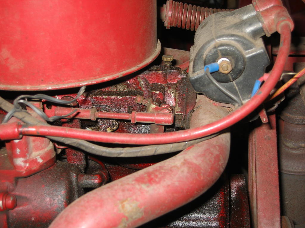

dmill_theredneck 1 #1 Posted April 26, 2018 Does anyone happen to have a picture of the top of the motor of an 18 automatic, my throttle won't stay in one spot I think I'm missing a spring or something but I'm not sure, also is the linkage for the transmission adjustable, mine seems to be a little slow like the linkage is not go in all the way forward thanks for any help Share this post Link to post Share on other sites
pfrederi 20,195 #2 Posted April 26, 2018 I will try to get a picture of my D200 later today. For the motion control; linkage adjustment look at this manual. it is not the easiest thing to accomplish' 1 Share this post Link to post Share on other sites

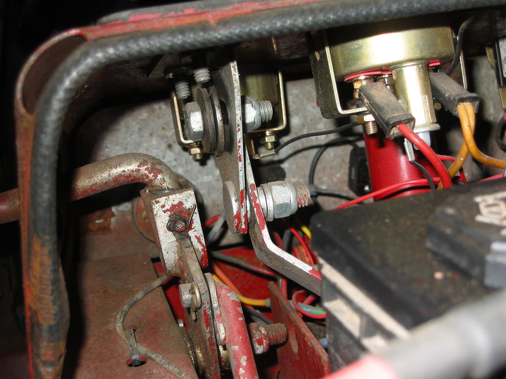

pfrederi 20,195 #3 Posted April 26, 2018 (edited) No spring I think you need to tighten the friction nut/bolt at the handle pivot point in the first picture Top bolt Edited April 26, 2018 by pfrederi 1 Share this post Link to post Share on other sites
dmill_theredneck 1 #4 Posted April 27, 2018 Thanks for the help guys I'll try that tommarow Share this post Link to post Share on other sites
