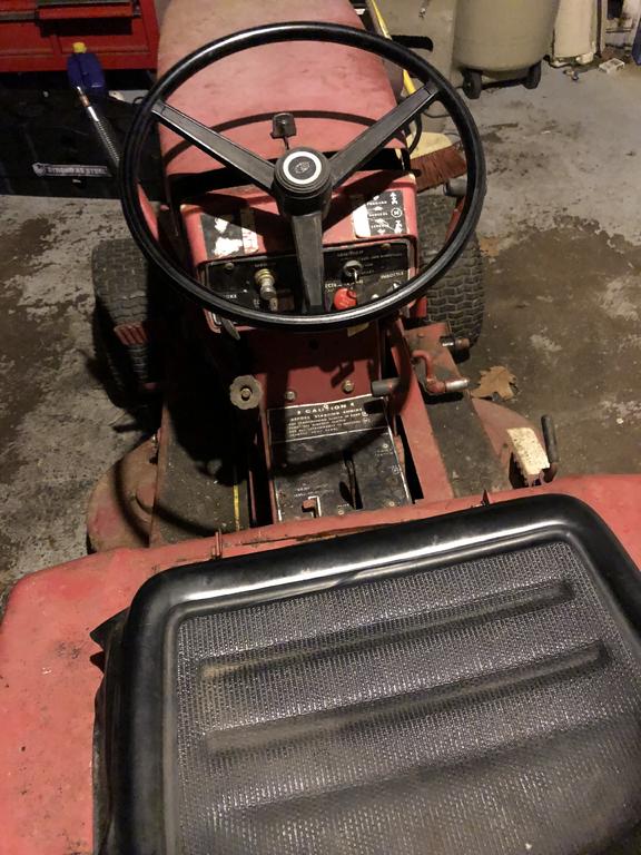

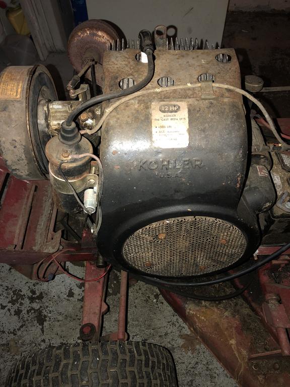

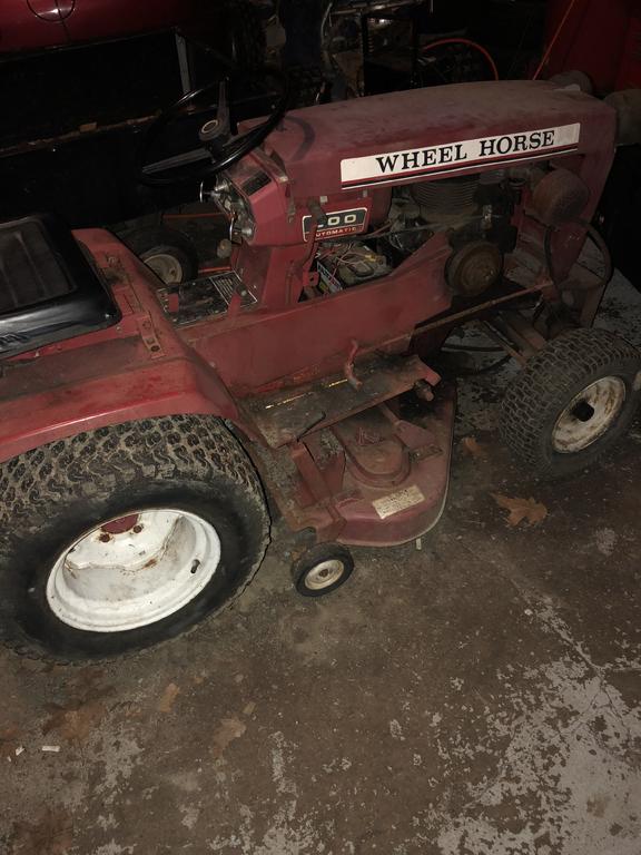

dstriker 2 #1 Posted April 25, 2018 I recently got an 800 auto and it was free given to me by a buddy of mine it’s in really good shape body wise and i got it running think I might need to add an electronic fuel pump doesn’t seem to be getting the gas it needs but it’s running from what I have read I believe it’s a 1971 and from what I saw the motor may have been replaced at one point because it has a kohler cast motor and what I read shows they came with Briggs am I right about this? The plate under the dash is 1 0450 6 772930 if anyone knows what this is exactly and what it should have had please let me know additionally if anyone has the manuals any and all that apply could you please send them to me Share this post Link to post Share on other sites
953 nut 70,343 #2 Posted April 25, 2018 12 minutes ago, dstriker said: been replaced at one point because it has a kohler cast motor and what I read shows they came with Briggs am I right about this? The 800 was a short run model because the supply of Kohler engines was used up and the B&S was used until more Kohlers could be obtained. I would keep the Kohler if it were mine. You should replace the fuel lines and filter as well as rebuilding the carburetor and use non ethanol gas. https://www.pure-gas.org/ 1 Share this post Link to post Share on other sites
dstriker 2 #3 Posted April 25, 2018 Thanks and I am absolutely keeping the kohler on it she runs good when she has fuel lol 1 Share this post Link to post Share on other sites

Ed Kennell 47,821 #5 Posted April 25, 2018 Yes, model # 1-0450 is an 800 automatic. It came with a 8HP Briggs engine and a #6 Eaton transmission. In 1970-72, Wheel Horse used many Tecumseh and Kohler engines with a few Briggs mixed in. 1 Share this post Link to post Share on other sites
dstriker 2 #6 Posted April 25, 2018 All of that was done from the gentleman that gave me this tractor he didn’t care for the auto and knows how much I enjoy these tractors so he offereded it to me and of course I couldn’t pass this beauty up 1 Share this post Link to post Share on other sites
dstriker 2 #7 Posted April 25, 2018 So the Kohler was original to this?? from the serial number I didn’t see that I may have looked it up wrong I’m somewhat of a newby but it’s a 12 horse kohler on it now Share this post Link to post Share on other sites
953 nut 70,343 #8 Posted April 25, 2018 (edited) 9 hours ago, dstriker said: Kohler was original to this?? Like Bob said, the tractor you have came with a B&S 8 HP and at some point was upgraded to the Kohler 12 HP, much better. I am posting the questions fro your PM here so others can offer answers too. Can you tell me what the serial numbers on the tag mean please Serial numbers don't tell you very much on a Wheel Horse, Model numbers do tell you the year and other data. wheelhorseallyears.pdf im a younger guy 31 tomorrow actually and I absolutely love these tractors my wife says I’m old bcuz of my love for these and I’d love to know as much as possible Tell your wife you need this for your birthday! The best way to learn about is to continue reading threads on this site and ask questions. I also have a 416-8 1990 the guy that gave me the 800 has probably 40-50 of these tractors and most are all older not sure of the model the engine sits between your legs and they are smaller Kind of nice my neighbor has a couple of these as well and is really smart when it comes to getting them running but as far as history of them he doesn’t know so much and I’d like to know both you know The smaller ones are probably a Suburban or RJ. Like I said, read lots of threads on here and you will learn so much. Edited April 25, 2018 by 953 nut 1 Share this post Link to post Share on other sites
