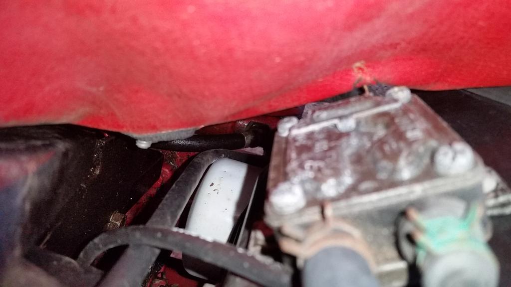

cleat 9,056 #3 Posted April 24, 2018 The 122-0800 should stick out enough to remove. Much longer and you could not get it out. 122-0645 is a shorter version of the 0800. That one would really be a pain to get a wrench on. I have purchased a NAPA 1762 to try next oil change on one of my 520's It is just a fraction of an inch longer so I hope it will clear everything to install it. 1 Share this post Link to post Share on other sites

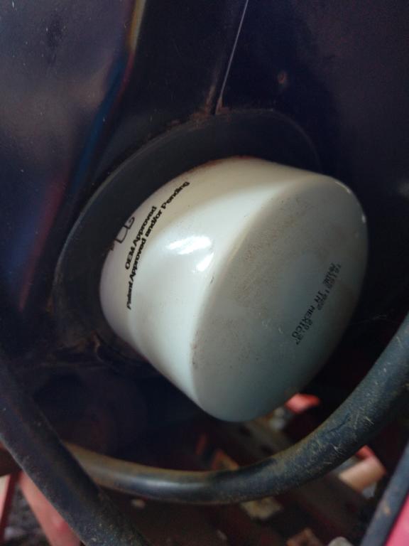

WHX?? 57,470 #5 Posted April 24, 2018 Those are the correct numbers Bo. I have been using a NAPA 1762 and will work fine Cleat...buried behind the cab but you get the idea. 1 1 Share this post Link to post Share on other sites

bo dawg 640 #8 Posted April 25, 2018 2 hours ago, boomers_influence said: bo the 122-0800 is mainly for the Big Block engine 4.2" long. ( P 224, T-260 N series etc. ) the small block is usually the 122-0645, 3.5" long. thank you. boomer ( the used onan engine parts guy, also NOS and new ) I have a 3 1/2" in it now but there's barely enough sticking out to grab on to, but doable. So the original length when you would buy the tractor new would of been 3 1/2" long? Share this post Link to post Share on other sites
Hoosier Hydro 520 3 #9 Posted April 25, 2018 I use Motorcraft FL-400S..Perfect fit and clearance..also reasonable price.. 1 Share this post Link to post Share on other sites
WVHillbilly520H 10,378 #10 Posted April 25, 2018 6 hours ago, bo dawg said: I have a 3 1/2" in it now but there's barely enough sticking out to grab on to, but doable. So the original length when you would buy the tractor new would of been 3 1/2" long? Yes the original was a bit shorter than what I use now but an extra pint of oil can't hurt... 6 hours ago, bo dawg said: I hate white filter sticking out of a black motor. Lol! I wasn't to happy about white either but it's better than an orange Fram... 1 Share this post Link to post Share on other sites

lynnmor 8,919 #12 Posted April 25, 2018 I use the longer -0800 filter, that is what was on the 1991 when new, although the book called for the shorter one. I tried the smooth NAPA once, but hate not being able to use an oil filter socket. 1 1 Share this post Link to post Share on other sites
WHX?? 57,470 #13 Posted April 25, 2018 5 hours ago, 1995 520H+96+97 said: I use For the black look. Any idea who makes those, Bout the same price as a NAPA too! That sure is a nice lookin there dude! 1 hour ago, lynnmor said: hate not being able to use an oil filter socket 15 hours ago, squonk said: Napa 1763 has a hex on the end for wrench. It's a tad longer but still fits Might have to try that one. 3 1 Share this post Link to post Share on other sites
