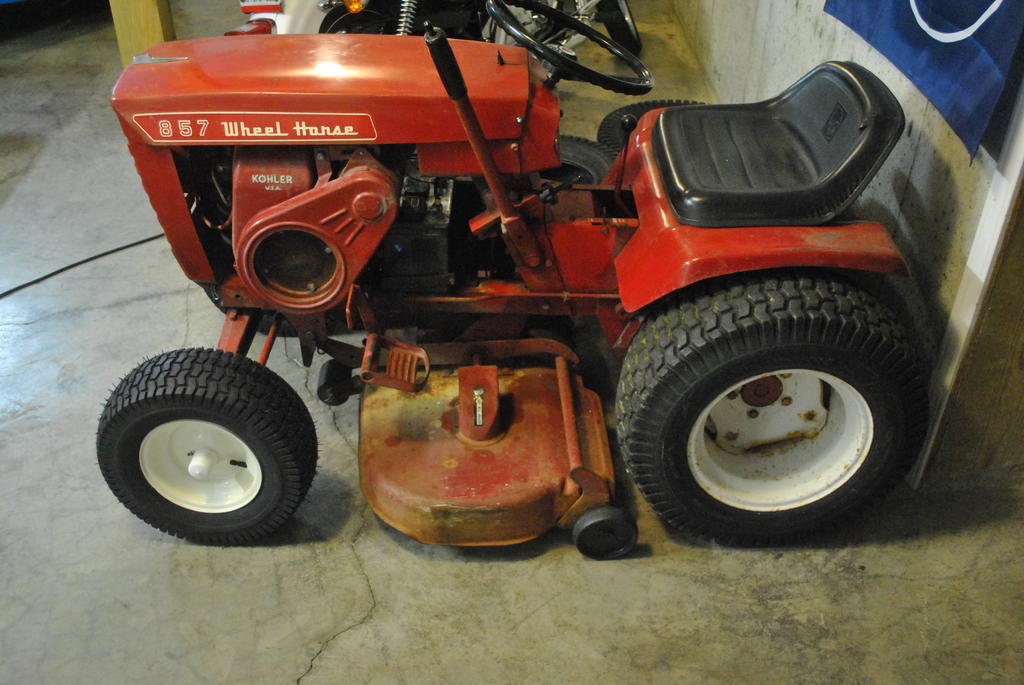

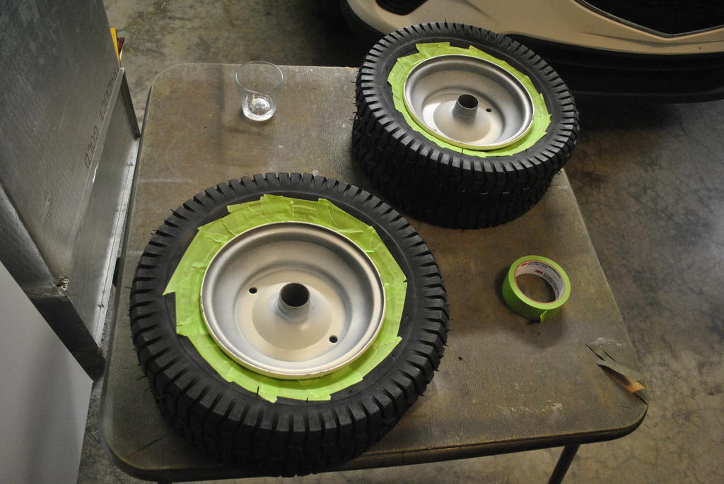

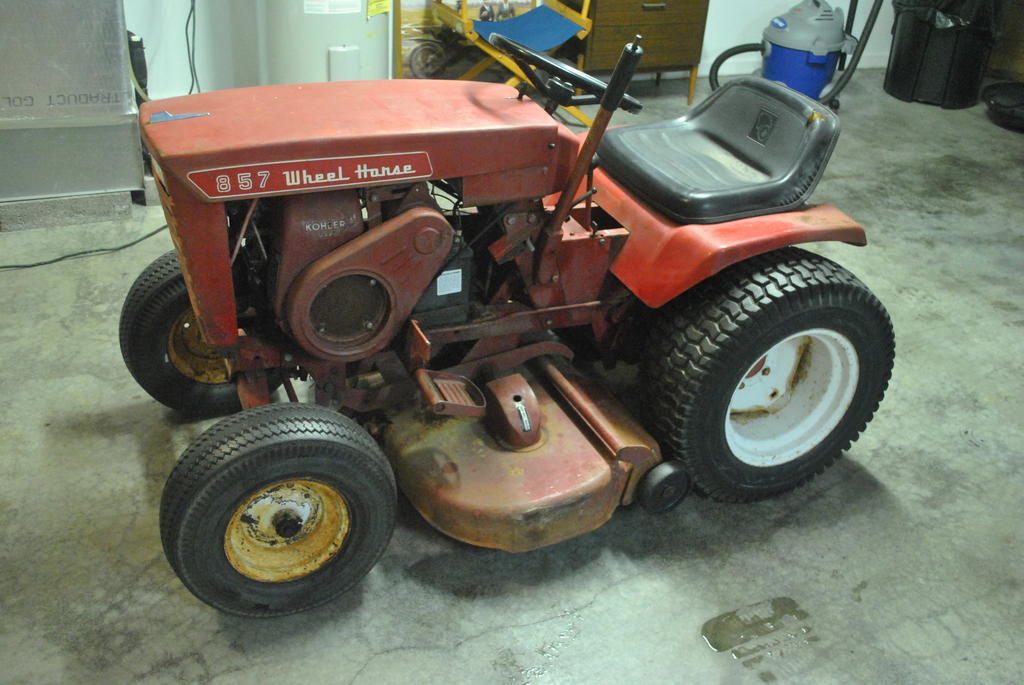

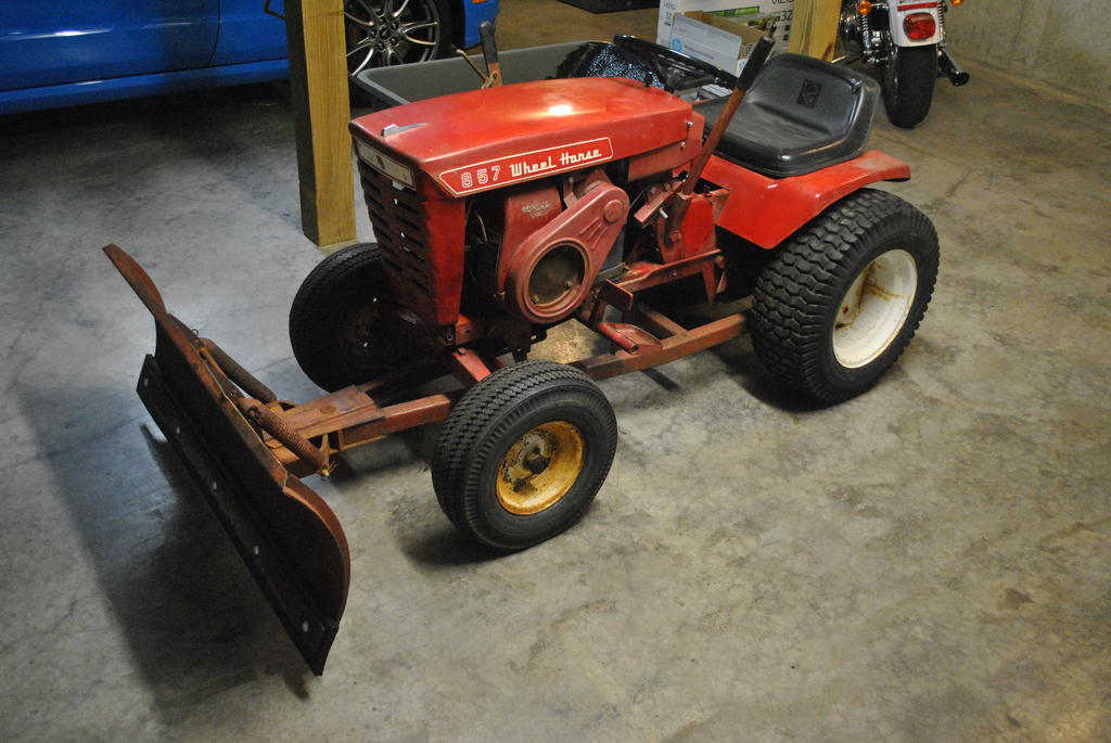

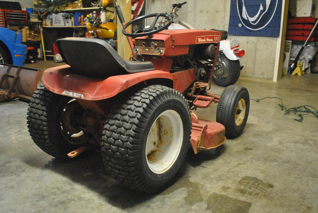

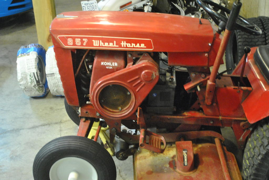

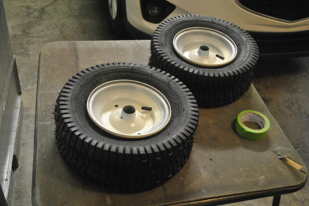

Horse Play 393 #1 Posted April 24, 2018 My friend bought me this tractor last September at the Portland, Indiana engine show. I bought it to use as a worker and to not for restoration - I restored my last Wheel Horse and my OCD would not allow me to use it! So I have been mowing grass and plowing snow since ownership and it has been such an amazing reliable, strong little tractor. So now I am doing a few cosmetic upgrades to give this worker a little fresher, patina look. Here's the condition I bought it in. This thing was amazing at pushing 6-8" of snow this winter. Now I'm looking for WH wheel weights for next winter. The tractor still had its original Carlisle/WH tires. So ordered new Carlisle Turf Savers - 16x8-6.50 for the fronts and 23x8.50-12 for the rears. I removed the bearings and had the front wheels sandblasted, then I primed the entire wheel, and painted the inner circumference. The local tire shop mounted the tubes and tires, but I told them not to seat the beads. Then I masked off the whole tire and paint the faces of the wheels before I seat the beads. This way I get I don't scuff up my new paint when mounting tires. 5 Share this post Link to post Share on other sites

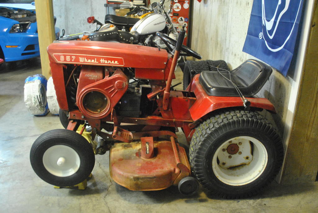

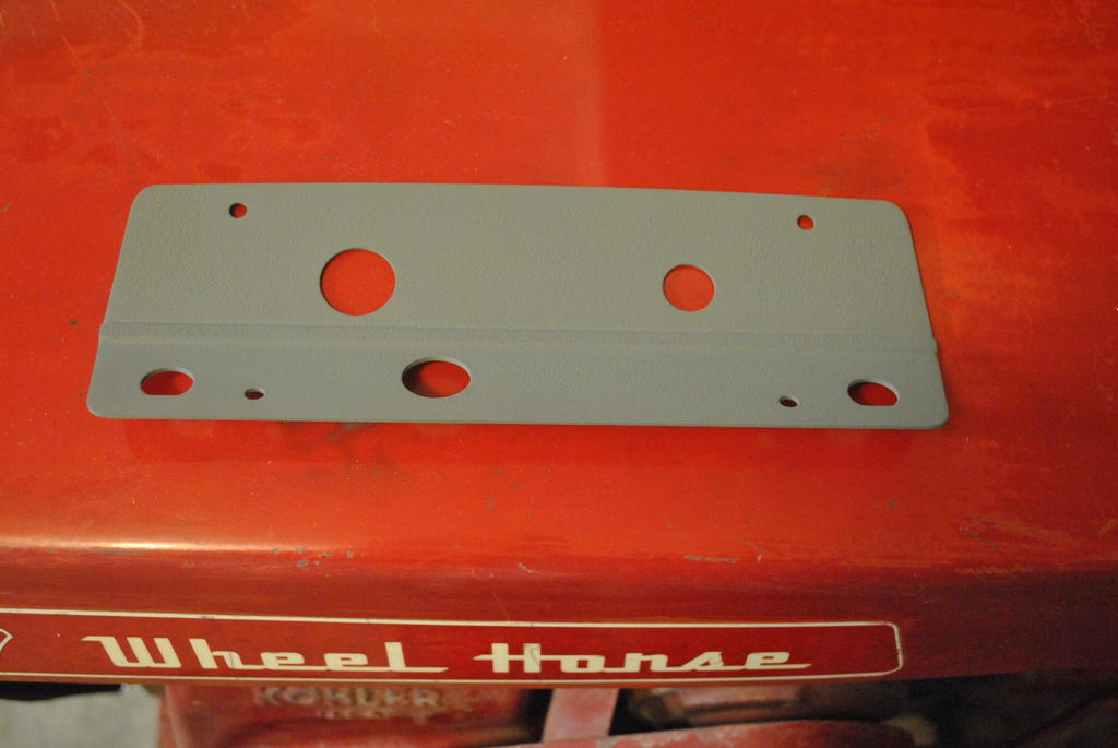

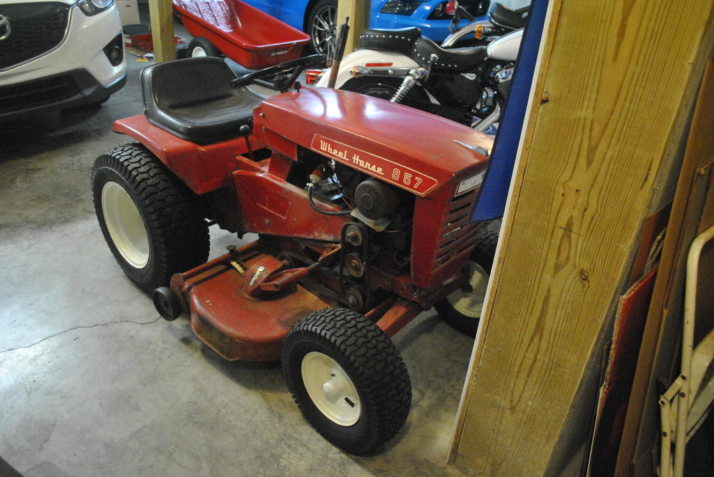

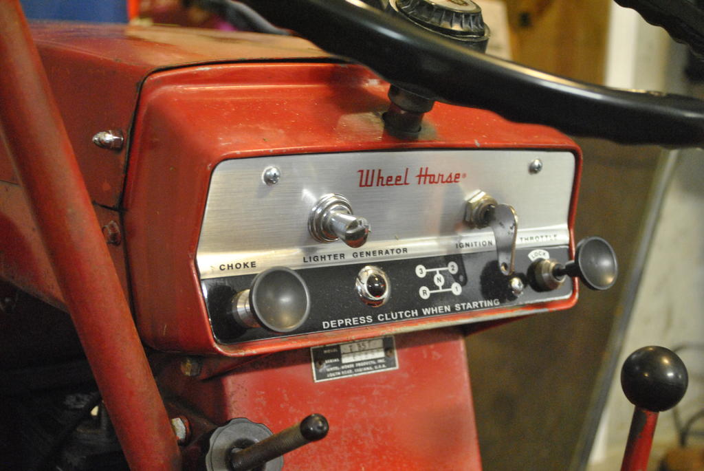

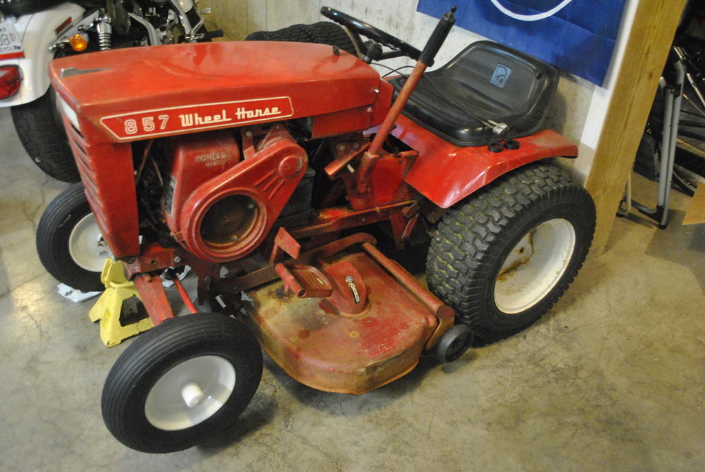

Horse Play 393 #2 Posted April 24, 2018 Meanwhile I slipped on my new dump cart wheels just for fun. The dash was extremely rusty, so I pulled it off the tractor and soaked it in vinegar for a few days. I cleaned off the liquid rust with steel wool and rinsed it well. Then I hit it with a sander and got on one coat of primer before it rained on me. It's really pitted, so I'll do some more primer and sanding along with paint before I do the dash decal. One thing I am bummed about is someone did a house-brush paint job. I've tried a few trial and error ways to make it look better, but for the time being I did a quick rub with buffing compound. Nothing to brag about, but it gives a slight shine and darkens the red. 10 Share this post Link to post Share on other sites

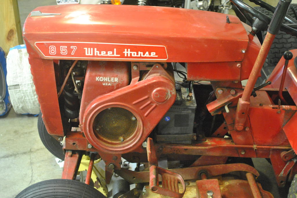

Horse Play 393 #3 Posted April 24, 2018 I've never tried any freehand paint work (other than model railroading) so I tried painting the raised Kohler lettering. First I used what was supposed to be an antique white, but it ended up looking like bright white. I didn't like the look, so I started over with a light gray - I like it much better. White Light Gray 6 2 Share this post Link to post Share on other sites

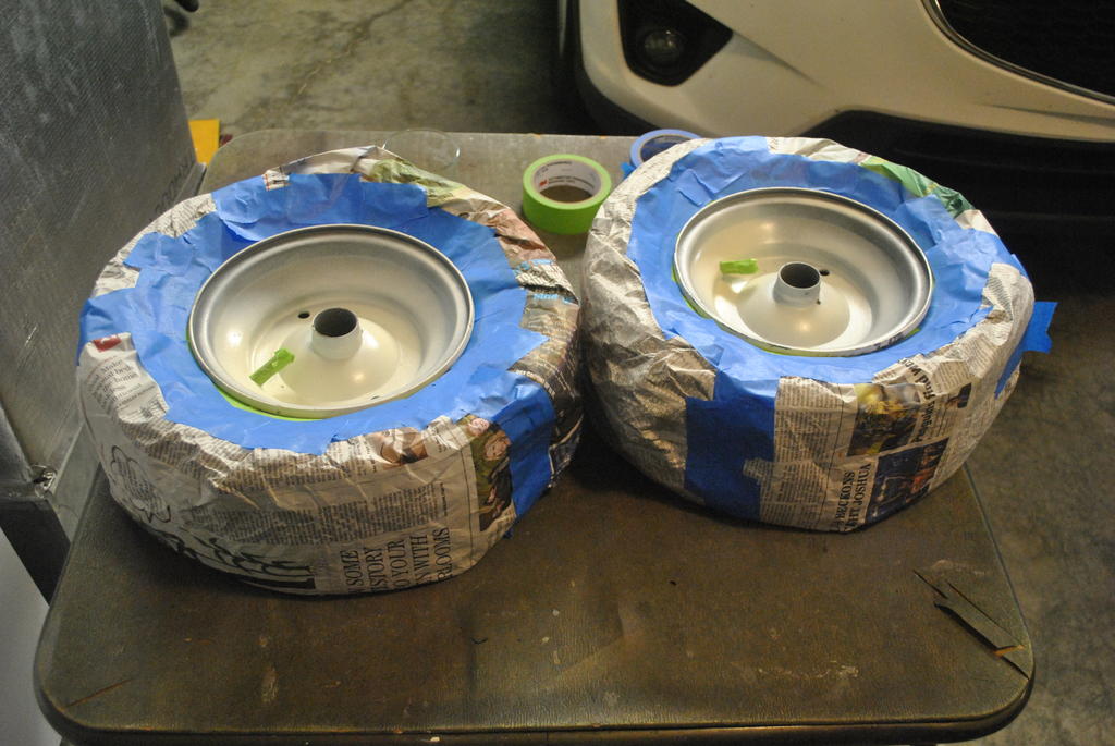

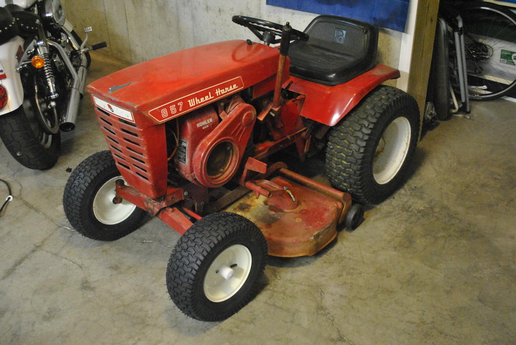

Horse Play 393 #6 Posted April 28, 2018 Front wheels are finished. 1 Share this post Link to post Share on other sites

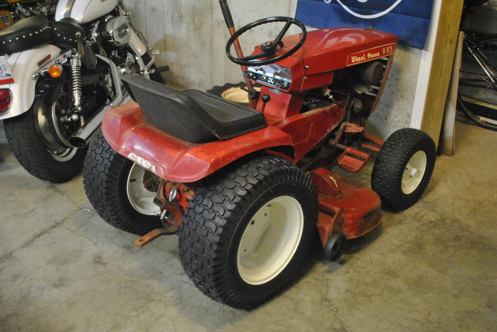

Horse Play 393 #8 Posted July 8, 2018 Rear wheels are finished, now I'm waiting on new lug bolts. And refinished dash with decal. 3 Share this post Link to post Share on other sites
