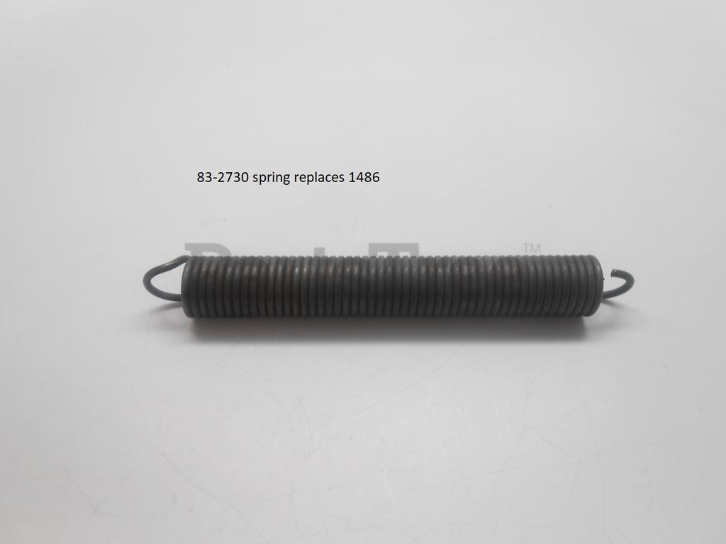

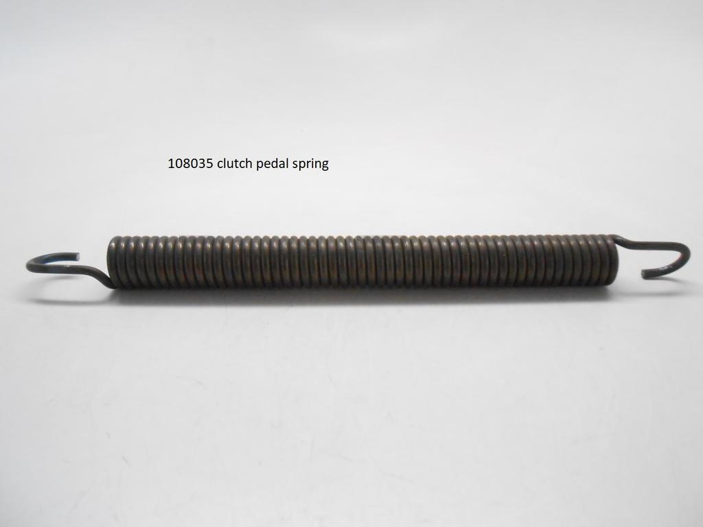

gwest_ca-(File Mod) 12,451 #5 Posted April 24, 2018 I found the 83-2730 spring replaced 1486 that was used as a pair on the early Lawn Ranger mower deck clutch. The 1984 8-speed clutch pedal spring was 108035 and still available from Toro. Appears to be quite a difference if the photo's are accurate. Garry 1 1 Share this post Link to post Share on other sites
Stealth126 54 #6 Posted April 24, 2018 That wasmy confusion. I almost pulled the trigger on a 108035 but couldn't get over the different appearance. Tough to believe it works the same. Share this post Link to post Share on other sites
Stealth126 54 #7 Posted April 24, 2018 Although, maybe it was an improvement because my spring stretches out pretty good. That longer spring would probably have pretty good tension since it expands less. My issue is that with the worn out spring my drive belt flops too much. Share this post Link to post Share on other sites

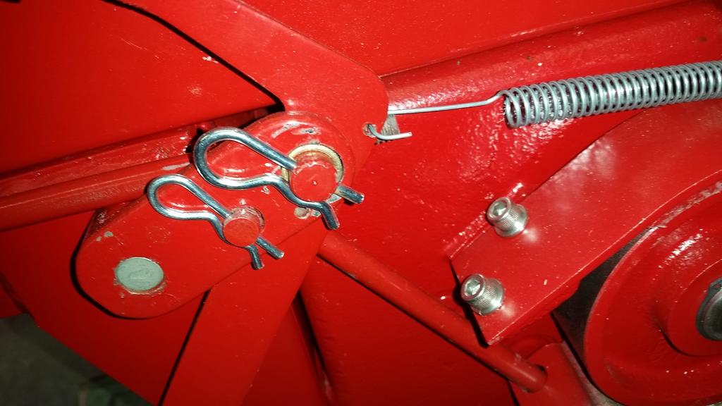

Lane Ranger 12,092 #9 Posted April 24, 2018 (edited) Something worth Noting about Wheel Horse/Toro Clutch Springs Interesting thing about these Wheel Horse clutch springs. The original 1014 spring is shorter than the replacement 108035. My clutch spring on my 603 (red one missing one end rusted off in photo) was a little wider than the 83-2730 (a later replacement) and the current clutch spring version 108035 is really too long to properly clutch that transmission. Yes, you can adjust the brake band but not enough on the 603 version. I do have a couple of the 83-2730 versions that are New Old Stock but I also note then are a little narrower on the spring as seen in my photo this from this morning. Edited April 24, 2018 by Lane Ranger added text 1 2 Share this post Link to post Share on other sites
WHX?? 57,797 #10 Posted April 24, 2018 18 minutes ago, Lane Ranger said: original 1014 spring is shorter than the replacement 108035 That's why I went to the hardware store and bought a small mitt full of different sizes and used the one that worked best. The 83-2730 just didn't give me the clutch feel I desired. 1 Share this post Link to post Share on other sites
