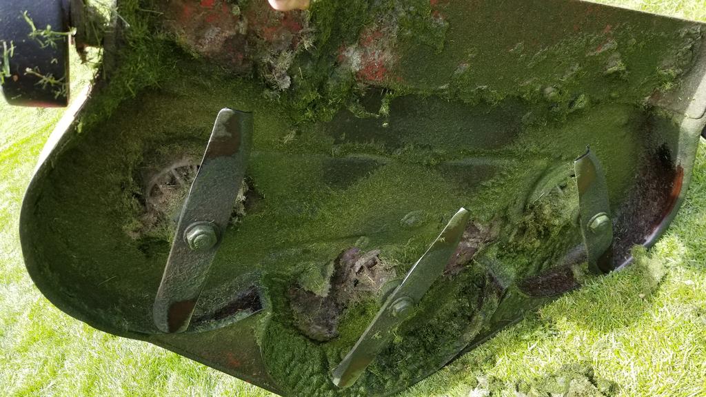

thehoz 5 #1 Posted April 22, 2018 Hi, I have a wheel horse 310-8 from 1985. I just got from a friend and I don't think much has ever been done with it in years, if ever. It does run well. I want to replace the blades in the mower deck. I can't see any numbers. It is 3 blades and the are 12" 14" and 12". Any suggestions in what to replace with or look for? Thank you. Share this post Link to post Share on other sites
dcrage 636 #2 Posted April 22, 2018 Your blades don't need to be replaced from what I can see -- From my view they look to have almost all of width still there; i.e. haven't been sharpened much -- Take them off, sharpen them (angle grinder with sanding wheel will do a good job), give your deck a good cleaning while you have the blades off including the top (I think there is a spring loaded tensioning slide for the belt under those belt guards, lube everything (should be at least 5 zerks; 2 for the wheels and 3 blade spindles); put everything back on and off you go -- Your deck looks to have a lot of life left in it 5 1 Share this post Link to post Share on other sites
SylvanLakeWH 31,745 #3 Posted April 22, 2018 11 minutes ago, dcrage said: Your blades don't need to be replaced from what I can see -- From my view they look to have almost all of width still there; i.e. haven't been sharpened much -- Take them off, sharpen them (angle grinder with sanding wheel will do a good job), give your deck a good cleaning while you have the blades off including the top (I think there is a spring loaded tensioning slide for the belt under those belt guards, lube everything (should be at least 5 zerks; 2 for the wheels and 3 blade spindles); put everything back on and off you go -- Your deck looks to have a lot of life left in it I always sharpen my own blades. Takes just a minute and you are off t the races... 1 Share this post Link to post Share on other sites
peter lena 9,947 #4 Posted April 22, 2018 that 36" r/d deck is definitely overdue for basic clean up and blade sharpening . all of that caked on grass grunge is trapping moisture and future rot, after you scrape it off, you could let it air dry in the sun, just the opposite of the life its been living. Then spray it down with a penetrating oil spray to counter the start of rot. leave the deck upside down for air and sun , hopefully you will save it, not that difficult . also check the spindle belt ,while you are lubing the spring tension slide. those 36r/d decks are really smooth and cut very well, regular maintenance , will help them live on , pete 1 Share this post Link to post Share on other sites

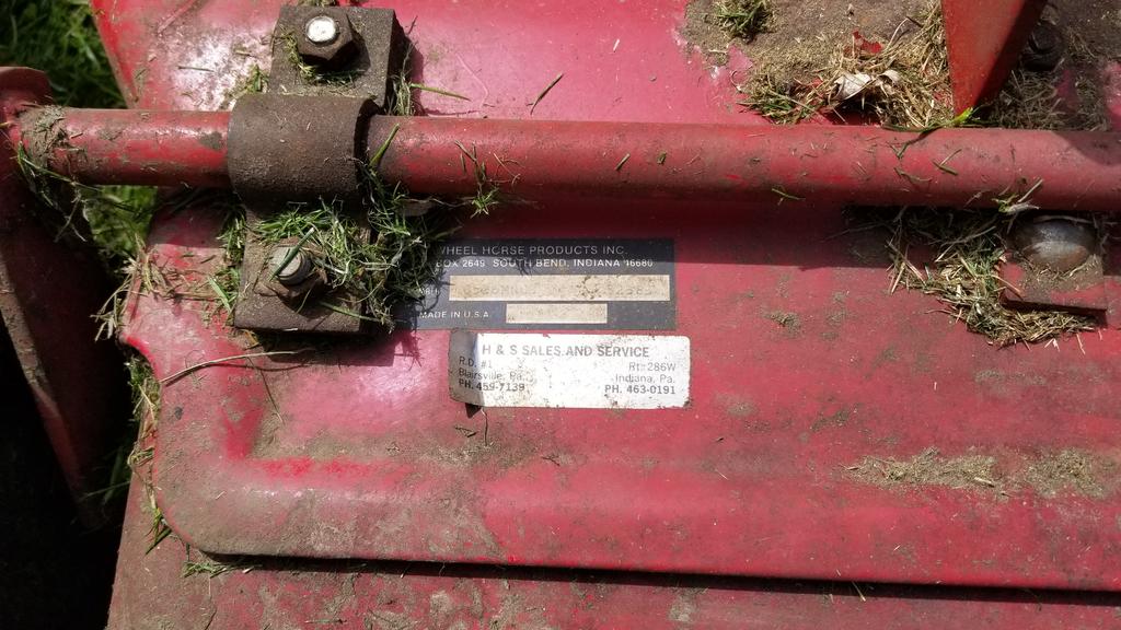

gwest_ca-(File Mod) 12,361 #5 Posted April 22, 2018 Can't read the numbers on your deck decal. The long model number and serial on the top line and the 4-digit Julian build date on the 2nd line. This is for a 1985 36" rear discharge deck. If the actual model number is different the blades and belts listed on the next page should be the same. Click on the picture. We do not have the 1985 deck operator manual so this one should do Garry 1 1 Share this post Link to post Share on other sites

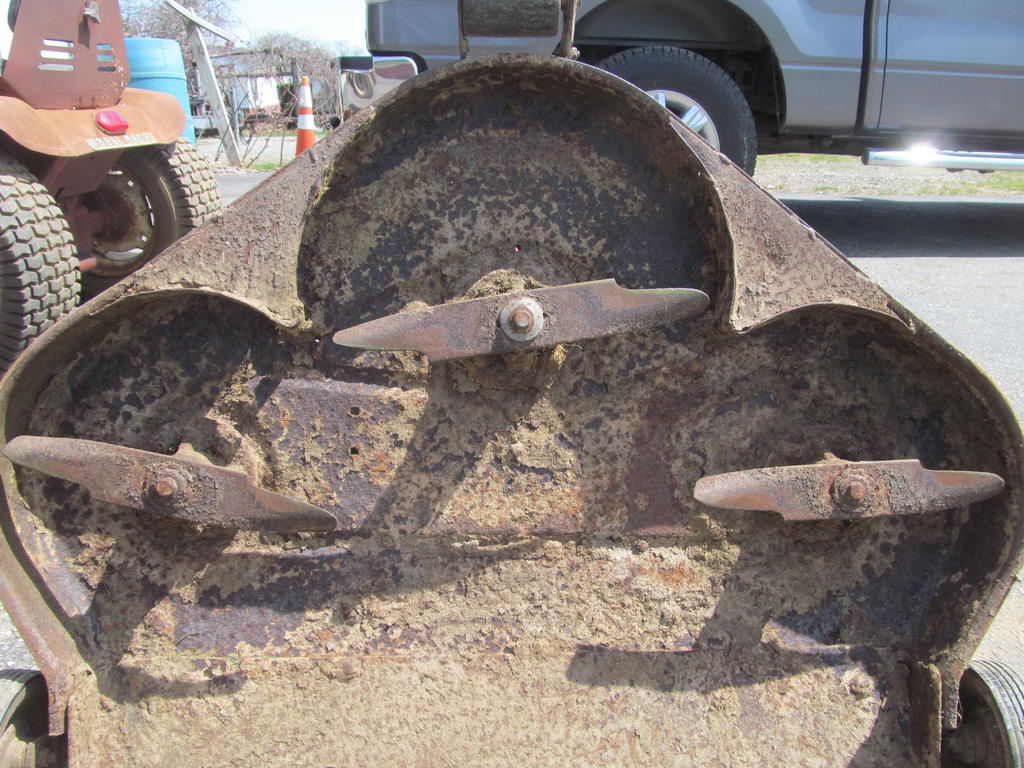

Ed Kennell 46,606 #6 Posted April 22, 2018 2 hours ago, dcrage said: Your blades don't need to be replaced from what I can see -- From my view they look to have almost all of width still there; i.e. haven't been sharpened much -- Take them off, sharpen them (angle grinder with sanding wheel will do a good job), give your deck a good cleaning while you have the blades off including the top (I think there is a spring loaded tensioning slide for the belt under those belt guards, lube everything (should be at least 5 zerks; 2 for the wheels and 3 blade spindles); put everything back on and off you go -- Your deck looks to have a lot of life left in it Those blades are hardly worn. Worn blades look like this: 4 Share this post Link to post Share on other sites
