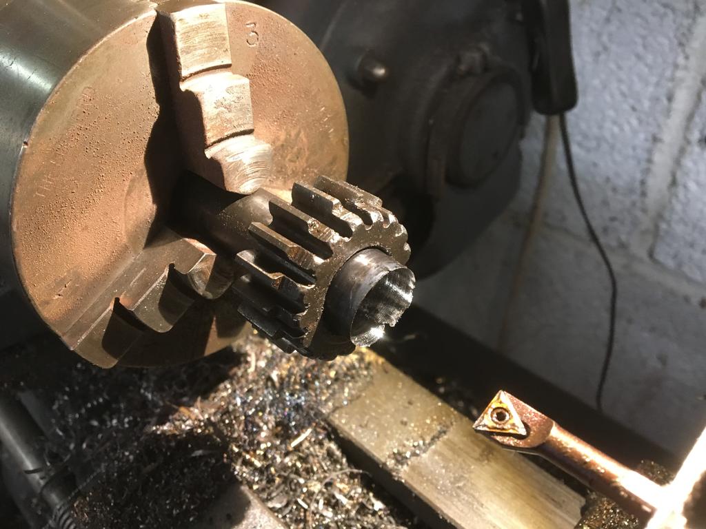

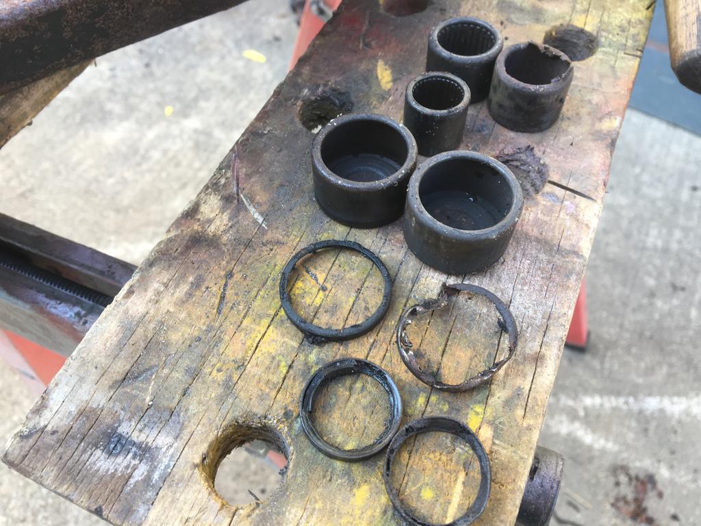

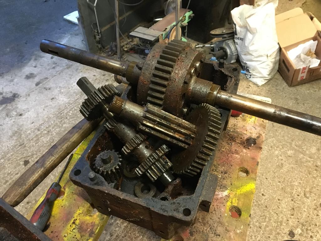

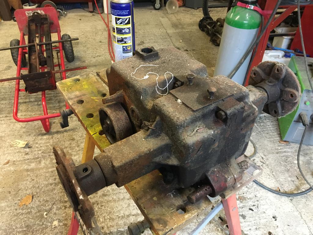

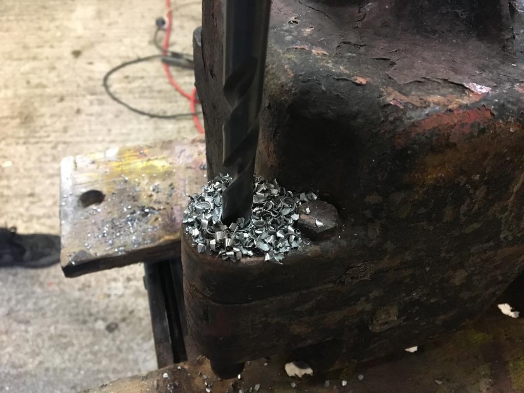

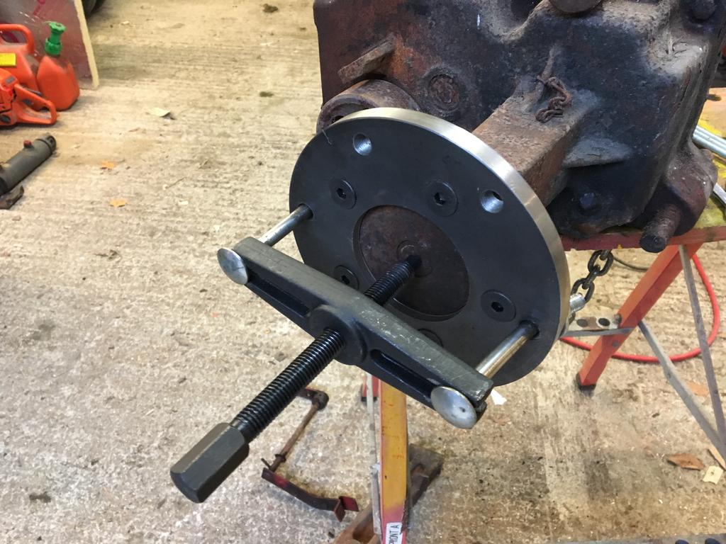

meadowfield 2,953 #1 Posted April 21, 2018 Some of you may recall I had a pretty bad workshop fire 4 years ago. We lost a lot of stuff, but I hung onto a few bits as I couldn’t part with them. Here’s one such item, a commando 8 tranny that was burned and full of water. the hubs were really seized on, my 6 ton jack failed to pull them and just stripped the 5 rods I used. So I had to use the big puller, lots of heat and a big hammer! which did the trick, then there was the ubiquitous seized hitch pin... before it finally split its not a pretty sight, however the main bearings are ok. The needle rollers and seals will need doing. 7 Share this post Link to post Share on other sites

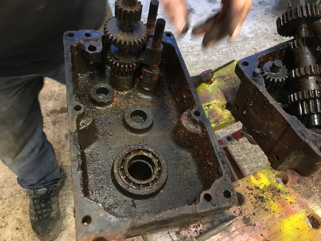

meadowfield 2,953 #5 Posted April 24, 2018 On 21/04/2018 at 5:14 PM, peter lena said: the main bearings are ok??. are you serious?, there is no rotational bearing or mounted seal that I would not replace. that corrosive wet slurry will surface score any bearing, making it something that should be replaced. I would also use a 10-30 oil for a run in and further flush to ensure you got all the crud. then refill with 85-140 . you have this completely apart, you don't rebuild it, and then say , " I should have " as a noisy bearing grinds back to life. having done a lot of gear drives, now is not the time, to hope a bearing is ok. Pete well the main bearings aren't seized - but equally they are hard to obtain in the UK. So I will be cleaning them out and seeing how smooth they run. The transmission hasn't turned since the fire, so it hasn't had bad stuff grinding it up. All the torrington bearings are shot, they are seized - so will all be replaced as well as the seals. The casings and gears will be cleaned so there shouldn't need to be a flush. Once the bearings are out they can be steam cleaned and possibly e-tanked. Share this post Link to post Share on other sites

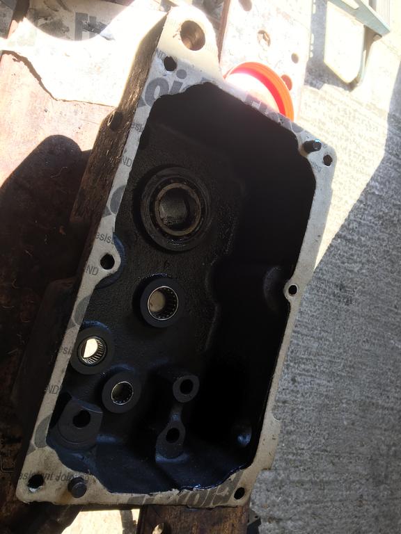

meadowfield 2,953 #12 Posted May 5, 2018 Thanks for the advice guys... I’ve popped all the bearings out. Not a lot left! Looking for hints on removing the 5/8 needle bearing from the input shaft. An internal bearing puller with slide hammer isn’t working. 1 Share this post Link to post Share on other sites
953 nut 64,277 #13 Posted May 5, 2018 59 minutes ago, meadowfield said: hints on removing the 5/8 needle bearing from the input shaft. I presume you are talking about the closed end bearing. If you have a 13/16 drill bit (presuming the needles are out of it like the others) you could probably begin drilling it and have it snag on the bit enough to remove the rest of the jacket. 1 Share this post Link to post Share on other sites
stevasaurus 23,620 #14 Posted May 7, 2018 Sorry Richard, he is talking the 5/8 one that sits inside the input shaft and the spline shaft fits inside of that.. I got a few of those out Mark. Get the needles out 1st, then take a good, small and sharp screw driver...find the thin side and tap the screwdriver down in there. Work it around, the metal is so thin and hard it rips easily and you can pull the rest with a needle nose pliers. Great pictures of nasty bearings. 3 Share this post Link to post Share on other sites
meadowfield 2,953 #15 Posted May 8, 2018 Thanks Steve, I tried peeling it in, the casing is very hard! I resorted to the lathe... 3 Share this post Link to post Share on other sites
stevasaurus 23,620 #16 Posted May 8, 2018 You can see how thin that casing is and that it is already ripping. Of course, If you have a lathe......... Share this post Link to post Share on other sites
meadowfield 2,953 #17 Posted May 9, 2018 22 hours ago, stevasaurus said: You can see how thin that casing is and that it is already ripping. Of course, If you have a lathe......... it was hard work to turn, those casings are hard - not as hard as a single row ball bearing housing, but still hard going... Full set of bearings and seals ordered - I've cheated on some needle rollers and used caged rather than full complement. Will let you know how it goes, I don't think this tranny will ever work that hard... 1 Share this post Link to post Share on other sites

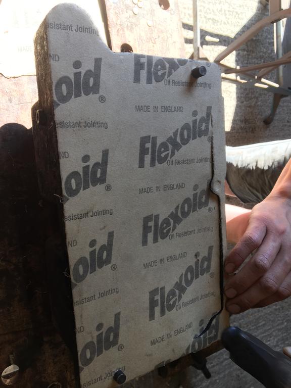

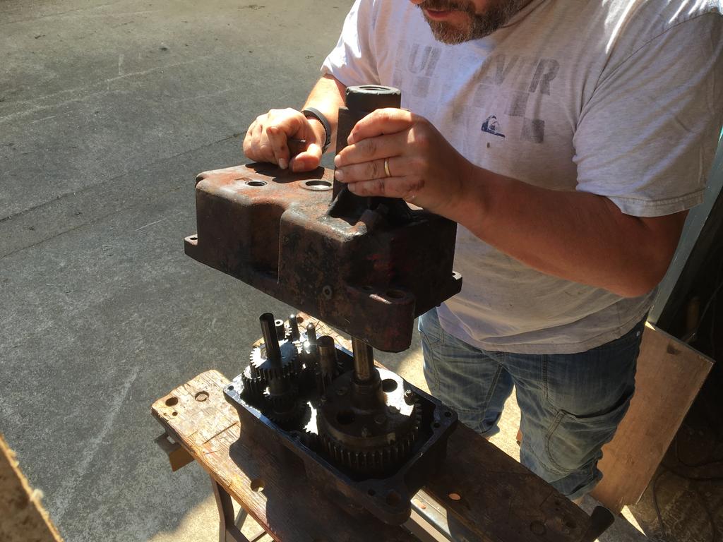

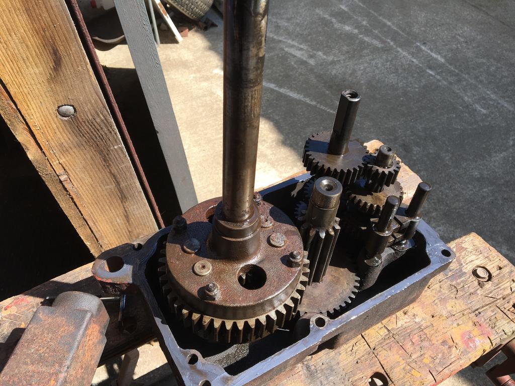

meadowfield 2,953 #21 Posted July 12, 2018 (edited) A bit slow, I managed to order one one bearings wrong twice! the small 5/8 one from the input shaft... I think I've found a better way of putting the shift forks in, which is to fit of fork, then grind a bevel on the end of the other which is enough to push the other ball bearing in as it is inserted then spin the fork to align everything. new gasket being made finally, dropping the other half in without ruining two oil seals It's back together and turning smoothly, fingers crossed it lasts another 50 years! Edited July 13, 2018 by meadowfield 1 2 Share this post Link to post Share on other sites
