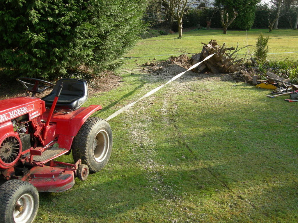

Keith of kent 47 #1 Posted April 19, 2018 Hi all I am in UK with a Westwood (Ariens IIAC) garden tractor with K46 transmission. Had it since new (2010), 250 hours all mowing work, Transmission getting less and less power and now will hardly move up a very slight slope. Some people say change the oil for thicker grade but others say waste of time. No drain plug on this thing so would have to take it out and tip upside down to do it properly. I have an engine oil removal electric pump that goes down the dipstick hole in a car but would that be a waste of time, obviously won't get it all out? Looking online I think I may be finding a lot of metal swarf in there. There is a Westwood dealer in UK who sells some new parts for the K46 but I have no idea what I need. What is the issue with these that causes this problem? I have good mechanical skills and a very comprehensive tool kit so doing the work shouldn't be a problem, just need so pointers as to what I should be looking for Thanks Keith Now this is out of action after the first cut of the season it's just as well I have my 73 Raider 12 with 42" deck............. Share this post Link to post Share on other sites

Keith of kent 47 #5 Posted April 20, 2018 Hi, I already put a new transmission belt on over the winter. The degree of the problem has not changed as a result of that. I tried it again today and from cold its not too bad. So thinking about sucking the oil out and filling with 5/50 fully synthetic which I have so just a bit of time. I use the Westwood for mowing my lawns (about 2 acres), because it is unique in that it has a PTO driven sweeper and a roller it leaves a nice striped effect on the lawn which we like. It collects the leaves in the fall very effectively. I also have a Westwood scarifier which is PTO driven. Its got a Kawasaki FS481V 16hp twin (built in the USA !) One I'd replaced the ridiculous Chinese bearings which disintegrated in the first two years it has been fine until this. The Raider 12 is used for mowing 2 acres of field that's a bit bumpy and would destroy the Westwood. Its a worker and also tows a large heavy roller, a large trailer full of logs or ton bags of sand etc etc etc. I even towed the root stump of a 60' Eucalyptus about 100 yards with it. This machine is so fantastic, but; it doesn't collect grass and stripe the lawn Occasionally they both are used to entertain the grandchildren! 2 Share this post Link to post Share on other sites
