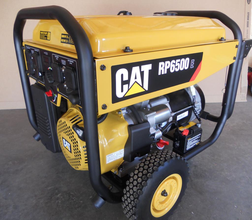

Racinbob 13,200 #1 Posted April 18, 2018 This isn't about a motor on a Wheel Horse but it does apply. I recently purchased a new Caterpillar generator with a 420cc motor. I prefer to run ethanol free fuel and the most convenient station to get it only has 91 octane. I figured the only thing that will hurt is my wallet a bit. I fill the generator tank and proceed to open the user manual. It specifically states to use fuel with an octane rating under 90. I've always figured that high octane fuel wouldn't hurt a thing in any motor and at the most was just a waste of money if not needed. The way Caterpillar stated things I became curious as to why so I hit the internet again. The results were mostly the same as my thoughts have been forever but there were some that said otherwise. The no-no's were mostly about some overheating around the valves. Now, I'm fully confident that no harm will come especially since 91 isn't a real high octane and, to be quite honest, I'm still with my original train of thought but the fact that Caterpillar stated that in a manner that you shouldn't run 90+ octane. With the vast amount of knowledge the members on this site have I thought it would be interesting to hear some of your thoughts on this. 3 1 Share this post Link to post Share on other sites

Racinbob 13,200 #5 Posted April 18, 2018 Ya made me go out in the cold and take a picture Jim. You're right about selling the generator but I wanted to get something my wife could handle. An old lady like her isn't about to go swapping attachments when em power is needed. I suppose I could have dedicated a tractor to the generator but I'd hate to do that for an attachment that used so little. No, it's not made by Caterpillar but like the vast majority it just branded Cat. I went for the features and sized it to do everything we need in the house. Plus the warranty was better than most. None of that new fangled fuel in this thing. That would be $183.92 per tank. I could justify it for some things though. It looks like we have 3 that agree with my thoughts that it won't hurt a thing. @oldlineman there were mixed thoughts on the heat thing as well. I think I need to quit researching things so much. Again guys, I just started this to hear the thoughts of all the smart guys here. So far I've heard 2 (pay attention Jim, you might learn something ). There's another station around here that has lower octane booze free fuel and I'll start going there. Not cuz I'm worried about the 91 but it's probably cheaper. 4 Share this post Link to post Share on other sites
