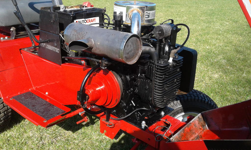

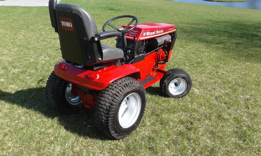

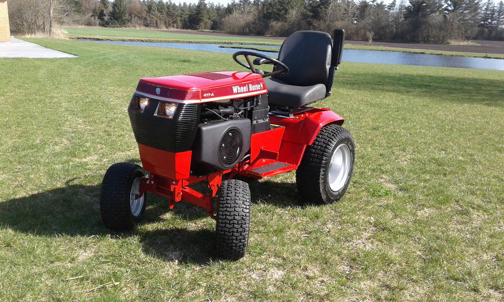

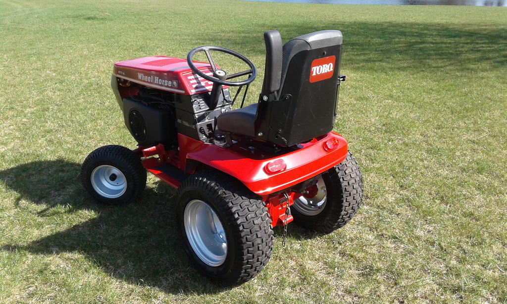

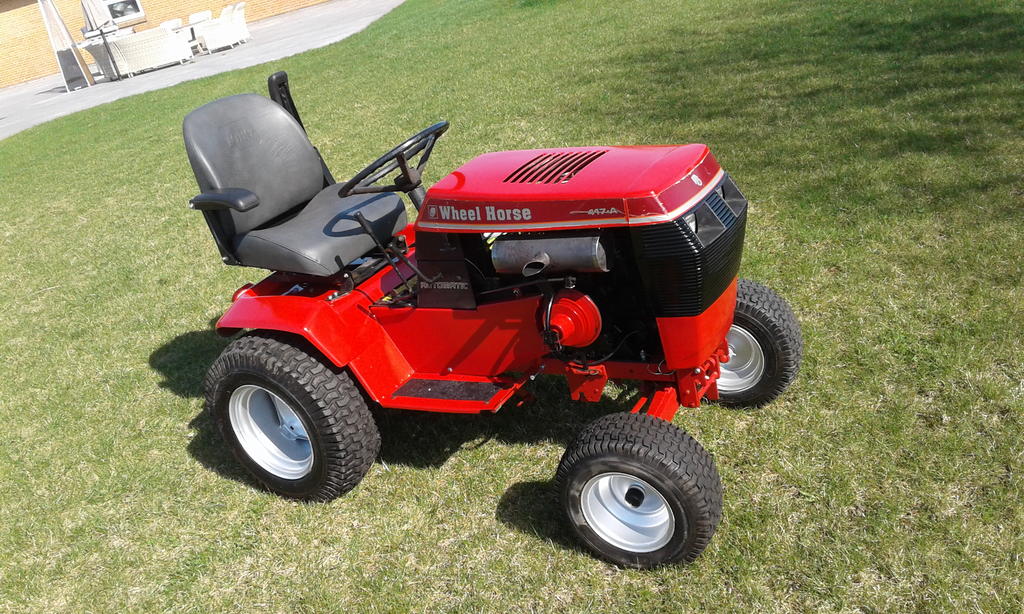

Skipper 1,792 #7 Posted April 19, 2018 So as I said, much more of a working girl than a show queen , but compared to before touchup, this ain't so bad. She runs strong and flawless now, and will get the job done for sure. I'll fabricate some engine side covers to guide the airflow, put a sticker on the fender, and set her up with a tiller and a 48" deck. Then she should be ready for a new owner. 2 3 Share this post Link to post Share on other sites
peter lena 9,849 #8 Posted April 19, 2018 good recovery ! good job, its hard to think like someone that has no " operational experience " on even the most basic mechanical equipment. as a retired mechanical millwright, I have seen more " oil shearing " failures then I need , that probably makes me go after lubrication more than anything. its the old school inherent strength of this unit, that makes it a savable unit, its smart to take advantage of that. I would use a perforated metal on that air ducting if possible , that would let the " blown air " act as a cleaner as well as a cooler, reducing the grass build up. knowing that you probably touched every neglected part of this unit says a lot about your thought and concern to save this tractor. if you grew up with this type of tractor , you know it can live as long as you want it to. good work , pete 1 Share this post Link to post Share on other sites

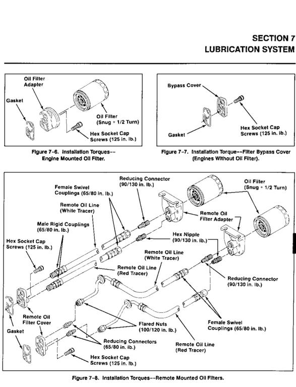

19richie66 17,859 #17 Posted May 20, 2018 (edited) You can get a remote oil filter kit for these engines off ebay. They come up all the time. Some cubs had them also. There is a plate on the lower crankcase that you change out for one that will have the fittings for oil lines. Mount the filter adapter where you want and run new hoses. I have two sets but have yet been able to find the time to put them on. Here is a page from the service manual. It would be a good time to put one on before you install the tins, which you can also get from the auction site cheap. Good luck. Edited May 20, 2018 by 19richie66 3 Share this post Link to post Share on other sites
