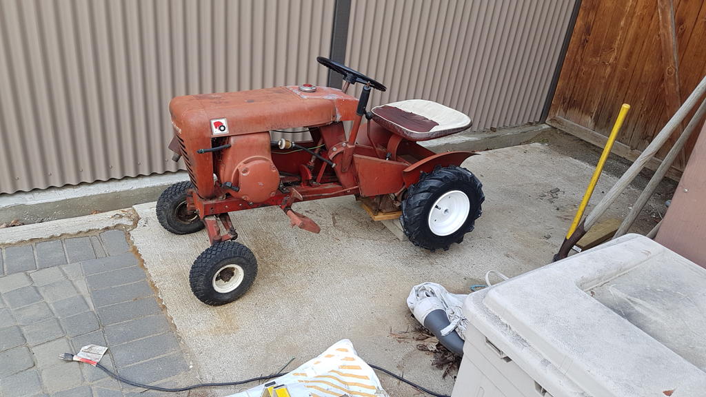

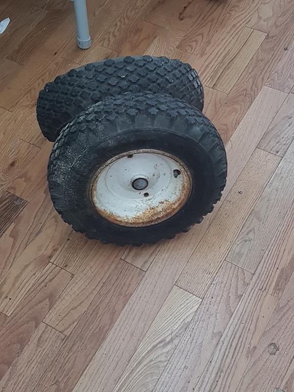

Lambeater 14 #1 Posted April 17, 2018 (edited) Good morning guys, just putting some new rubber on my grandsons 33R and looking for front tire advice. Got some Oregon lugs for the rear but now looking for front tires, gave up on ribs for front (seem to get to expensive for shipping to Canada). Narrowed it down to Carlisle saw tooth 4.10-4 or Carlisle turf saver. What do you think will work/ look best. thanks Lambeater Edited April 17, 2018 by Lambeater adjustment 1 Share this post Link to post Share on other sites
19richie66 17,950 #2 Posted April 17, 2018 I had turf masters or savers , can’t remember which. Good little tires. Share this post Link to post Share on other sites
Mike'sHorseBarn 3,704 #3 Posted April 17, 2018 I prefer the sawtooth tread over the turfsavers, but i think that "stubby" tires are the original tread pattern, but that is just my ocd coming out lol Share this post Link to post Share on other sites
Lambeater 14 #4 Posted April 17, 2018 3 minutes ago, Mike'sHorseBarn said: I prefer the sawtooth tread over the turfsavers, but i think that "stubby" tires are the original tread pattern, but that is just my ocd coming out lol I'm thinking that way as well seem to be a bit skinnier and more tractorish. thx Lambeater 1 Share this post Link to post Share on other sites

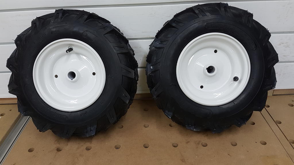

Lambeater 14 #5 Posted April 18, 2018 Well I got the rear tires mounted , cleaned and painted rims today. Sure was a big transformation, now just for the fronts. thx Lambeater 4 Share this post Link to post Share on other sites
Tankman 3,528 #6 Posted April 18, 2018 He'd be very proud! Nice! Share this post Link to post Share on other sites
Lambeater 14 #7 Posted April 19, 2018 put the rears on today, great transformation. Also a set of foot rests sent to me by Joe. Hopefully the engine runs tomorrow (got a new carb, cleaned tank, new filters and glass fuel bowl separator). lol Lambeater 2 Share this post Link to post Share on other sites
