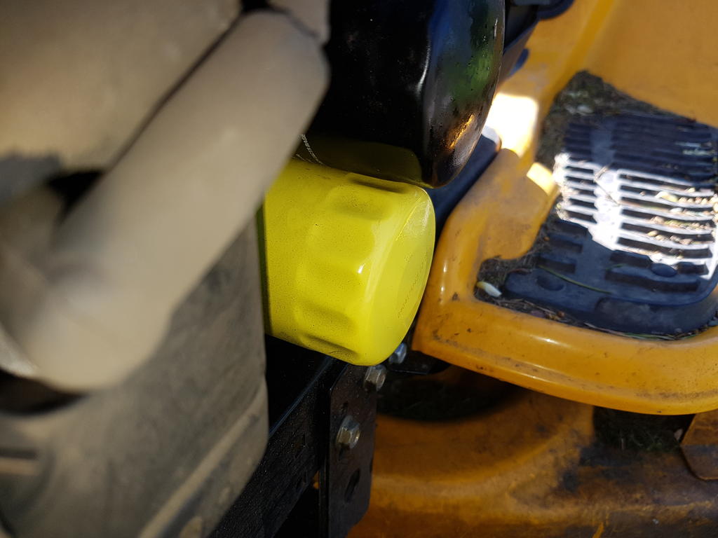

Sutty 96 #35 Posted April 20, 2018 (edited) Well I didn't do so well today. The implementation of that quick release drain on my cub cadet is shockingly bad. No wonder you swap them out for pipe work Rob. If you, or anyone else, has a link to how that is done, it would be much appreciated. What's wrong with it on this mower? Well first, it is right behind a wiring loom which cannot easily be moved because, from the loom, it has a very short lead to the starter. Okay, I could disconnect the lead, but that kind of defeats the quick release principle. Second, there was almost no gap to the base plate, and very little above it to the engine, so I couldn't really get hold of it to push and turn. Coupling that with the fact that the pipe was also on, made this really difficult. Eventually I managed though, and the oil started to come out. Then I made a bad mistake. Once the oil flow had almost stopped, I thought, I'll turn it over a little, to help get it all out, as I had with the horse. Wondered where the spark plug lead was to remove it. Found it, did so, turned the starter, and it started up! I stopped it right away, but obviously it did far more revolutions that the couple of turns I was planning for. I hope I haven't caused any damage? Seems to be fine, but I'm pretty mad at myself. I then looked around for why, and discovered another spark plug lead on the other side of the engine. Two spark plugs, two cylinders, and I have a twin. OMG, I didn't even know. How stupid am I. Unlike the wheel horse, on this cub cadet it's all hidden underneath plastic shrouds, but good grief, I've owned it from new, for nearly 12 years, and I didn't even know it was a twin! That little drama over, I repeated the rinse, turn over, wait, repeat, that I'd done with the wheel horse. Again, second time, it came out red, though with a trace of discolouration, but I thought all was good. I then tried to remove my pipe, and it pulled the quick release valve off the side of the engine. Obviously I know now that I should have twisted it locked again before I pulled the pipe, but I didn't know it would be loose at this point. I mean, it could so easily have come loose during the procedure and had oil everywhere. At the time I actually thought I'd broken it, but after I got the pipe off, and inspected what I had left in my hand, I could see that it wasn't broken and would go back on, with a push and twist, which I did, but not before several drops of oil had come out, all down the side of the mower frame. I then moved on to the oil filter, which is on its side. I put some tissues underneath, and turned it off easily enough, by hand, but quite a lot of oil came out making a bit of a mess. The instructions said to fill the new filter with oil, and put it on. How you are meant to do that, when it mounts side on, without it all pissing out when you try to fit it is beyond me. It did all piss out, but I managed to be fairly quick, so not terrible, but bad enough for something that is meant to be routine maintenance. I know I haven't done it before, but it sounds like it's something that is meant to be done reasonably regularly, and it was miles more difficult than with the horse. And, annoyingly, the filter was not to the spec the seller quoted. It is a 52 050 02, but it is roughly 1/3 of an inch shorter than the one I took off. I questioned the lengths and references in an earlier post, but I also said his dimensions checked out, so I wasn't worried. The dimensions however do not now check out. He quoted it in inches, 3.47" from memory, which when I convert it comes to roughly 88mm, the size I want, and what I have received is the one that is roughly 80mm. I've used it anyway, I wanted to get on with things, so I can't return it, but will ask him to look at his dimensions to correct his site info, in case it isn't a shipping error. My question to you guys now though is, am I okay to go with this slightly smaller filter, at least medium term, and just swap it out at the next oil change, or will it create an issue and require changing relatively quickly, causing me to have to repeat what I've just done? It's just 8mm shorter, at 80mm, so I'm thinking I'm okay. Below are photographs of the 'hidden' quick release valve, and the two filters side by side. The slightly longer old black one sitting on top of the fitted new yellow one, lined up at the seal end. Edited April 20, 2018 by Sutty Share this post Link to post Share on other sites

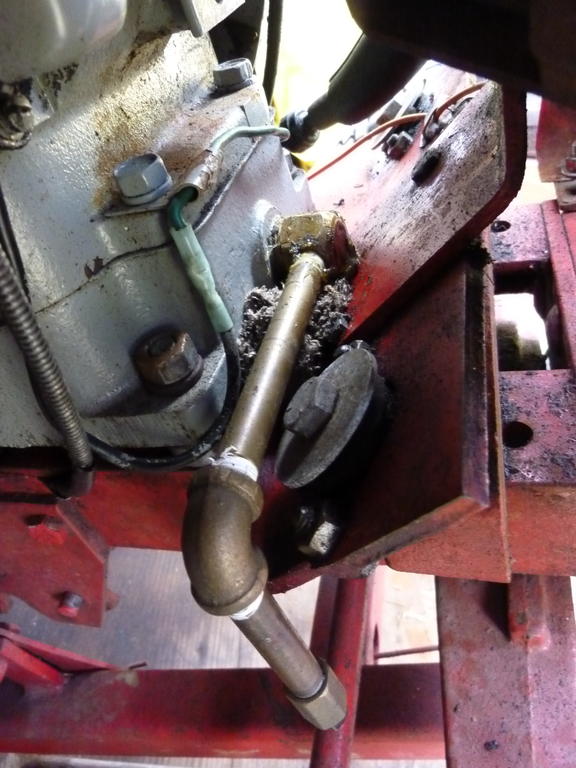

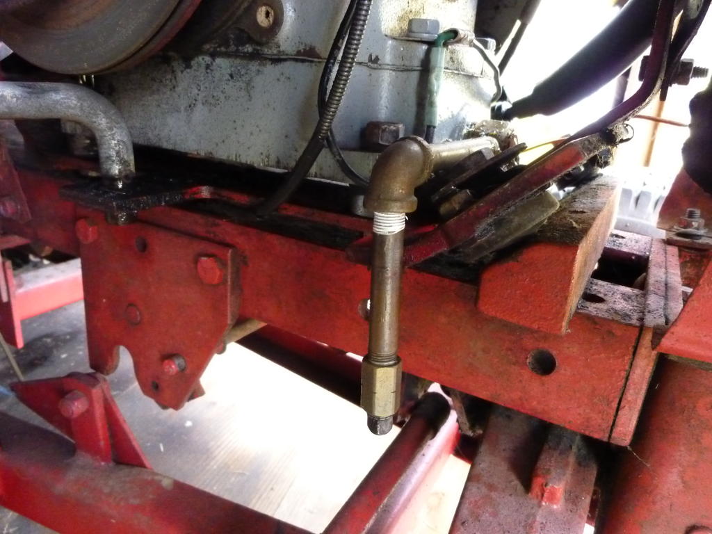

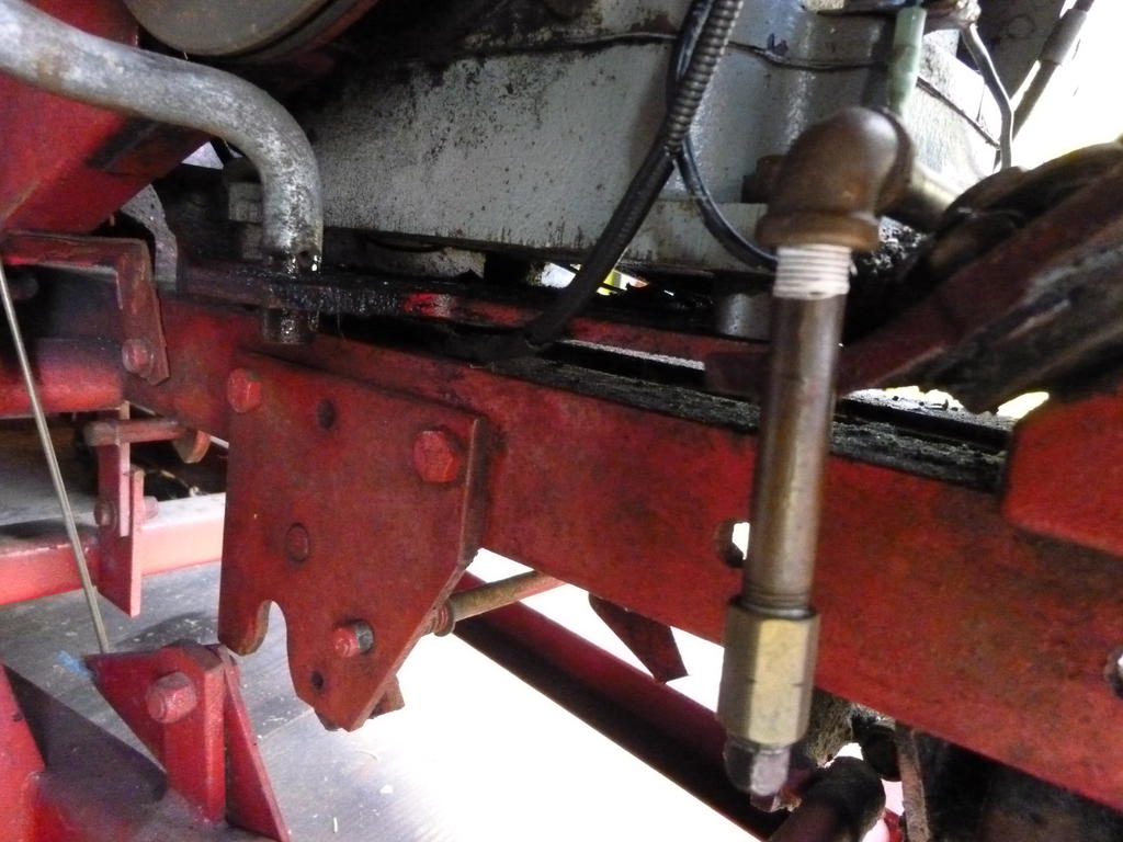

Rob R 980 #36 Posted April 20, 2018 You should be fine with the Oil Filter, attaching a copy of the drain pipe I added on my C-81, have done the same with all my machines..... you just need to do a little calculating (right pipe size, pipe length, thread and elbows........ always tilt the Tractor to the drain side and drain when hot...... Share this post Link to post Share on other sites
Sutty 96 #37 Posted April 21, 2018 Nice job with the pipe work Rob. Thanks for sharing your pictures. Makes it clear how to do it. How do I find out what the thread size and type is to the engine though? If I wait to remove the existing, and take measurements, I'll have to drain all the oil again, just to get a measurement, then put it all back to keep my mower available whilst I get the pipe work sorted. Are details like that, about any given engine type, listed anywhere? Share this post Link to post Share on other sites

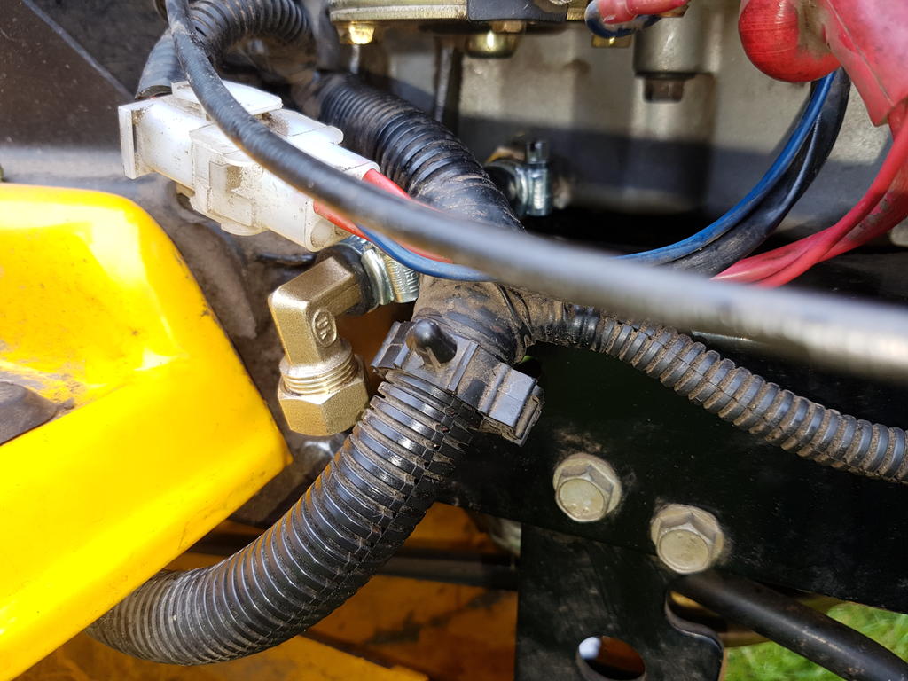

Sutty 96 #47 Posted May 3, 2018 (edited) Again with my apologies for writing about my cub cadet, but I said I would report back on how I got on with the pipe work. Attached is a shot of my assembly pre-fitted, and a shot of it post-fitted and in use. Couldn't resist draining the oil a little, just to see how it worked. Answer, it worked a treat. No ptfe tape on the end cap because it has a sealing ring in there. Cheers Sutty Edited May 3, 2018 by Sutty Share this post Link to post Share on other sites
Rob R 980 #48 Posted May 3, 2018 You gotter done! Congrats low pressure so should work just fine..... Share this post Link to post Share on other sites
Sutty 96 #49 Posted May 5, 2018 Thanks for confirming that Rob. I had an idea that was the case, considering that the proprietary item that I linked a little earlier was made up of a short section of rubber hose. I more or less copied that, but I included a 90 degree down turn before my end cap. Seems to be working well. I mowed the lawns today, which takes roughly 2 hours, and all was well afterwards. Not a hint of a leak. Share this post Link to post Share on other sites
