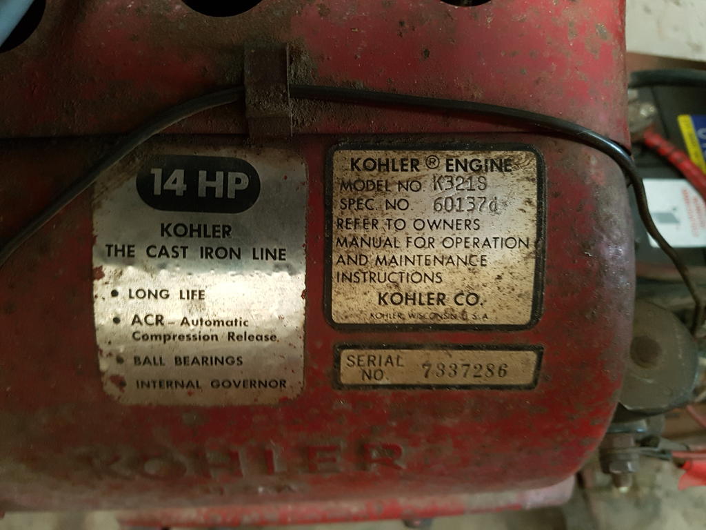

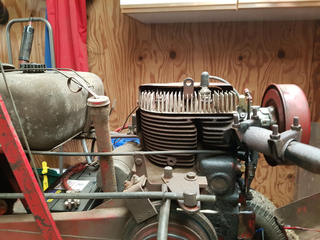

Sutty 101 #1 Posted April 15, 2018 Hi Guys I don't know if any of you remember me, but I have a C-140 8 speed, with a Kohler K321S engine, which is roughly 40 years old. Yes, a C-140 . I have an issue whereby the engine floods badly when the tank is full, or more accurately, when it's more than half full. It floods so badly that petrol almost literally pours out of the front of the carb, into the air filter, and runs out of the bottom of the air filter cover. I've been managing this for a good while by keeping the tank less than half full, but it's a bit too much of a pain, and I'd rather have it right. If I over fill the tank, by accident, as I did yesterday, I can also manage the issue by keep reaching down and turning off the fuel under the tank, and only turning it on for a few seconds when it starts to run out of fuel. A few seconds of on, every few minutes, will keep it running perfectly, but of course it's far from ideal. I have changed the carb fairly recently, a few years ago, but the fault persisted across both carbs. I'm wondering if the fuel pump might need attention, and if it does, is it something that can be serviced by me, with only moderate skill. I suppose the pump will be as old as the horse, so it will also probably be 40 years old. I think I also read somewhere that you can get a spring to lift the float with a little more force, but I don't know if this is necessary, or the right course of action. I can almost guarantee that the float is clean and free, because it's new, and before I changed the carb, I also cleaned the old one up, good and proper, and it appeared to function as it should, very free, but the fault remained, which is why in the end I thought I would try a new carb. In the end, I was disappointed to find that the issue persisted through the carb change, though not overly disappointed, because the carb was cheap enough, and I guess I now have a working spare anyway. If I manually restrict the fuel, as described above, or keep the tank level below half, it runs very well, so I believe all the needle settings are correct. I have attached a few pictures that demonstrate the tank height in relation to the carb, and some that might help some of you identify the carb type and the fuel pump type. The pump may have been messed with, around 15 years ago by my late father, or the guy who used to help him with small engines, so maybe the strange looking red seal you can see sticking out is not the original? Even though that looks wavy and unseated, it doesn't leak there, but it doesn't mean it's right, or original, but I'm sure you'll know. Anyone experienced similar, and have any suggestions? Is it easy to remove, disassemble, and service the pump, for example. I could just try, but I thought it sensible to seek expert advice first. Thanks in advance, for any possible advice. Best regards Sutty Share this post Link to post Share on other sites

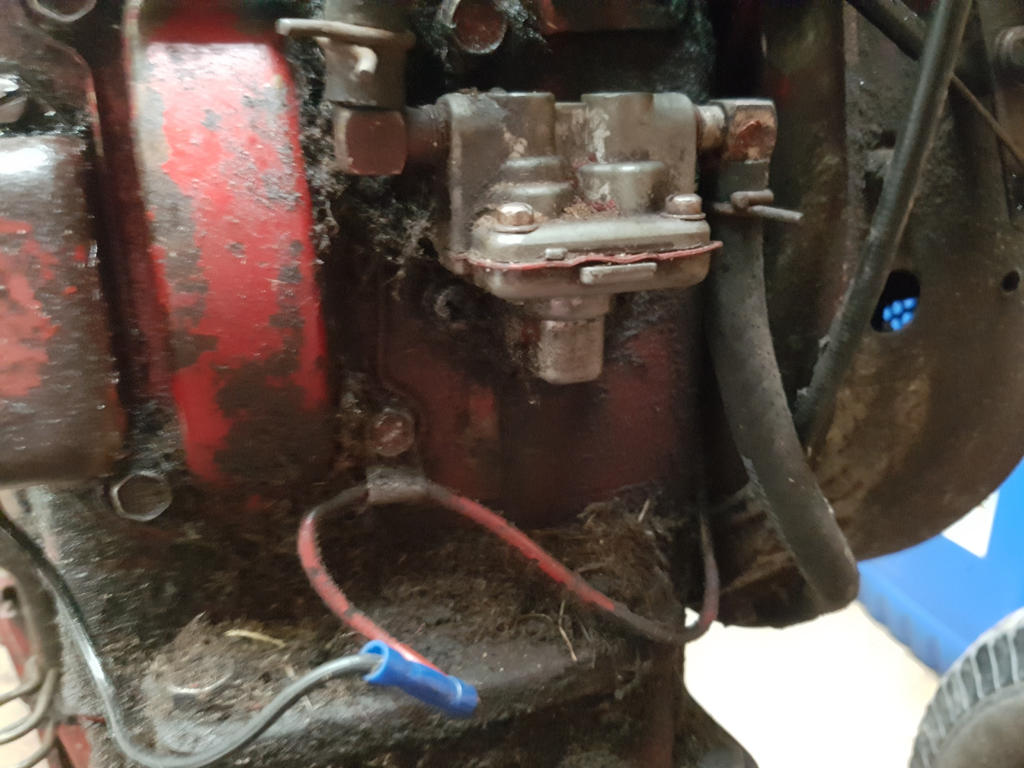

Ed Kennell 47,701 #6 Posted April 15, 2018 This is certainly unusual and does not seem possible for the fuel pump to generate enough pressure to submerge a properly working float and open the inlet valve. The leaking of fuel through the fuel pump is not unusual. Both the check valves in the pump are one direction...only closing and preventing flow back into the tank. When you blow into the pump inlet, both valves open allowing flow. When you blow in the outlet, both valves close preventing flow to the tank. My suggestion is to simply bypass the pump and see if the fuel still leaks with the tank full. The Kohler should run fine with out the fuel pump if the tank is full. 1 Share this post Link to post Share on other sites
RandyLittrell 3,946 #7 Posted April 15, 2018 You might also pull the bowl off and see if you can make the fuel stop leaking by lifting the float up by hand. Does sound unusual and I really don't see how the pump could cause it. Does it leak fuel when the tractor is not running? Randy 1 Share this post Link to post Share on other sites
Sutty 101 #8 Posted April 15, 2018 Thanks for the clarification that the trickle through is normal. Now that you have explained it, I can see why it might, without meaning anything is failing. With regard to the fuel pump pressure, I was surprised at how high it squirts, when turning it over without being connected. Indeed, when I had it off in my hand, I was also surprised with how readily, and forcefully, what was inside squirted out as I simply caught the diaphragm actuator lever by mistake. Is it possible to misplace that lever, such that it gets moved too far, on each stroke, when remounting the pump? As for trying it without pump, that seems like a great idea, and very simple to bypass with a short piece of pipe. If it works when full, and I can also run it until the tank is empty, the tank is quite high, as you can see from my picture, then this would be an acceptable solution. That having been said, my curiosity would probably still have the better of me as to why it might be going wrong with the pump in the circuit, so I'd still quite like to get to the bottom of it. I'll report back on Tuesday as to how that goes, because I'm out from early doors tomorrow, fishing, and will not be back until late, so I won't have a chance to look at it at all tomorrow. 1 Share this post Link to post Share on other sites
Ed Kennell 47,701 #9 Posted April 15, 2018 It is possible to install the pump incorrectly....with the lever below the cam, but the pump should not work in this condition. The lever must be angled up during installation to get the lever above the cam. 1 Share this post Link to post Share on other sites

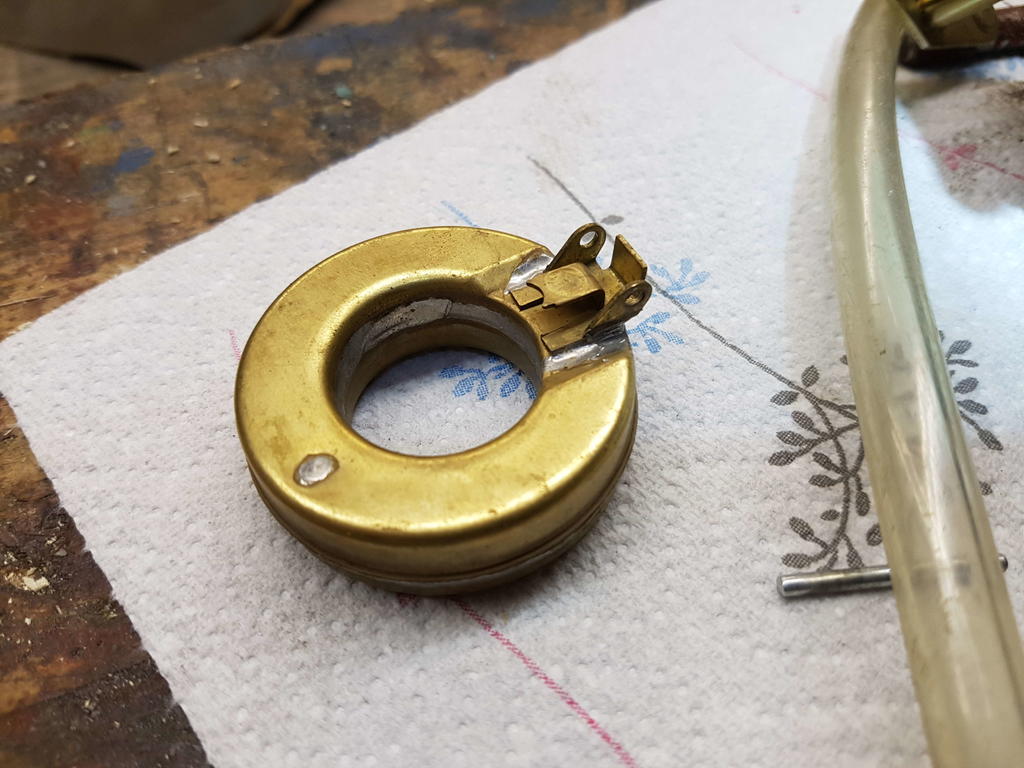

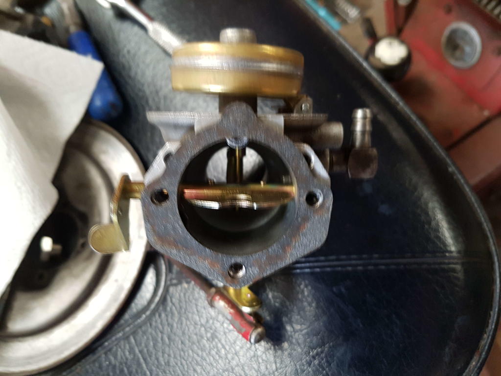

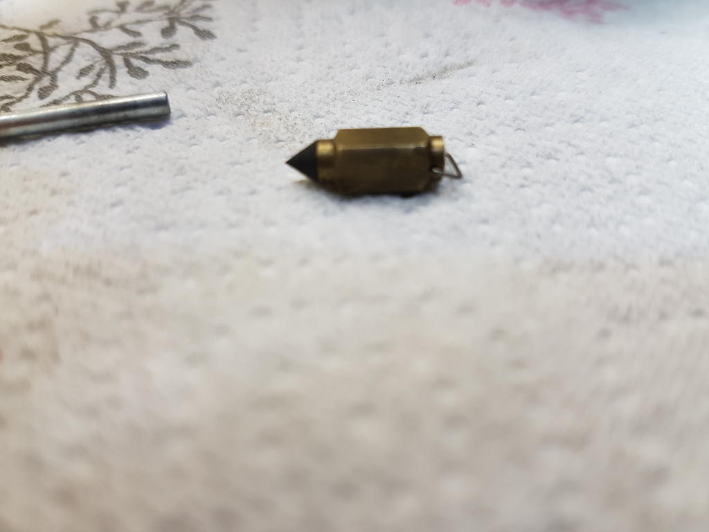

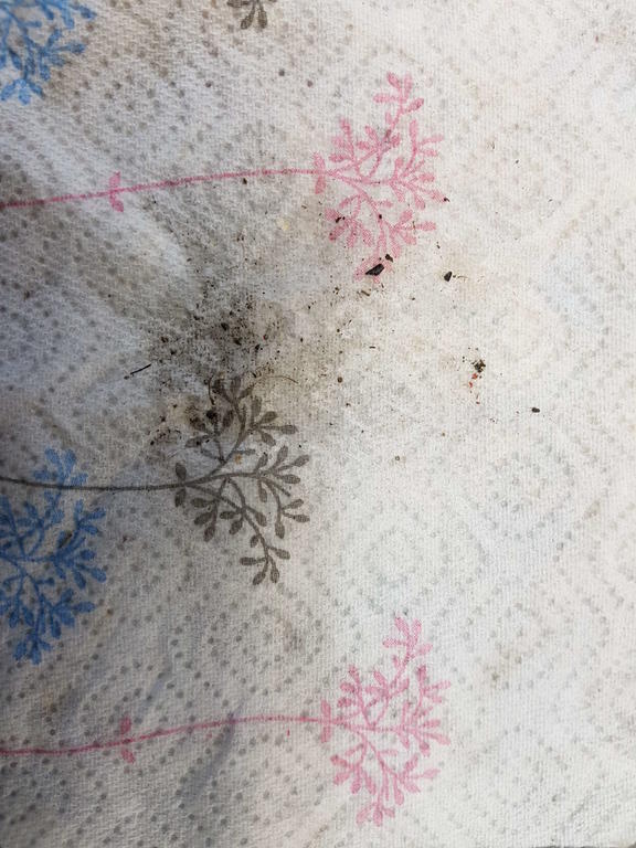

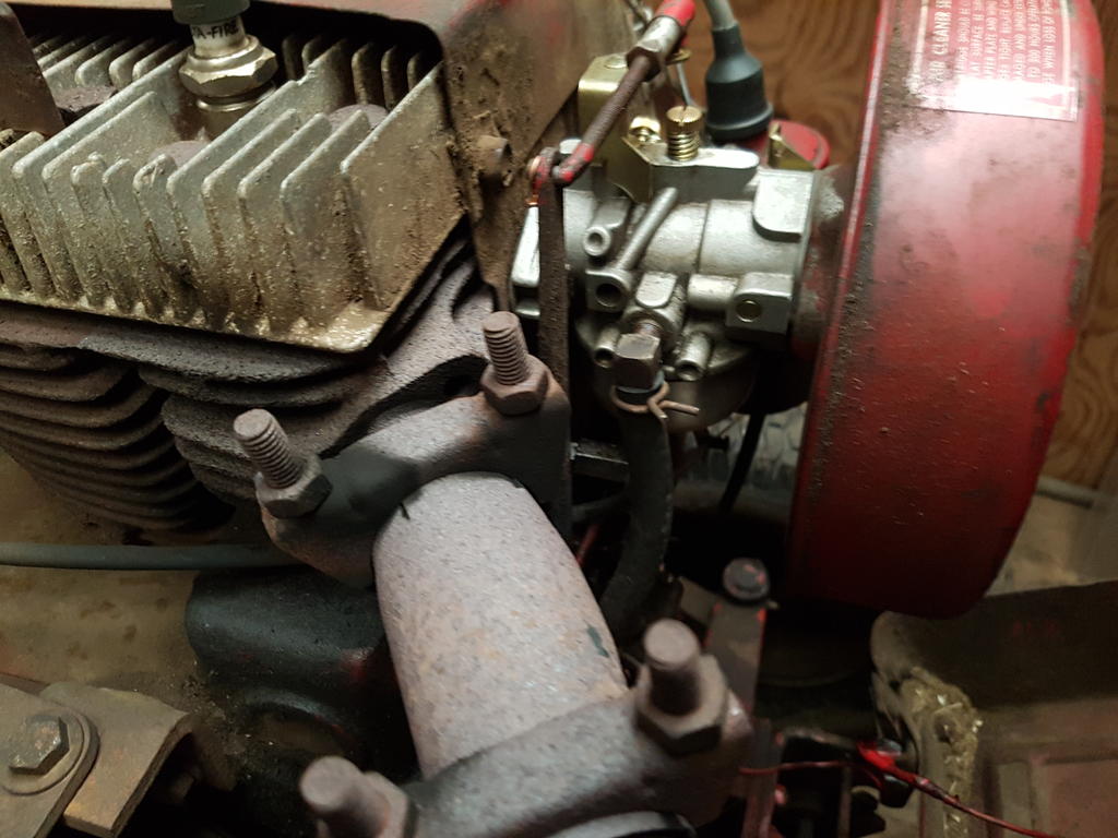

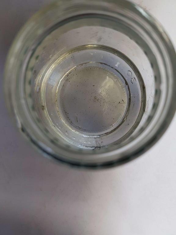

Sutty 101 #23 Posted April 17, 2018 Guys, such excellent advice. I really do appreciate all these tips and help. Now for the news of my activities today. I took a lot of pictures, as I put the carb back together, and I decided to cheat a little with the float, and make it lift the needle a little more than spec. Who knows, maybe this cheap carb isn't really made to spec. I was going to put all my pics in, so you could look out for any rookie mistakes, but instead I'll mainly just put in the float angle, so you can see how much I've cheated by. Since so many people mentioned it, and because I also figured there's no point chasing issues of a sticking float needle, if I might keep reintroducing dirt into it, I decided next I should clean out the tank, and replace the filter and lines. Someone said it might seem like a big job, but it didn't and it wasn't. These things are built so well, and designed so cleverly, that it was a piece of cake. Two line clamps, and a spring clip to release the tank, and swivel the output tap to the right angle to pass through the slot. That was it. Awesome. To my surprise though, and now a massive smoking gun in terms of contamination, when I got the tank and the lines off, there was no filter to be found. I didn't know where it should have been, or should be, but was expecting to find it when I did the disassembly. No such luck. Anyway, in its absence, I had an inline filter available in my workshop, so I have now stuck that in, part way along, where I can see it nice and clearly. Since I don't know where they are meant to go, hopefully this is in a decent spot, and is adequate. You can see it in the short video. The lines that came off were still very flexible, without cracks, or wear, but it seemed sensible to change them too, as advised, especially as the hose is only cheap, and only 1 metre is needed in total. I didn't know how to clean out the tank, so I made it up. I drained half of the fuel, then closed the tap and then shook it vigorously for several minutes, and then drained that fuel too. I then squirted in half a can of carb cleaner, and repeated the shaking, then drained that. I then took the tank in the house, and with the tap closed, and the cap in place, I washed it in hot soapy water in the sink, just to get the outside clean. Attached are pictures of the float angle, sorry it's not such a good picture, I didn't realise it was so bad. A picture of the drained carb cleaner, with just a few bits, and what I was able to filter out of the drained petrol on a tissue. Not many bits in there, but maybe enough to keep jamming up a float needle, in the absence of a filter. Doh! The video shows it running, as it has now, at those medium revs, for some 30 minutes, without any fuel leak from the front of the carb into the air filter. I didn't want to run any harder or longer due to remaining doubts with regard to the oil, as has been explained to me. That's a job for tomorrow now, when after I will fill the tank right up again, and give it a real good run. The issue seems to be resolved, because, as I should already have mentioned, that thirty minutes of running began with a brim full tank! I could not have done that before, without fuel soon pouring out at the front, and there was not a drop to be seen. Thanks everyone for all the help, it's been invaluable. One last thing to ask I suppose. Is there a preferred or recommended oil type to put in it, when I change the oil tomorrow? Here is the video of it running, which also shows where I put the fuel filter. 1 Share this post Link to post Share on other sites
pfrederi 21,257 #24 Posted April 17, 2018 Looking good. That is where i put most of my filters.... Share this post Link to post Share on other sites
Sutty 101 #25 Posted April 17, 2018 I see I got moved to Engines. Sorry mods, I just saw wheel horse tractors, and thought that's where it should go. Thanks for sorting that out. Thanks, it's good to know that this is an okay spot for the filter. Maybe my question for tomorrow got lost in my rather long post, I know I go on a bit, sorry, but I was hoping to change the oil tomorrow, at which point I'll also likely find out if it's contaminated with fuel or not. I've tried to understand what oil people are using, or should be used in accordance with the manual too, but I get a little confused when it comes to oil. If I've got it right, for the temperate conditions here in the UK, I can use single grade SAE30, for my K321S. The table in the manual states for temperatures above 30F use SAE30 and states some multigrade options for lower temperatures. Since it's hardly ever less than 30F here, and even when it is I likely won't be using the horse, I'm thinking I should get that, but, I don't think I've ever seen a single weight oil like that in the typical supermarket locations from which I normally get oil. I read, if I use multigrade, say 10W-30, recommended in the manual for temperatures down to 0F, I may use a little more oil, but does that really matter too much, if I check the oil level? Plus, how much more would we be talking, if indeed I understood what I read correctly? I mean I can easily pick up some synthetic 10W-30 tomorrow. That then begs the question, what about synthetic oil or not? I could guess that this 40 year old engine was built expecting to be run with normal oil, not synthetic, but surely if the spec is correct, modern synthetic oil should be fine too, and maybe even a little better, with all the modern additives in there? Any bog standard 10W-30 from the supermarket, like castrol GTX okay? I could get this from Halfords tomorrow, which is just a mile away from me. Maybe I didn't understand what I read at all though, so some guidance would be appreciated. Share this post Link to post Share on other sites
